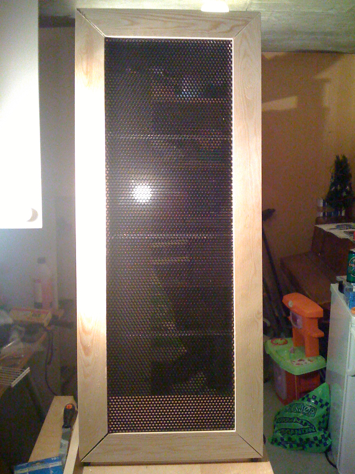

my first attemt of building an ESL is "completed" and tested..and failed.
The reciepie is as follows:
1000 X 350 X 2mm perforated, powder coated steel plates, 48% open
6my mylar, Elvamide coated
2mm plastic spacers, epoxied to stators and mylar. (Epoxy sucs, will use cyanoacrylate next time)
Power supply: EMCO G60r power module capable of 6kV
Transformer:
Test 1: 50 Va EI-transformer 2 X 115v primary 2 X 6v sec hooked up in reverse with 2x6 in parallell and 2x115 in series.
Test 2: 2 of 50 Va toroid-transformers 1 X 115v primary 2 X 6v sec hooked up in reverse with 2x6 in parallell and 2x115 in series.
Both test gave a faint sound. Measured about 25v between the stators.
Tried with polarizing voltage negative to diaphragm first, then reversed.
Same result, almost no sound.
I have no idea what could be wrong, but the dissapointment is huge!
Regard (regrets?)
bent

With such a low measured output voltage, my guess is that your secondaries are wired out of phase, so the voltages are canceling each other. Try running a test with just one of the transformers applying 6 volt input to the paralleled primaries. Then measure each of the secondaries separately and make sure you are getting ~ 100 Vac. Then hook the two secondaries in series measure the output. If you get 200 Vac or more, you have them hooked up properly, if not swap the ends of one of the secondaries.
Once you have each of the transformer secondaries putting out 200 Vac, then hook up both transformers together, secondaries in series, all the primaries in parallel. You should still be getting ~ 200 Vac from each of the transformer, and ~400Vac across both. If you get 200Vac across each, but almost nothing across both, swap the polarity on one of the set of transformer primaries.
You didn't mention it specifically, so I'll add the comment to hook one end of your HV supply to the diaphragm, and the other end to the center point of your series connected 4 secondaries.
Good Luck!

I´d think the same direction as bolserst and check if prim and sec. windings are wired correctly. If You drive just 1 primary and volume rises it´s one wrong primary, if not interchange one of the secondaries.
If its nott the tranny, the source of fail should be found around the bias-supply. A failure of the HV-Bias-supply is unlikely, but the diaphragm connection might not work, so it won´t charge up.
Hope You haven´t glued everything together? Because You can test each stator alone before putting everything together.
jauu
Calvin
Hi, I have rewired the transformers and get approx 60X voltage rise on the output.
Applying the polarizing voltage does not affect the sound level, so I guess there is a problem with charging.
Either the coating (Elvamide) or the copper foil tape used to electrically connect the diaphragm.
I wil buy a better multimeter tomorrow and see if I can measure electric contact on the diaphragm.
Bent

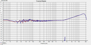

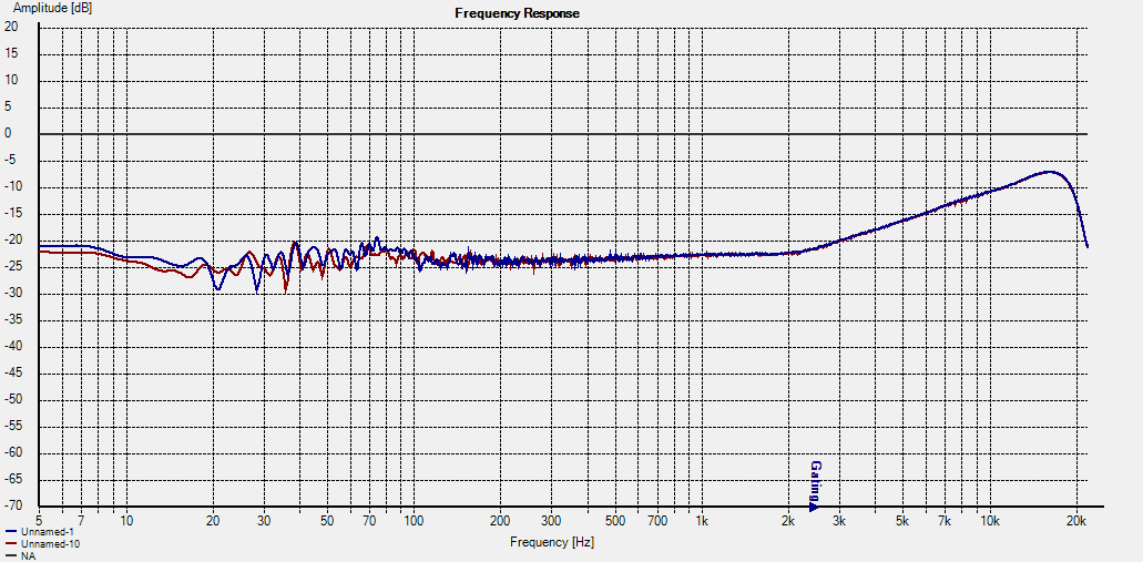

did a quick freqyency response test on the speaker that is finished.
Made with HOLMImpulse, and a Bheringer ECM 8000 microphone.
I find it srtange that re response is so flat, even if the speaker plays little bass.
And, doing a frecuency sweep from 5Hz to 20.000Hz makes the room rumble, but when playing music a bass drum sounds like a snare drum..
Strange..
Regards, Bent

How close to the speaker did you have the microphone placed when you made the measurements?
