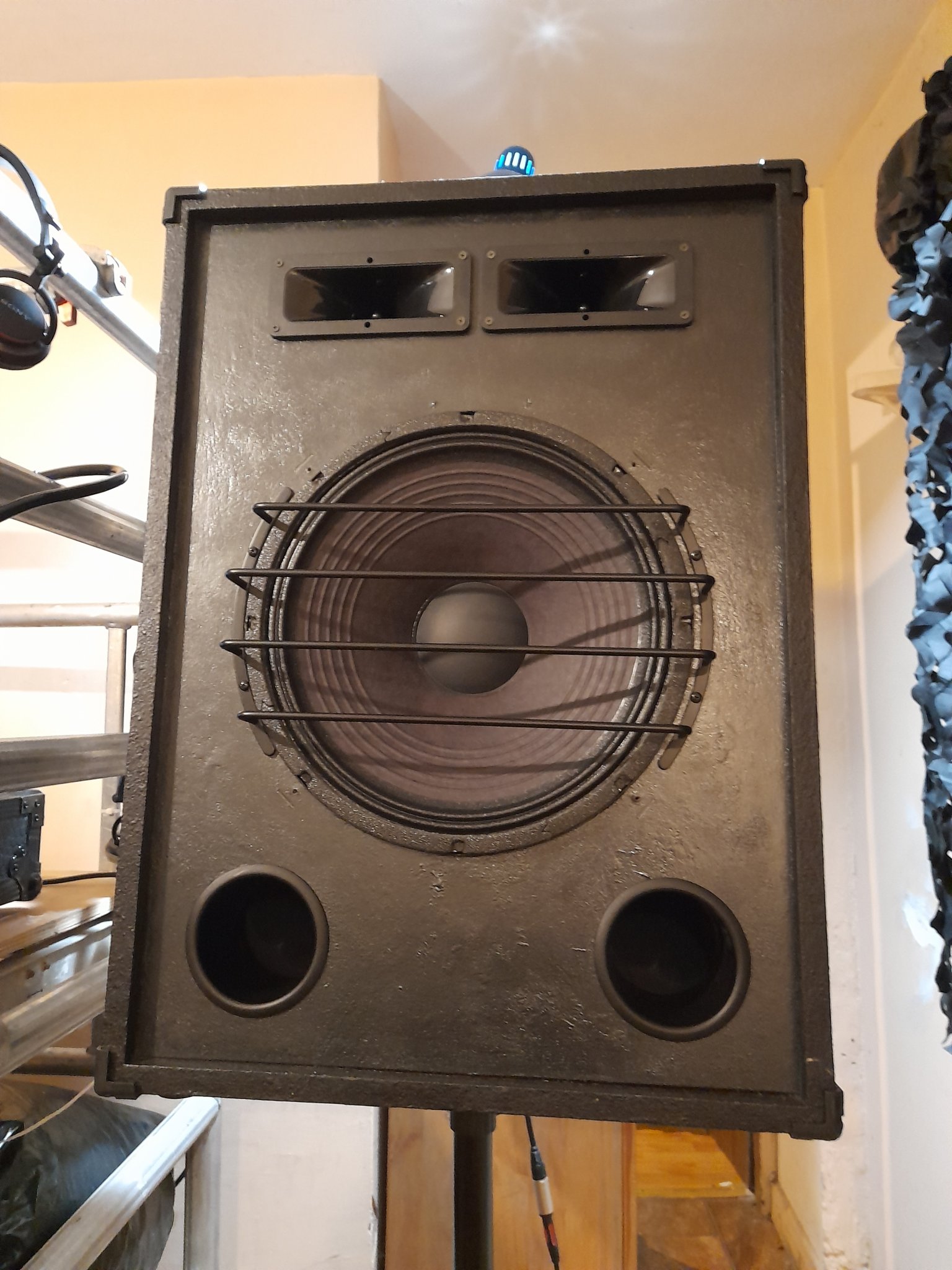

A few years ago, when I didn't really know what I was doing, I decided to build a replica of a DJ monitor I had owned in my youth.
The plans called for 150 litre enclosure housing a 15" woofer and two KSN 1025's (Yeah, I know)
So I choose an Eminence Delta-15LF-C
https://www.ltt-versand.de/en/sound...eminence-delta-15-lfc-15-speaker-500-w-4-ohms
topping out at 3200Hz and a pair of Monacor MPT-025's rolling in at 3000Hz
https://www.ltt-versand.de/en/sound...-tweeters/20312/monacor-mpt-025-piezo-tweeter
Seemed like a sensible choice at the time.

I am currently re-building this box but obviously because of the cut-outs I cannot really change the tweeters.

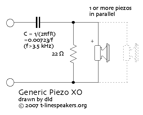

It's OK to put piezo tweeters in parallel as per the recommendations here: https://www.frugal-phile.com/piezo-XO.html
The link also describes how to attenuate the piezos.
Components for your Monacor piezos which extend down to 3 kHz:
Looking from the amp, first a 2.2 uF series crossover cap, then the 22 ohm shunt from hot to ground, then a series cap of about 0.15 uF for 6 dB attenuation.

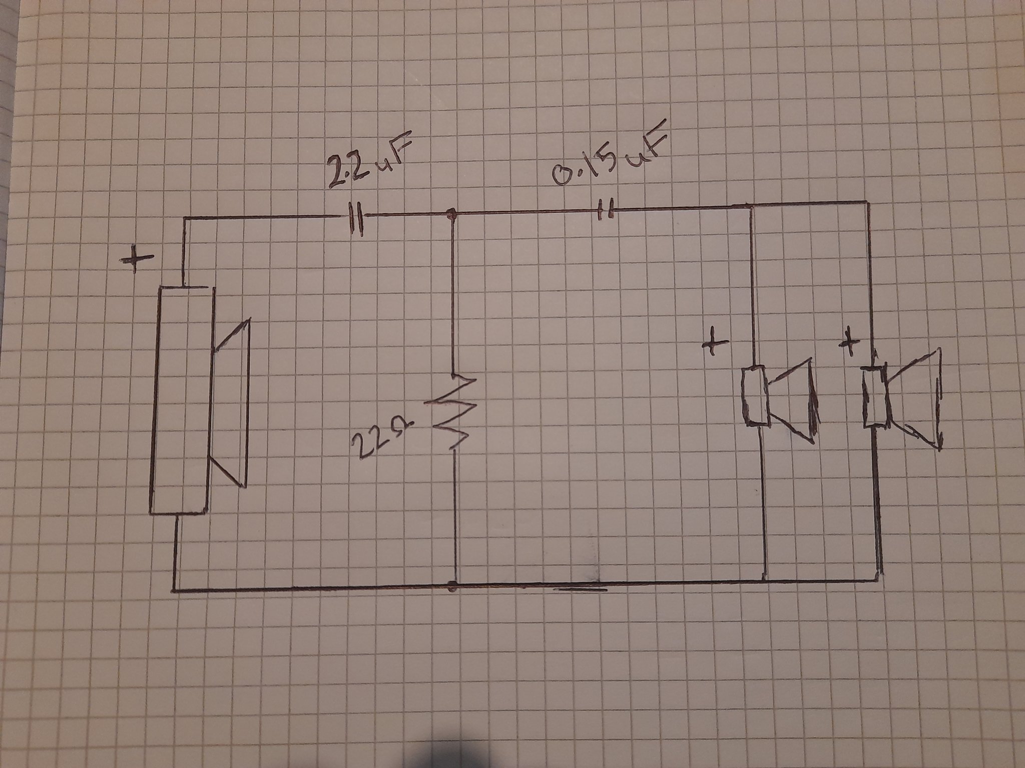

Hang on, I am sorry but I am still trying to grasp this, ugh!
My tweeters are in series..... Parallel to the cone.
So you are saying my tweeters should be both parallel.... And when you say after the amp.... Do you mean after the cone also, as in the components are between the driver and the two tweeters.
You appear to have understood correctly.
For best results the piezos should be in parallel as described in the link.
The combination shown in my image should be connected directly across the bass speaker's terminals.
Might as well just draw this...... Obviously there's an input missing..... From the bass speaker terminals ——>

There's not a large proportion of the total energy delivered to the speaker system in the high frequencies passed by the 2.2 uF capacitor.
To err on the safe side, I'd use as a minimum a 10 W ceramic wirewound resistor.

I see from the pdf that reducing the value of the 0.15 uF cap will increase the attenuation, should that be found to be necessary.
For example you could wire two 0.15 uF caps in series to get 0.075 uF and around twice the attenuation.
