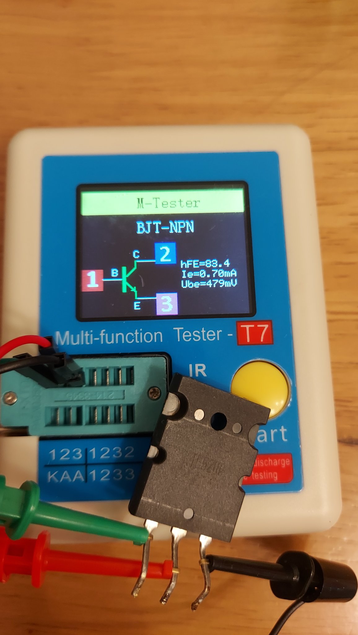

- I have my friends car amplifier and it came to me with gain potentiometer damaged and one channel was pulsing.
- Fixed the potentiometer changed 2 transistors "marked photo" and now i found that the output transistors are getting hot, slightly lower amplitude than the other channel "could be the potentiometer that i fixed ?"
- I would like some help/guidance troubleshooting the issue.
Pulled them out and they tested shorted, yes i replaced one like for like and the other i have found a suggestion by Perry Babin "D1302 with 2N3904".

Okay, so with the board mounted in the chassis / heat sink and transistors mounted, measure the drop across the emitter resistors (bias current) with no speakers connected. Also measure the DC offset for each channel (speaker output to common).
If the outputs are not mounted properly, they absolutely will go into thermal runaway.
If you measure high bias current on the "bad channel", most likely the bias circuit is damaged or needs adjustment (fixed resistors). Other faults can cause this as well. A schematic at this point might be really helpful.
Okay, all output transistors are back on the board, across emitter resistors 1.4v on the bad channel and 0.1 on the good one, no signal imput, no speakers, gain set to minimum.
At the speaker terminal i have 19.7 mV on the bad one and 0.5 mV on the good one.

Okay, so your bias or driver sections may have a problem. This can also be caused by some types of voltage amplification stage that drives the bias core. Your DC offset measurements show the voltage amp section is working, I suspect a bias circuit or driver problem. There are usually resistors between the drivers and predrivers (if those exist). If they go open or have a bad solder connection you will also have very high bias current. I would check Q107, Q108 and the bias Q109. Any open circuit in Q109 will result in high bias. It looks like you have a thermistor sensing internal case temperature as well.

I have measured as you suggested and compared the measurements to the good working channel and i could not find big differences, (probably big enough) base voltage on the output transistors was 0.570v on the "hot" channel and 0.530v on the cold one, a also measured with the amp powered (limited to 1.6Amp) on the various places like before and after resistors, diodes, capacitors and differences compared to the good channel were close (3 to 5 mV )or exactly the same.
Not understanding the circuits well enough to make changes I decided to mount the board back into the heatsink and test at full power with signal from a head unit connected to a subwoofer.
Having only one subwoofer (300w 4ohm)i tested one channel at the time and then in bridge mode, works fine on all of them decent volume and it barely warmed up.
Let it iddle with no signal or load and stays at 1.65 amps.
