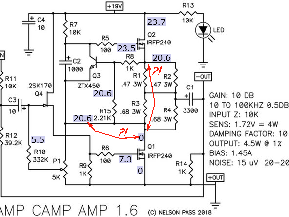

Yesterday I was checking the setting of the trimpots on my ACA (which has been working fine for a few months now since I built it) and when I finished noticed that one channel had gone silent. All the wires and solder joints look and feel solid I fear I might have shorted something with the alligator clips of the multimeter. Most likely the neighboring pole of the MOSFET Q1.There is no apparent damage to anything. I also had connected a home made headphone adapter to the speaker outputs and noticed that it turned stereo into mono so it is also an alternative posibility that it (the headphone adapter) has an internal short and shorted the amp in turn.
Where do I begin troubleshooting this? If I burned out something and can anyone suggest the most likely candidate? The mosfet? I'm really pissed at myself.

Here are the voltages of my measurements on the dead side of my ACA at the points indicated on the troubleshooting section of the ACA 1.6 build guide. Quite a few are at variance with the ranges specified in the troubleshooting image. Just for forms sake I did the measurements on the "live" side of the amp and all those were more or less in the specified ranges (only variances of a few tenths of a volt and I had not let the amp fully warm for a 1/2 hour as specified.
Q1 S= 0, D=0, G=7.3
Q2 S=20.6, D=23.7, G=23.5
Q4 D=23.7
R10= 5.5
R9=7.3
R15 B=20.6 E=20.6
R5 = 23.5
I eagerly await your diagnosis. If you need measurements from "all" points I can do that too but I got the idea from the troubleshooting section that these were the important ones.
Here are the voltages....
In context: {attached}
Two pairs of points look "impossible". The bottom of R15 is either zero or 20V?? (Or am I mis-reading?) The voltages around R1 R2 R3 R4 imply 35 Amps of current which is so not-likely. Without a look, I am wondering if you maybe burned the copper off the board? Or all four R1-R4?

@prr I double checked and there is also 20v at R3 and R4 so would the logical conclusion be that the ling to Q1 S is broken ie most likely a bad solder joint or less likely a break in the cirucuit? I think I will detach the board from the heat sink and see what I can see if you agree. Or could an internal problem in Q1 cause the 0v reading on S and D? I'm thinking not, but I'm a novice. Thanks for your help!
You also can ask your self "how would the voltage on Q1 become the numbers you have measured?"
if the black probe is on ground and you touch the red probe to it it will read 0V because they are connected directly (no parts in between). If you get the same readings at other locations it could mean they are connected directly (shorted).
My instructors drilled into us "follow the voltage" after we had verified the continuity of adjacent items. 0v on Q1 can mean it is connected to ground or it is not connected to the voltage supply
Problem solved! When I lifted the board from the heat sink and did some voltage testing I noticed that the center post (the drain) of Q1 went from 0v to 12.3v when I poked at it with the probe. I also noticed that the amount of solder was not as generous as it could be so a little touching up with the soldering iron got the juice flowing reliably. While I had it off the heatsink I also trimmed a few wire stems that were a little over long on the bottom side of the board and may have presented a danger of touching the heat sink when mounted.
So in summary what I think happened was that the solder joint on the drain pin of Q1 was good enough to make the amp work for 3 months but when I checked the balance by attaching an alligator clip to that pin it jarred it enough to break the connection.
Eureka, the sweet music is flowing again! Thank you @PRR, @Nelson Pass, @Signal Lost and @kevinkr!!!
