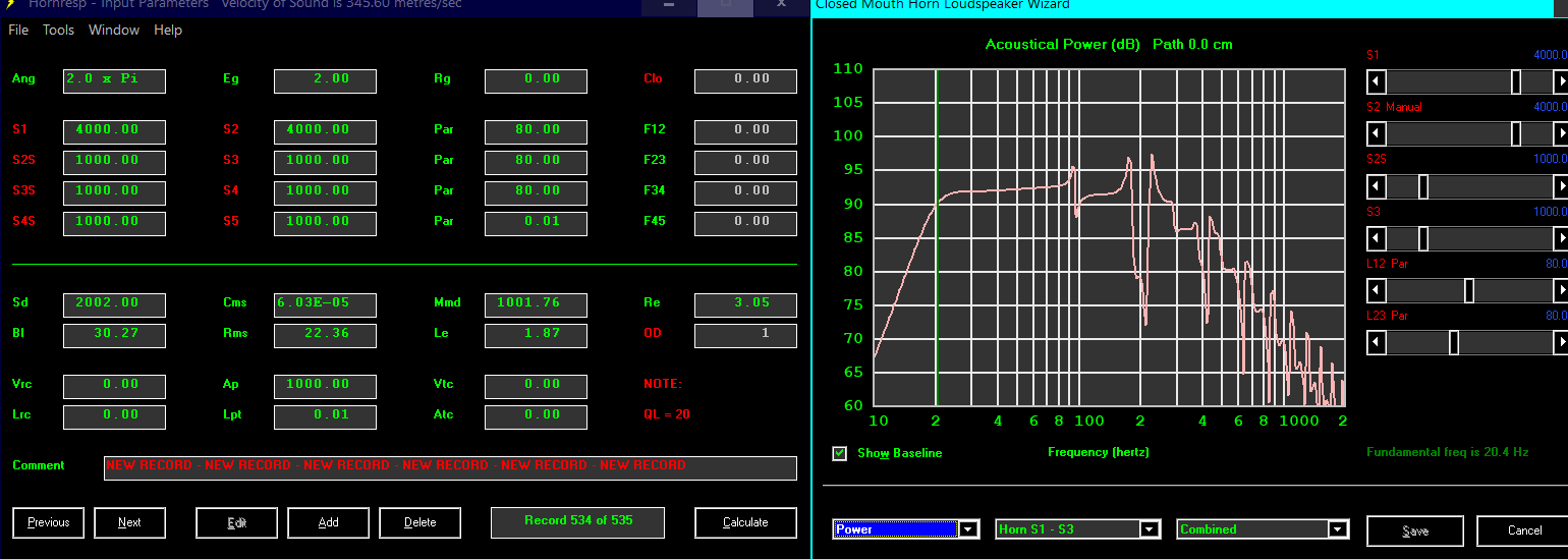

Stick it in a generic 48” folded qw pipe(long, skinny bass reflex) with a closed end @ 2 x Sd ——> 1/2 Sd @ the exit end (it’s like 20 hz)? Dunno what good a big infrasonic sub is to PA?
4000cm2 x 120 cm
1000cm2 x 120cm
4000cm2 x 120 cm
1000cm2 x 120cm
Yeah, Qt specs dictate a ~ Vb = Vas, Fb = Fs alignment, so not for a typical PA app unless it's a fairly large cinema.
