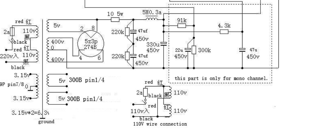

I would like to improve my CLC PSU for this 300b set amp, which with some modifications is really really better.
I see that many builders implement PIO or film caps in the PSU, many others shunt electrolytics with films (which is quite debated), my question would be, in which position, and with what values should here PIOs or film caps go in?
I see the first reservoir cap before the choke would be a nice place, with around 30uF.
Now rectifier tube is a 83, mercury vapor.
Then what else?
Being the last cap in the AC signal path, should I add one PP or PIO cap paralleling that 330uF?

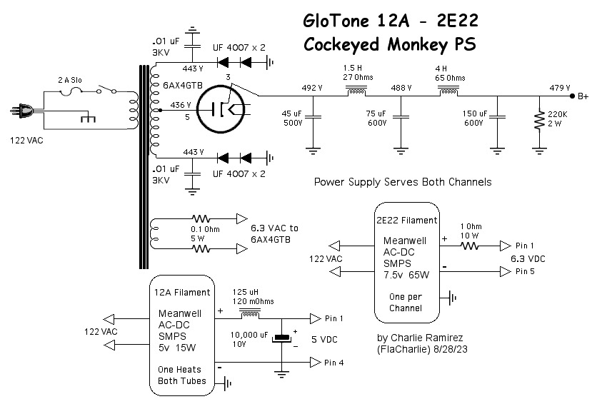

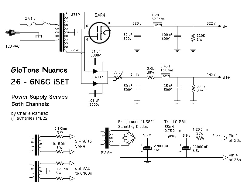

Thank you for your thorough answer, would youimd putting a couple schematics, just B+, of your builds?
Sure, here are the PS schematics. Nothing too unusual in terms of the caps themselves, just using DC Links instead of electrolytics. The power supplies are a bit different than most, though.Thank you for your thorough answer, would youimd putting a couple schematics, just B+, of your builds?
The Nuance uses a split supply, part tube rectified, part SS. The tube section uses a 5AR4 to provide slow startup to the outputs. The SS part supplies the inputs. It was necessary because I used a voltage regulator tube to supply the inputs and I needed it to start up quickly. Startup was inconsistent when it was supplied by the 5AR4. I did use electrolytics in the heater supply to the 26s but the rest are all DC Links.
The power supply for the Cockeyed Monkey is also a bit unusual. It's a "cockeyed bridge" which is essentially SS but it uses an inexpensive 6AX4GTB damper diode to provide a slow start.
Here are links to the build threads if you're interested in more info:
https://www.audiokarma.org/forums/index.php?threads/the-nuance-my-inverted-set-diy-project.990205/
https://www.audiokarma.org/forums/i...ckeyed-monkey-a-directly-coupled-set.1040847/
