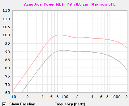

Best to use a TL (basic HR sim is from another 'no-name' 6.5" = ~ 66" L x 6.5" W x 4.5" D (i.d.) with a 23" driver offset stuffed to 'taste' (31.65 L of polyfil) and experiment with port/ceiling spacing for best overall performance (1.0pi), max power = 6-7 W/Xmax

Correct, the sim shows it's uniformly stuffed full length.Thanks @GM

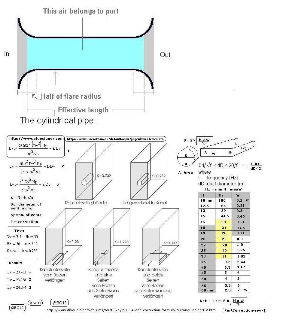

Well, basic pipe end correction for a 1.0 pi space is k = 1.728r, so the pipe's acoustical length = build length + its radius ((4.5+6.5)*2)/pi/2 = 3.5"*1.728 = 6", so in theory at < ~6" it will increasingly load its terminus/'vent', ergo to benefit from ceiling load requires a longer TL based on where the driver is located vertically on the wall.
Ah, I see, so it seems that we'd have some extra theory to account for the distance from the terminus to where the wall and ceiling meet. Knowing what little I know about ports, I'd assume a smaller gap would require a longer port - is that correct?ergo to benefit from ceiling load requires a longer TL based on where the driver is located vertically on the wall.
Then the terminus will need to be > its area to keep tuning within the driver's range making it a crude BL/MLhorn, so 'go for the gusto'? ('70s era Schlitz beer commercial) 😉

??? Understood; a crude BL/MLhorn can be one where the TL is much longer, allowing a much larger vent area along its length and if to the ceiling it gets a 1pi space loading for a significant gain BW Vs just a pipe vent.
Oh I see! So rather than a vent that looks like a slot, it's a rectangular hole, which would point forward to 'fire the sound' across the ceiling?
