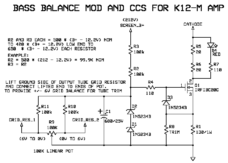

I am thinking of building a small toroid OPT tube amplifier using a bridged tube output, so the toroid just hangs in the middle of two class A/A2 totem-poles. I suspect for best results a Circlotron may be the answer but I quite fancied a dual SRPP arrangement with dual triodes, for simplicity.
I know I could use a capacitor, but I fancied eliminating those!
I guess you can use toroids in push-pull too? You just need an indicator of DC current balance.
I mean something like this
Current source idea
I see. I'd modify that myself;- if the wiper loses contact you get full conduction, I'd arrange it so that a dodgy wiper makes it more negative to switch off the tubes..
