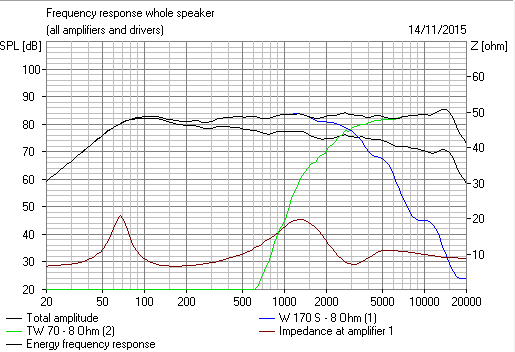

i.e., tilting down as you go up in frequency. Take for example the frequency response of Wesayso's towers and Mitchba's speaker - they both arrived at same tilt which sounds more pleasing.
I could talk about a lot of things tonight, like bafflestep and power loss at crossover with even order filters.
But let's talk about the legendary BBC dip. AKA rolloff at higher frequencies.
In fact Doctor Earl Geddes explained it in a simple way that stuck in my mind and ensured I wasted no more time on it. High dispersion tweeters, like domes, need a BBC dip. Lower dispersion tweeters like cone types appreciate a little lift.
It's to do with power response. Which is what you hear in the far field or off axis of a speaker. So with my cone tweeters, I lift them. With domes, I drop them. Seemples. 🙂
