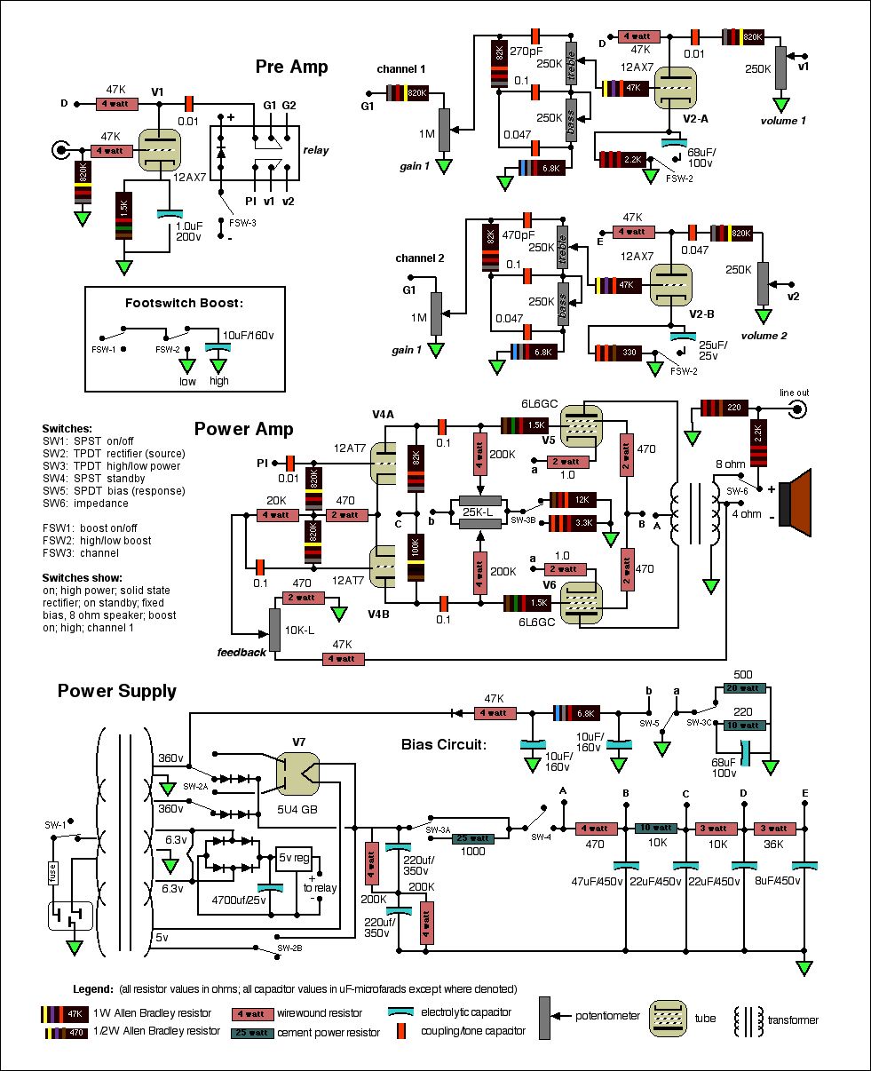

My amp I built pops quite loudly when I turn the power switch off. I've read to eliminate that put a cap across the switch. I did that, a 0.01uF 600v and no change.
Any suggestions?

And as a power switch bypass, .01 uf @ 600 v is not enough voltage. Refrigerators and air conditioners can put 1000 v spikes on western power lines. Old TV's always had 1000 v rated caps, and that is what I installed in my ST70 and PAS2 tube amps. I got the idea from old Sam's photofacts schematics, decades before the internet. If you believe your supplier might lie on his cap voltage ratings, you might buy UL rated caps which are rated for the power supply they go on- typically 200 to 300 Vac for US market appliances. I believe they are described as x2 or y1 caps or something, although I am vague which rating you would use for a power off switch. The .01 uf @ 1000v cleaned up the turn off pop on my dynaco equipment, and the only failure in 35 years both vaporized the cap and arced over the turned off power switch, so I call that a lightning strike (particularly based on the weather that day).

Osvaldo, What about a MOV? I looked it up on Wikipedia and it seems to be the closest thing to what I am trying to achieve. But there is no mention of them in the application I am looking for.
Indianajo, you don't have to answer this if you are in bed... But, about the 0.01uf 1000v cap that worked for your Dynaco: Is the higher voltage rating the reason my 600v does not help? And, I don't think the X or Y type caps are what I want unless I can find info on them keeping the pop from being so loud. They are described as RF and EMF suppressors, so I don't know how they would work to eliminate the loud pop when you turn off a guitar amp.
I am finding really hard to believe I am the only one who has asked this question and there are no definitive answers for it, other than turn the standby switch off first?? I am not willing to settle for a solution that is not really a solution unless it just can't be done. If that is the case please state that.

Your guitar amp probably has a gain of 5 to 20 anyway, so 50 mv that gets to the input stage will cause your speaker to pop. My dynaco hifi had a gain of 50 in the preamp and another 10 in the power amp. You want a capacitor because they have resistance that gets lower and lower as the frequency goes up, and pop is a high frequency sound.
The capacitor acts like a short for high frequencies, the resistance is 1/sqrt((2*pi*frequency*C)^2) so the higher the frequency the lower the impedance (resistance). I put my .01 @ 1000 v right across the power switch in my dynaco PAS2. Some other people put a .047 uf or something across the input winding of a power transformer, to do sort of the same thing. You might try this with a non-x2 or non-y cap, just to see what value you want to buy in an x2. No pop, that is the right value. Then buy an X2 that value, or a Y if that is more correct. After reading wikipedia, I like the idea of a flameproof coating on the cap (in the UL rated ones). You may be in less trouble by getting the x versus y wrong, although lawyers can make a million off of any mistake.
