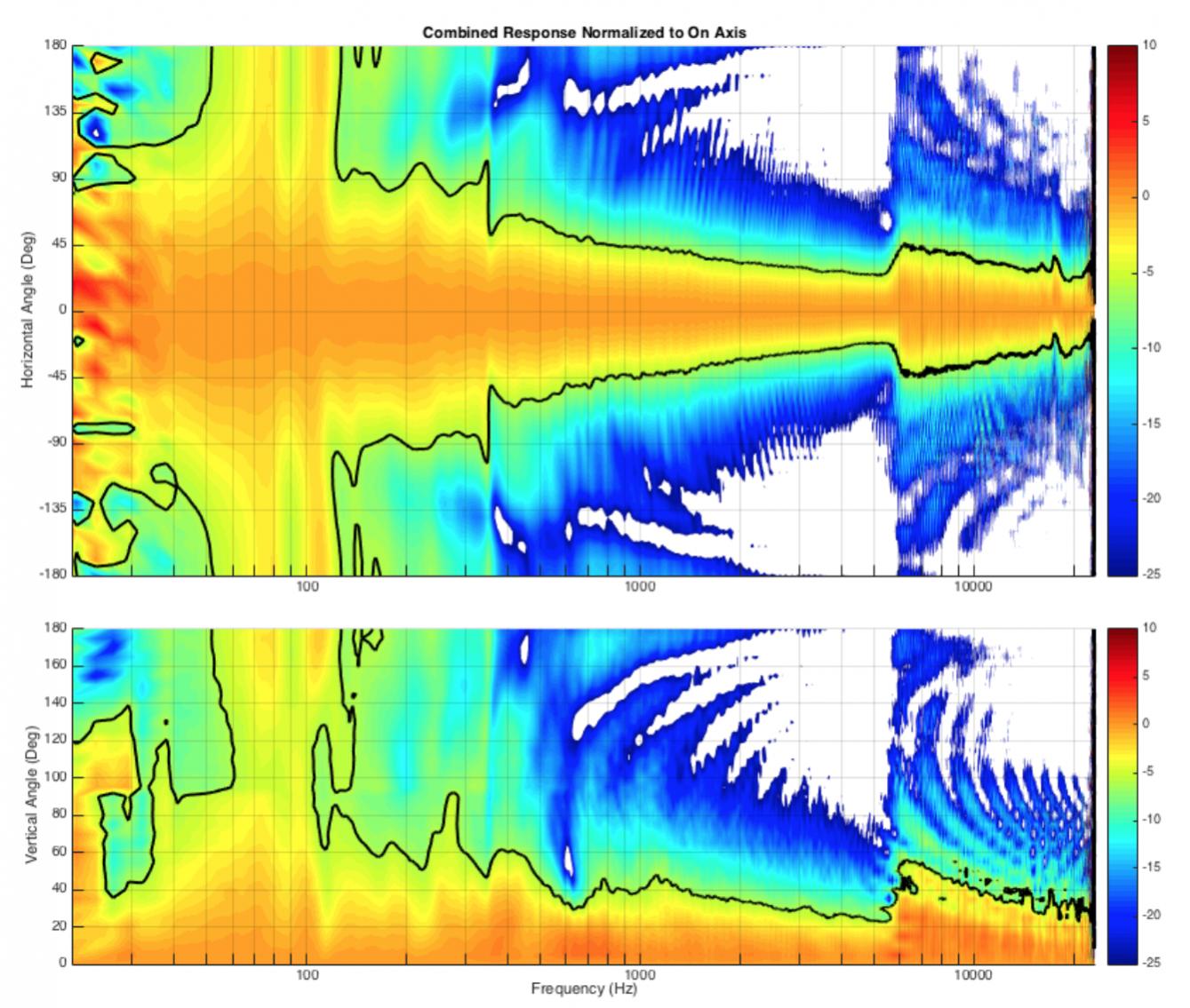

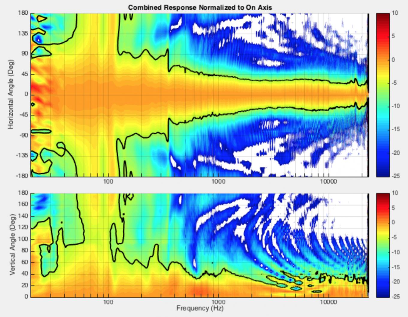

This is not entirely correct. The complete polar response can be effected by the crossover and drivers chosen (both horizontal and vertical). For example, I have a vertical array of drivers, and I can make the horizontal polars wildly different around the crossover point through the crossover design I choose. Below are polar maps for a low order crossover on the left and a high order crossover on the right with the same drivers and physical arrangement.
John,This is not entirely correct. The complete polar response can be effected by the crossover and drivers chosen (both horizontal and vertical). For example, I have a vertical array of drivers, and I can make the horizontal polars wildly different around the crossover point through the crossover design I choose. Below are polar maps for a low order crossover on the left and a high order crossover on the right with the same drivers and physical arrangement.
For the case you present, at least on axis, it appears I was entirely wrong 😱.
Your polar map shows the combination of a woofer narrowing in it's upper range combined with a tweeter widening in it's lower range, when the two are combined on axis using a low order order crossover the overlap results in dispersion averaged between the two native dispersion patterns.
Does the horizontal averaging of the driver's response with the low order crossover remain the same when off axis in the vertical domain?
In other words, if you measure the horizontal polars 20 degrees off axis vertically up or down, is the average still the same, or does it reflect the native dispersion pattern of the woofer and tweeter?
Art
Art,

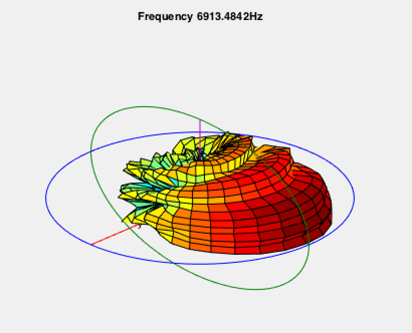

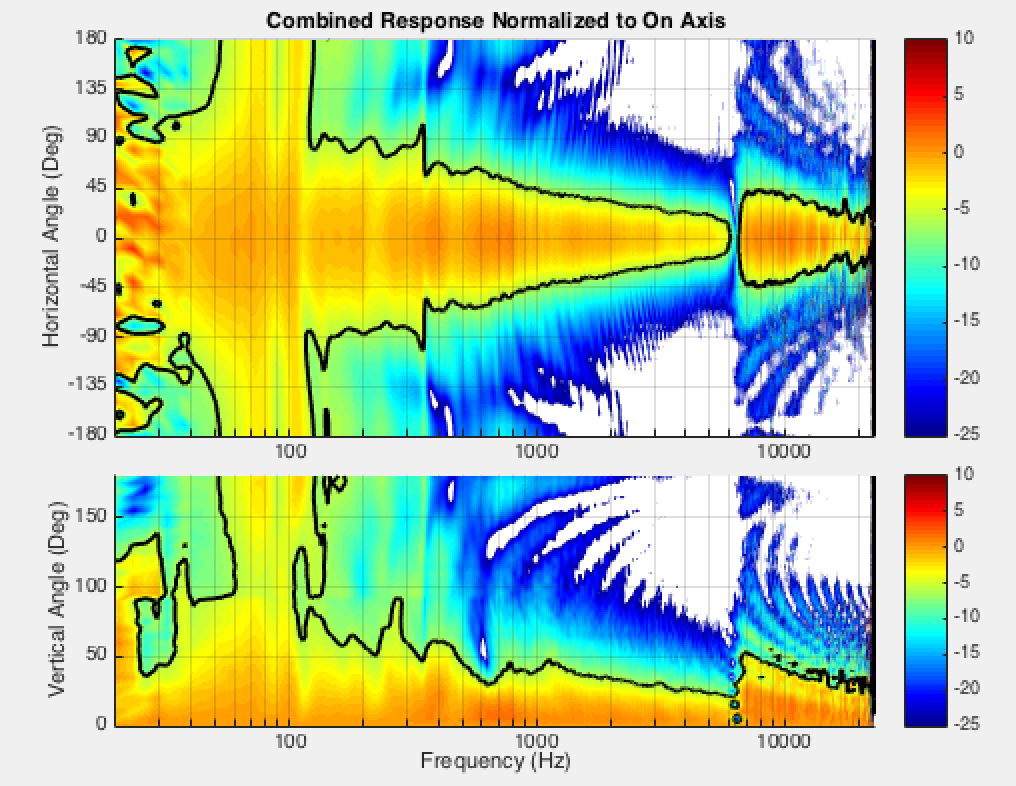

My example is a 15" woofer, big midrange horn, and small horn tweeter. If I look at the same data at 20 degrees up (but still normalized to zero degrees), I get the polar maps below - the horizontal looks about the same except you see a dip from the vertical comb filtering around crossover - what you're seeing in the vertical polar map. I also included a balloon plot to help better visualize what's going on. The left two are the high order crossover, right is the low order.
In John's examples xo point appears to be exceptionally high - around 6kHz. This addresses how important it is to set xo point (F) and type in a way that gives smoothest response on and off-axis!

I measured 703 points, although 54 of them were duplicates (back and top points). I have an automated setup so I just let it do it's thing.
Oh, man, I'm jealous! I get hinky after getting ten or fifteen points.😀
How is the automated system set up? Is the speaker moved or the mike? Or both?
jcx - that looks amazing! I've been wanting to get full 3d polars but haven't looked into it much yet. John, is that what you have to work with?
