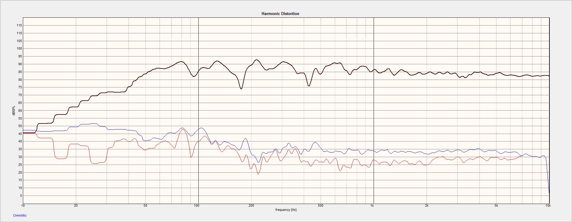

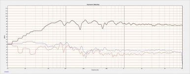

I also did some distortion measurements at around 1 Watt. If you are interested, here you go!
OmniMic's distortion plot may not accurately reflect dB of distortion, but above 500Hz distortion is less than 0.35%
