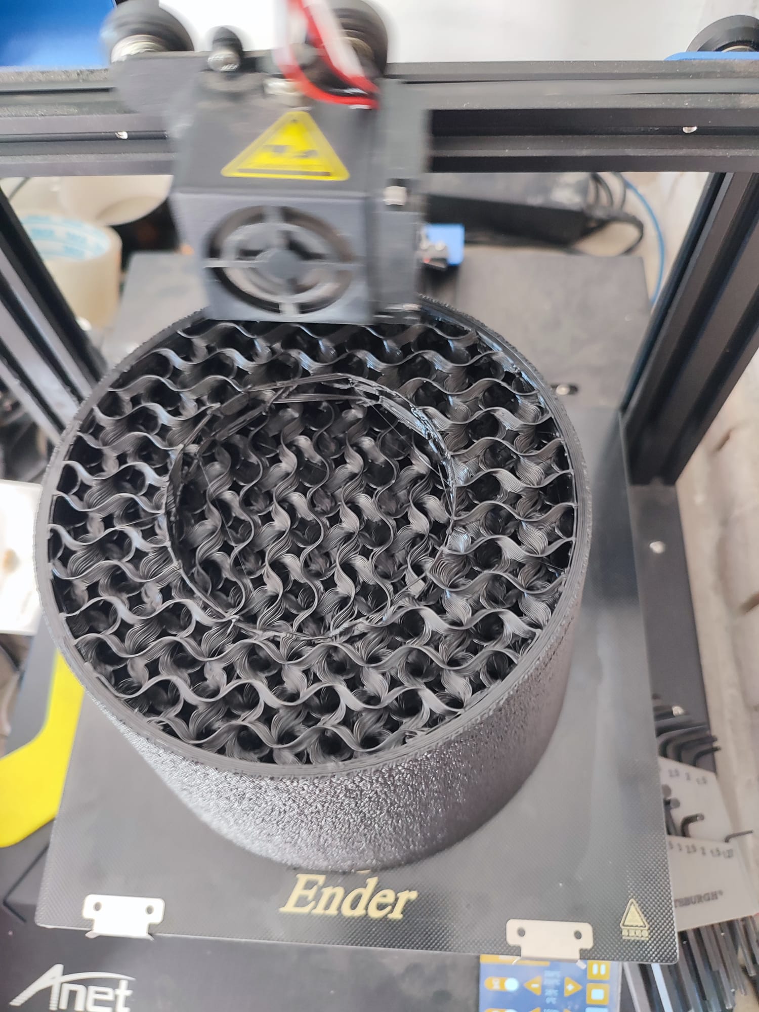

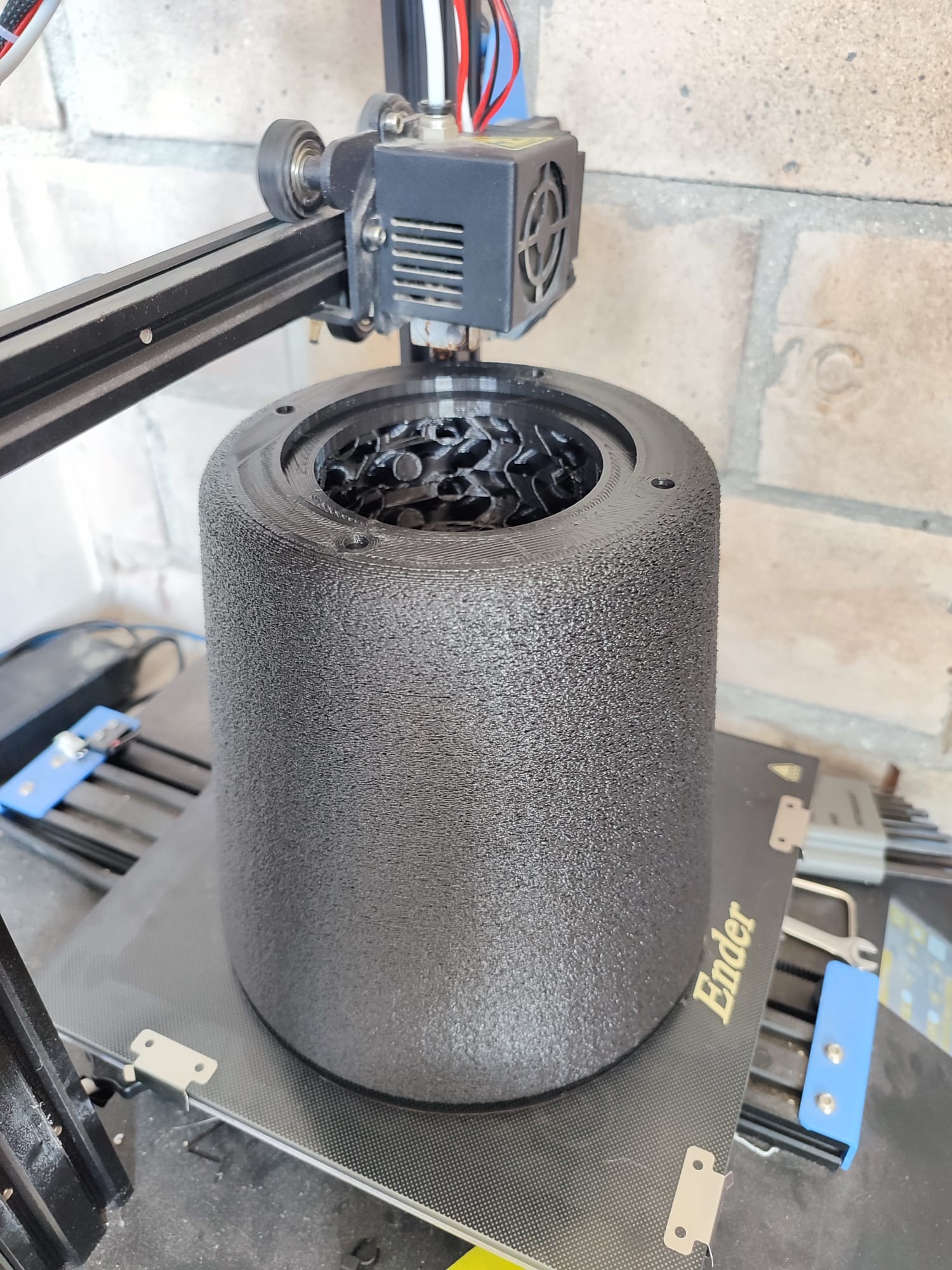

Inspired by Isaac Moore's speaker concept on reddit using the gyroid infill as damping and locking, I have designed my own desktop 3d printed omnidirectional speakers. I would like to hear the Duevel Planets, but as I live in South America it's not that easy to have access to high end listening rooms.
Configuration used for the printing:
0.6mm nozzle
0.8mm wall x 4 (3.2mm total wall)
8% Gyroid infill
10 botton and top layers (2mm)
Fuzzy skin to finish
The printing time was about 25 hours per cabinet, and there's no extra damping material inside, only the gyroid infill which acts as infill as well as interlocking the structure. I can feel a little vibration from the walls when I really crank up the volume, but this does not happens on listening levels.

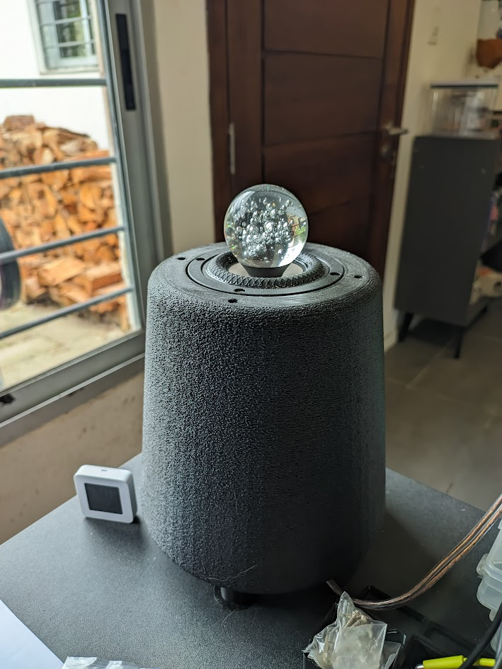

It's a bass reflex design, using the Tangband W3-2141 driver in an upfiring position, the port is downfirering and designed with the speaker, flanged in both ends and tuned to 70Hz. After a lot of 3D printed diffuser designs, this is the one that worked for me and it's a glass ball used in pet water fountains on a prited support that rests on the original fixed driver's phase plug.

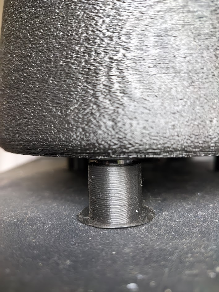

I like what the omnidirectional design can do with the soundstage, the speakers really desapears. There's another one on the right side of the desk, nearfield listening as my ears are like 80cm from the speakers all the time in a 30º angle from the top. I have also designed and printed the magnetic levitating feed, using the repulsion of 2 magnet as isolators. This really helps to keep my desk from vibrating:

That's the coolest use of 3D printing I've ever seen. The magnets are a clever idea however, I wonder about the use of a magnet spring in the vertical (up-down) axis where the sound is also being generated in the same axis. I think a rubber or oil damper (not a spring) would work better. Since you are really clever maybe you could design a copper damper?

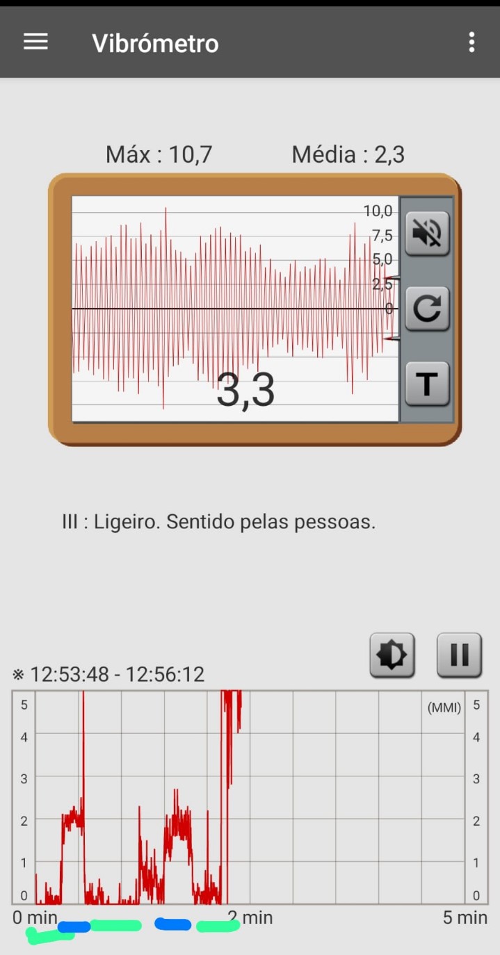

Thanks Arthur! What I really like about this forum is that you guys always take an idea and take it to the next level! I was also worried about loosing some dynamics and SPL by decoupling the speaker from the desk using this "spring" system, so I have conducted some subjective + objective tests, searching for the best cost/benefit solution for my case.That's the coolest use of 3D printing I've ever seen. The magnets are a clever idea however, I wonder about the use of a magnet spring in the vertical (up-down) axis where the sound is also being generated in the same axis. I think a rubber or oil damper (not a spring) would work better. Since you are really clever maybe you could design a copper damper?
As my desk is a common office desk with metal feet with a less than desired stiffness, when listening to the speakers directly coupled to the desk using 3 spikes, I got really strong vibrations at 150Hz and it's harmonics (75, 300, etc) using a swipe tone. This was really annoying and every light weight object over the desk as pens , keyboard and other things we keep around would rattle and amplify this. Using the magnetic springs has decreased the vibration on my desk as the graph below, reaching 2 to 3 (blue marks) on this scale to around 0.2 to 0.4 (green marks) when the magnets were active as I shifted from one state to the other just pushing down the speakes with my hands, so the upper feet gets coupled to the down feet:
The audible difference for me was negligible as I didn't perceived any lacks in dynamics or upper bass impact (the main difference was the absence of rattling things and the desk vibration itself when the magnets were working!).
The magnetic decouplers are around 2cm diameter and 2.2 to 2.5 cm high, using magnet neodymium cylinders of 10mm x ø5mm , and I'm thinking about the use of magnetic dampers with copper plates would require a much larger plate. Using a coil would keep the system with the same height, now trying figuring it out how to fit a coil on the upper section that may provide this damping effect and increase the stability of the system improving the general dynamics of it.
