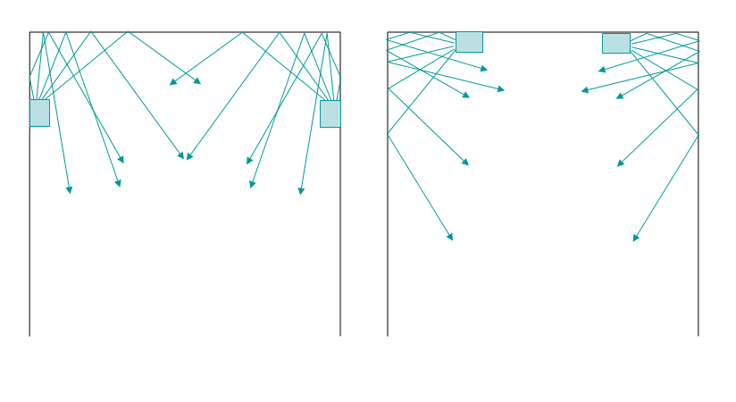

How about a line array flooder on the wall?
Top view:
Yeah, I actually thought of that (the second example)
Just making it 1 unit with 2 channels firing sideways and using the side walls for reflections. I am definitely going to use the mini-ambio unit on this.
I will post a drawing of what I mean.
Thanx for your interest. And for the drawings.
Top view:
Hey CLS......
The only concern that I have with flooders is a theoretical one.
And that is.....if a driver is beaming towards a wall and we hear only reflected sound instead of direct at high frequencies, there would be a huge time gap between those reflected frequencies and the direct frequencies of the omni frequencies that are wrapping around the baffle and hitting our ears first.
I guess it would be like having the tweeter 2 meters behind the midrange on a conventional speaker! No?
Theoretically, yes. Or it seems pretty much that way by first intuition.
But interestingly, I don't feel that way in my system (very reflective living room).
I've tried up-firing tweeters on top of TV (about 1.2m high), on equipment shelf (0.5m high), and finally on floor. They all give an open and smooth HF response everywhere in the room.
And of course, compared with direct firing tweeters (aiming listener), perception level of up-firing tweeter is lower. So proper EQ might probably be necessary.
Another way to see this, there's a guy in the forum has had some measurements of his radical system with side-firing mid-high units. I remember the step response is nearly perfect.
