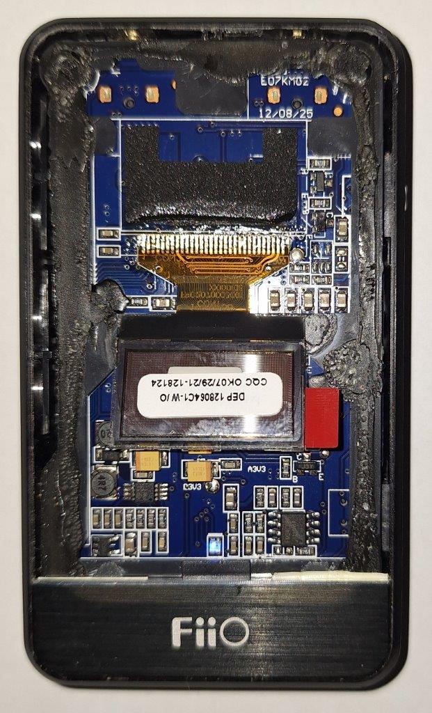

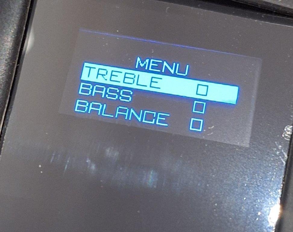

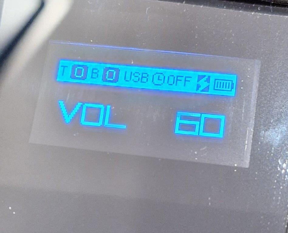

The FiiO E07K ANDES is a DAC and headphone amplifier. There is a lot of information about it. Their problem is this OLED screen, which is failing. The original screen (MCOT128064N2Z-YBM) is hard to find and costs a lot. I decided to repair mine. I found a compatible screen (DEP128064C1-W), cheap, I replaced it and it works perfectly. It is not yellow-blue on a black background, but white on a black background, All menus and information are correctly displayed.
The screen is glued with double-sided adhesive foil, it is removed quite easily by heating with hot air. Soldering the 30-contact tape is easy, with a thin tip.
All the best!
