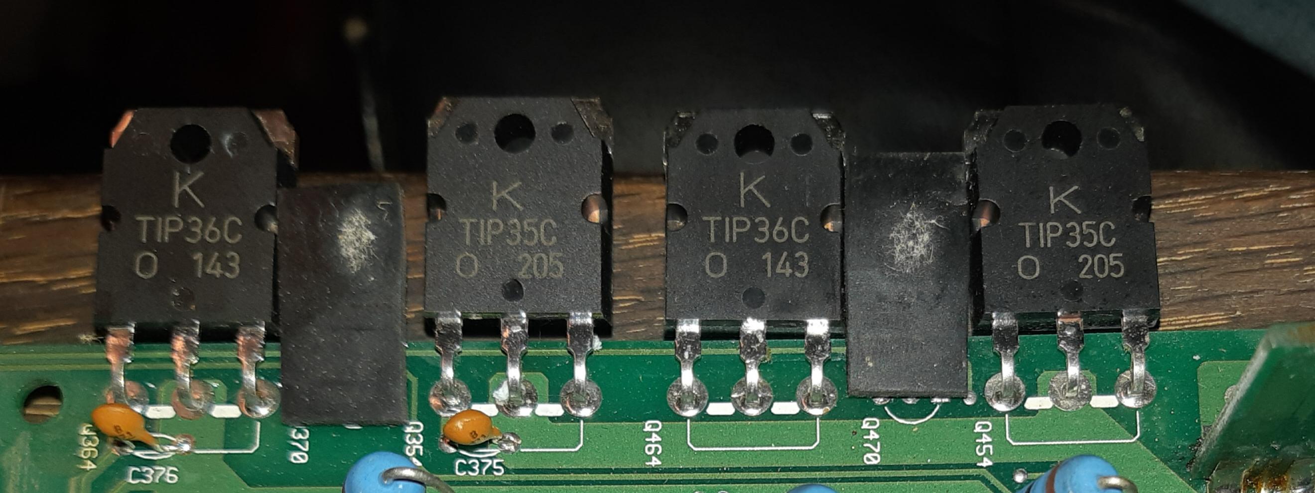

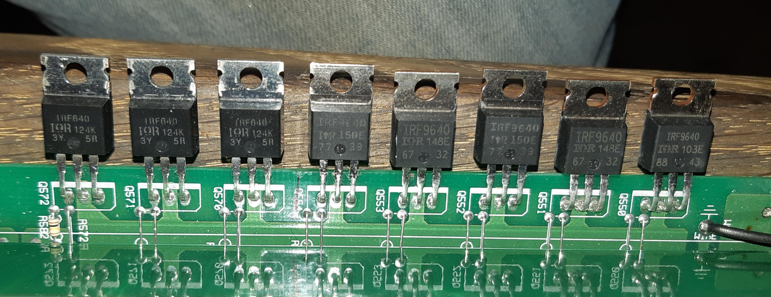

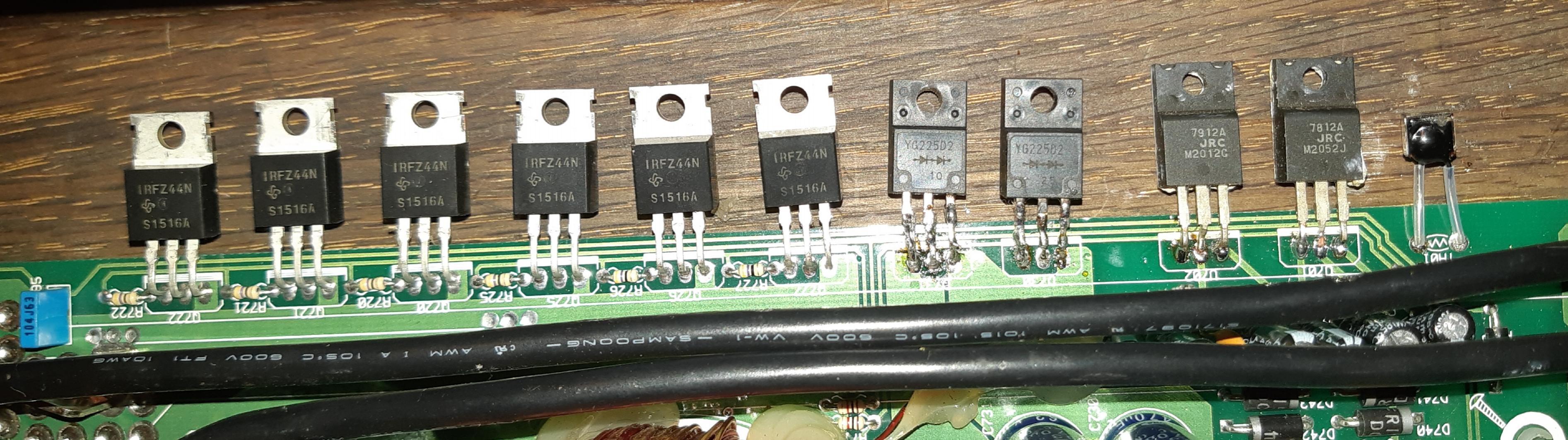

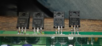

Hi all, I picked up a viper 1100.5 5ch amp,its pretty old but is very clean. Put some power to it and it goes into protect mode and stays that way. So I opened it up and can see that somebody had done some work on it in the past. It seems some devices were replaced and I wanted to make sure that they used the right parts or at least equivalent ones. So my question is would anyone have a schematic or maybe some pics of the board that I could compare with. Thanks in advance

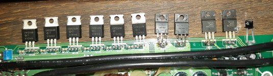

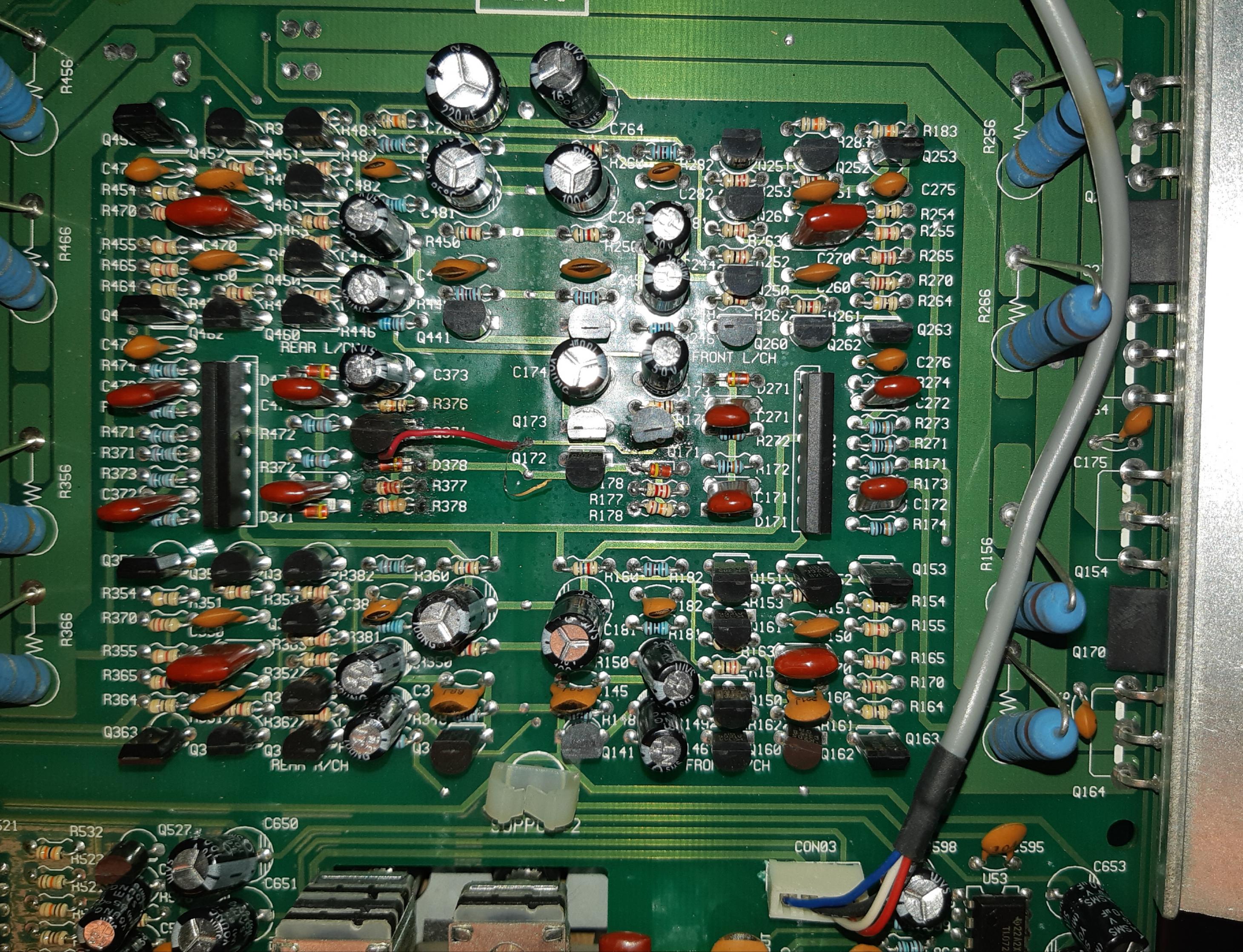

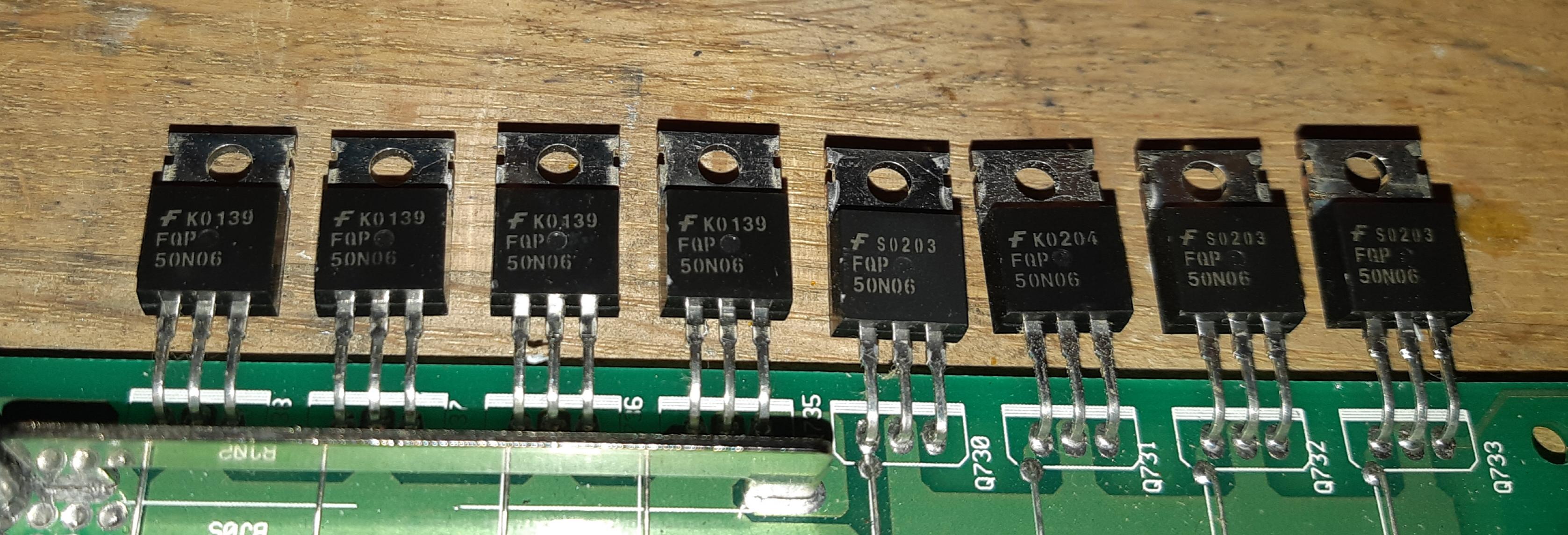

Hi Perry, thanks for the response. Here are the pics

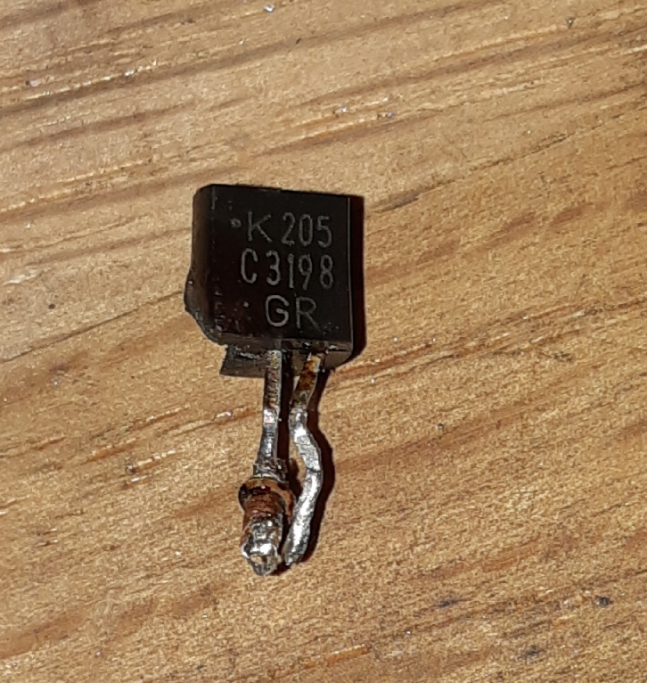

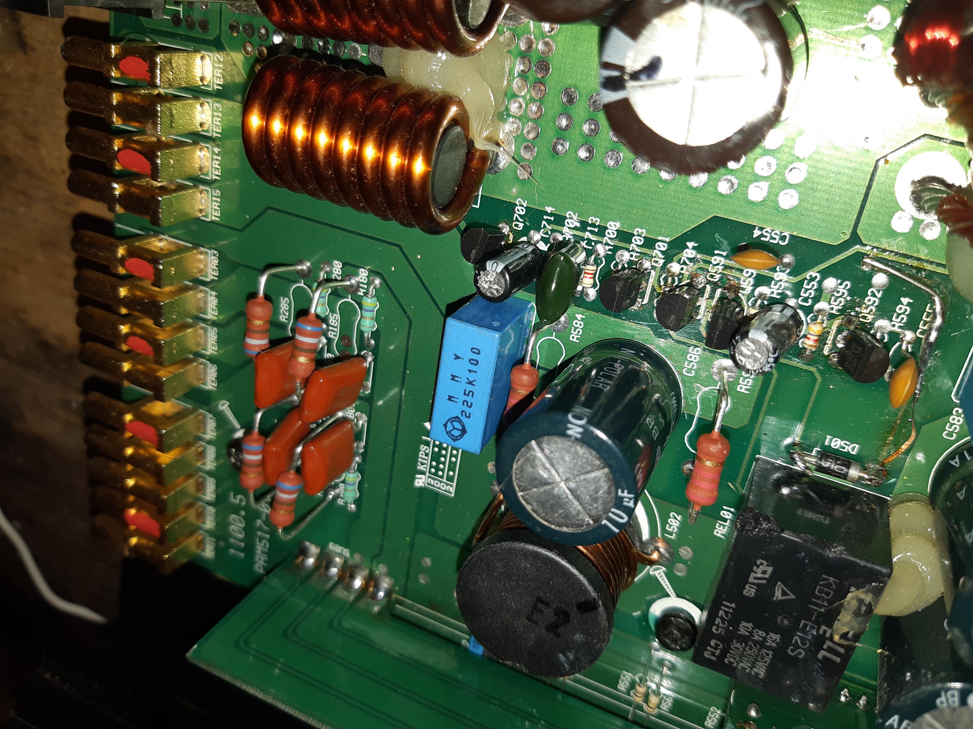

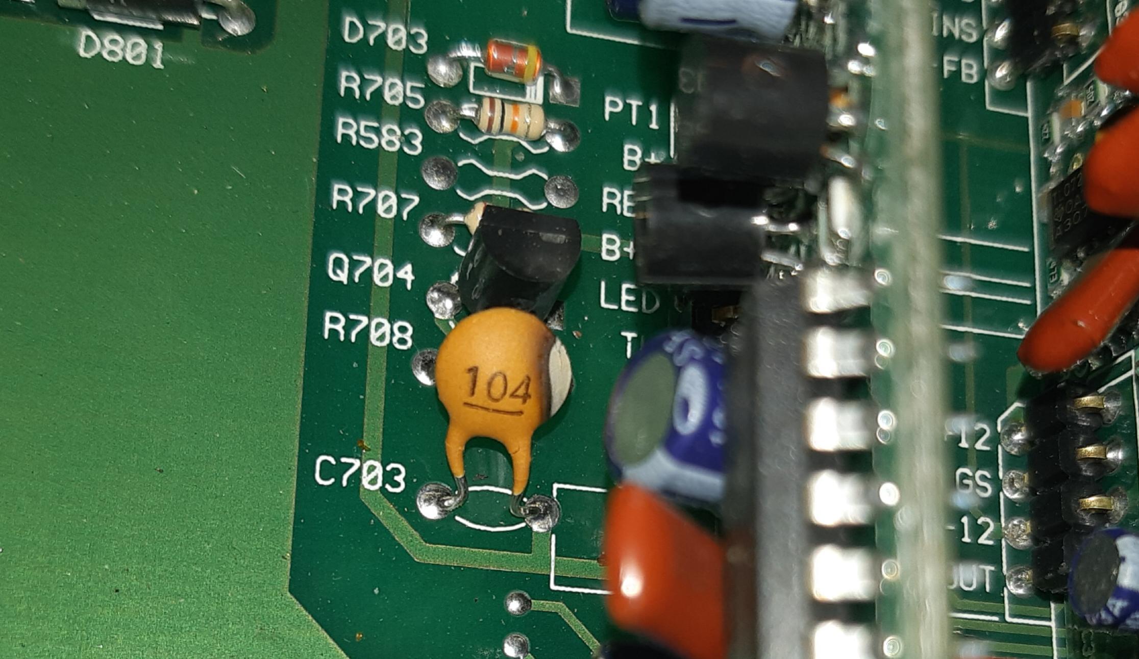

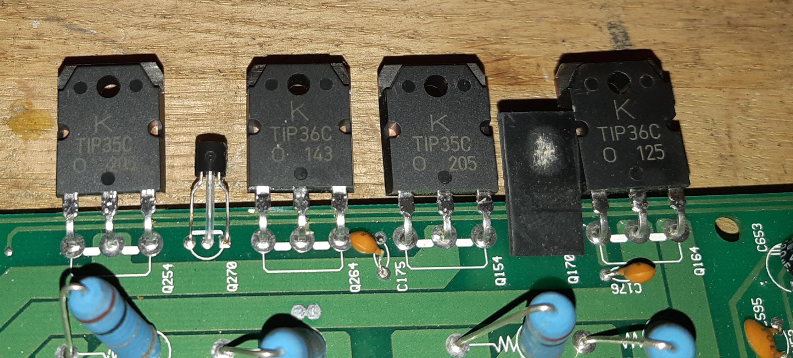

Ok I'll give it a shot,also I wanted to mention that when I opened up the amp I found a transistor that one of its legs burnt off and blew a hole through the transistor,it was labeled C3918GR,I've since replaced it and repaired the burnt trace it was attached to. In a different location I found a ceramic capacitor that was also cooked. One leg of the cap was attached to the same trace as the burnt leg of the transistor. I replaced the cap and put power to the amp,still in protect. That's as far as I got so far,but I'm sure that I'll need help on this one haha. I'll post some more pics asap
Here are the pics,I forgot to mention that I also found a 10uf 200v non polarized cap that was bulged,hard to see in the pic but it is definitely bulged and not sure what to replace it with as I cant find anything similar on digikey. The 4th pic is of the area I found the burnt transistor,you can see the red wire I used the repair the trace going to the transistor I replaced it with.
