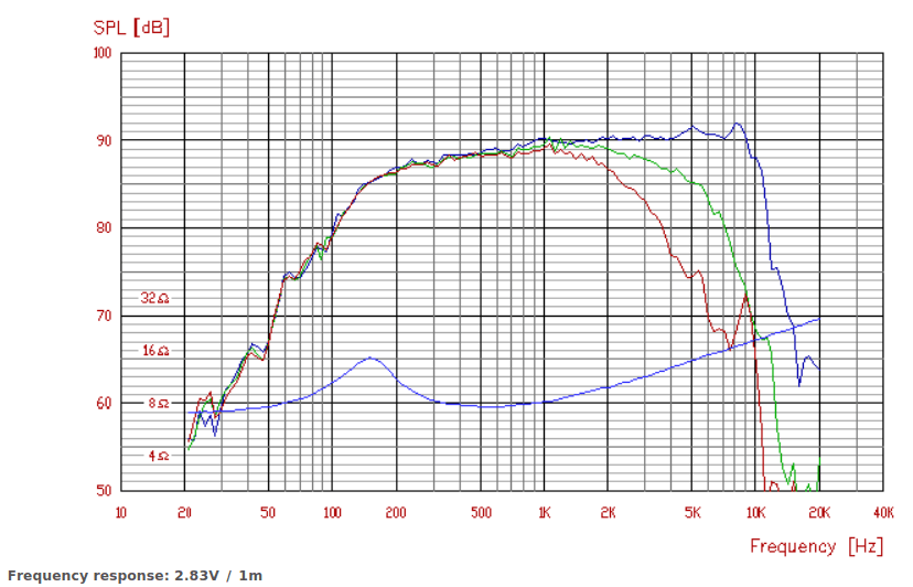

Ye Gods! Those are legendary polycone basses and mids! Vifa made amazingly flat drivers back in the day. Eveyone is amazed Vifa STOPPED making them!
The Vifa P13MH-00-08 mid (below) and P13WH-00-08 midbass were a crossover builders dream. There was a much admired P18 too.
The tweeter is your usual SEAS 27TDFC quality soft dome:
https://www.seas.no/index.php?optio...fc&catid=45:seas-prestige-tweeters&Itemid=462
Since you have disassembled the cabinet, and time is tight, I would take the drivers and crossovers with you. Someone in the States might appreciate the cabinets. But you will lose a lot with less than a classic two cubic foot reflex cabinet.
