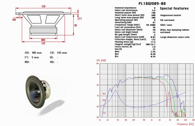

I started this project a long time ago (10+ years) but I had no time and interest to really finish it off. It consist of a tweeter D25AG-35-06 and woofer PL18WO-08-09. Box is vented floor stand of 23 liters. My intention was to build a decent DIY speaker. However, I never finished the filter design properly and it has sounded quite bad for over 10 years now. I thought I might do something about it and my conclusions is that a 4th order Linkwitz-riley crossed at 1600 Hz will be a good start.

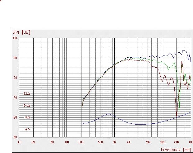

But, there is a problem. I can not find any data for the D25AG-36-06 tweeter on internet! Every datasheet is lacking important parameter data and there is no FRD or ZMA to be find either. I was thinking of getting a D27TG dome instead since it might fit the woofer better and there is a lot of data available. Does anyone have a clue where to find data for the D25AG tweeter?? I know it's very old, from 1992 or something, but it is popular for DIY project so there must be data somewhere.

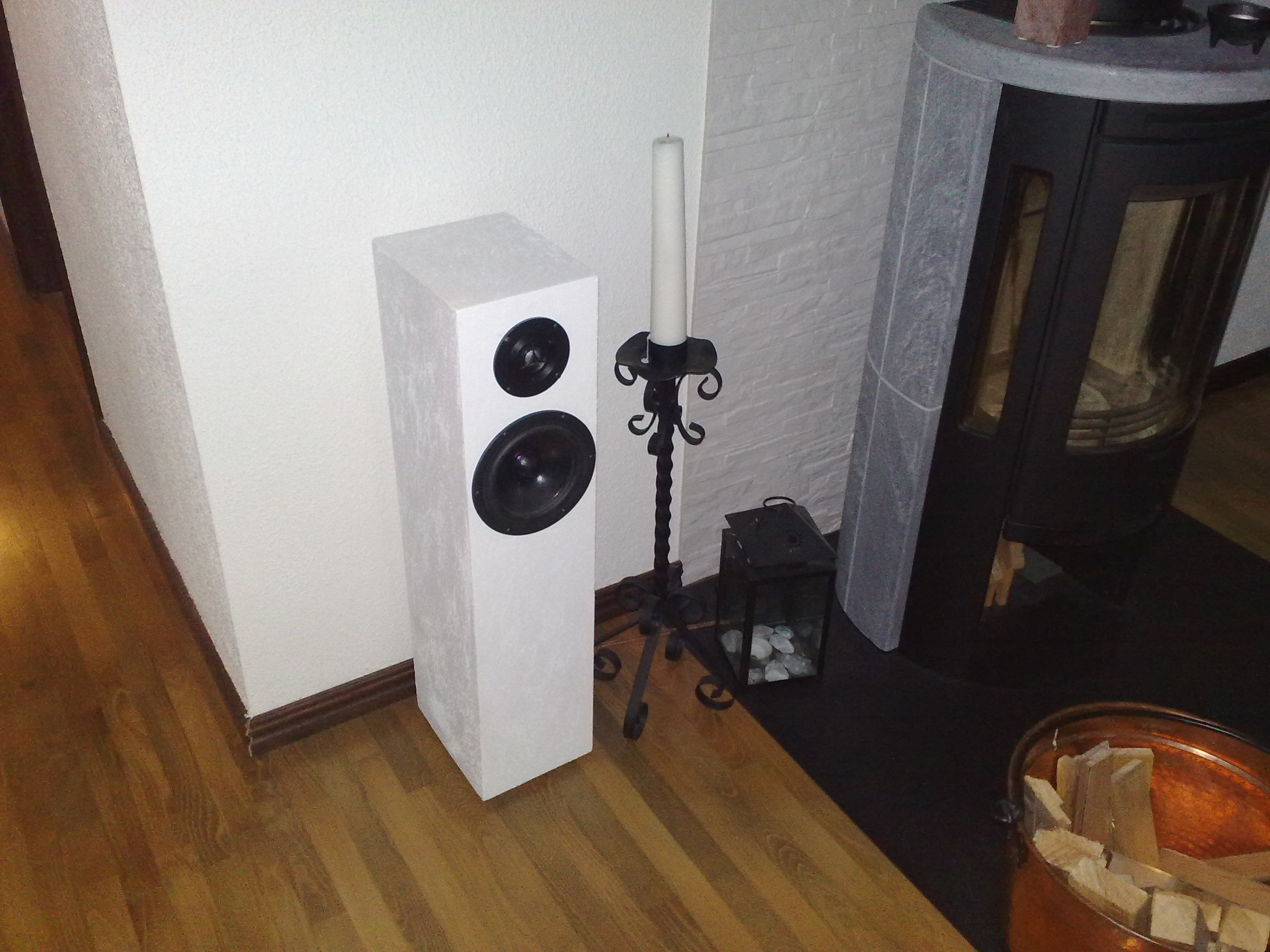

Here is what they look like now..
/Fredrik

Yes 4K 2nd order is not going to be good with the breakup on that woofer (if it is the graph that Steve posted)! A notch filter on the woofer somewhere between 3 and 4k probably would be a good idea (even if you go with a low 4th order crossover).
Looking at the graph for the tweeter I think you would really be pushing it crossing over below 2Khz.... a second order electrical around 2K is probably going to give you your 4th order acoustic slope. You may need to go 3rd order electrical on the woofer to get phase to match up.
If you are going to work with this tweeter and woofer I'd try for 2Khz and put a notch on the woofer. The notch may be tricky though as it is a fairly wide peak.

Interesting that you guys have crossed this tweeter so low! The fact it is already well and truly rolling off at this frequency would make me think that you would not be able to use more than 2nd order electrical on it (unless you are doing something like 6th order acoustic)
