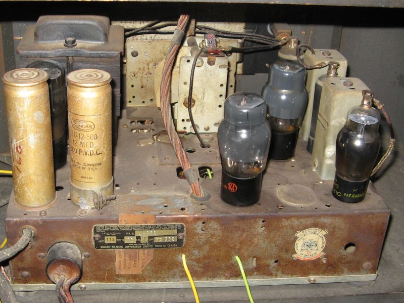

Look what me and my wife we bought at a garage sale this past weekend. We got it for just the price of the wood furniture that just need a little work to look gorgeous. My wife likes to restore old furniture, her father use to build wood furniture, so it runs in the family.
The guy said the radio was working but couldn't make it work really. He said it is from 1936. His dad was the original owner. It was only making background noise. But at least it was telling me that the supply, audio amplifier and full range speaker were probably Ok.
It is an AM, Short wave receiver all tube. Using a 5Y3 rectifier supply. All tube filaments lights up. The dial indicator window is just perfect, as well the multi-turn rope dialing mechanism. The control knobs are in wood 😱 The gold fabric covering the speaker is also perfect.
Model: Rogers Majestic 7B 732, S/N: A5288
Tubes complement:
5Y3 - Rectifier + 2 X 12uF, 500V caps
6F6C (2X): Beam Pentode (Audio Amp I guest)
Radio section:
6A7M: PentaGrid Converter
6K7M: Triple-Grid Super-Control Amplifier
6B6G: Dual-Diode Triode (Possibly modulation detector)
and a nice Tuning-Eye 6X6
It has a very nice full range, high efficiency. speaker.
I would like to restore it, and install it in my listening room. I can always use my HP8640 RF generator to modulate in AM feeds by my computer and iTune music 😎
Problem may well be only corroded tube socket, out-of-value carbon resistor, drifted capacitor.
Any help, typical schematic, etc from experience radio guru would be appreciated

Ah! Tube Radios
The most problematic thing on old radios, that have set for a long time (Besides the OLD WET style of Electrolytic Capacitors drying out) is that the mica capacitors in the IF Transformers like to get brittle and the plates of the capacitors, inside the IF Cans like to short .
Thus the tuned circuit of the IF Can is no nonger a tuned circuit.
The Primary Winding of the IF Can is wired in a series between the B+ and the Plate of the IF Amplifier Tube.
The Secondary Winding of the IF Transformer feeds the Grid of the following Tube and its bottm part of the winding is often receiving an AGC Gain Control Voltage from the AM Detector Tube Ckt.
Also, the Tuning Capacitor in the Front end will often grow crud between its meshing plates which will short out the Local Oscillator tuned Ckt and the Loop Antenna winding (AM Band).

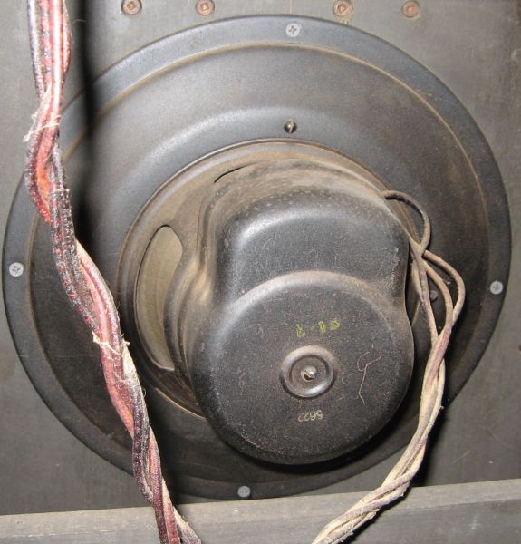

It appears that the Speaker is an Electro Magnet type of loudspeaker (?) .
That type of speaker passes the output of the Power Supply's lightly filtered DC through the Electromagnet Coil (not the voice coil) and uses it as part of a Filter Choke for the Power Supply.
Whatever hum was unable to be filtered out, is reverse phased by passing the lightly filtered dc through the Electro magnet on the speaker and thus canceling the hum in the audio output ckt of the radio---a neat approach!
This method requires no brute force filtering of the Power Supply to yield a hum free (almost) audio.

Frank is right about the IF cans,and the little mica caps. Those can be a pain.
That type of speaker is also known as a "field coil speaker",IIRC.
Replace the old caps and resistors,and give it a tune-up..should be a Nice radio!

Edit :: one more thing ... you'll find when you remove the speaker to check it out, that it's actually quite small. Most of it is a steel dish that it mounts onto. The steel dish is about 12" diameter and that is what screws to the soundboard.

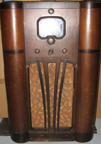

By the way I paid 100$ for it. I taught it was a very fair price. One of the two dial light is still operational. I can get a replacement one easily for the other one.
Any suggestion for the furniture cabinet restoration? My wife was expecting to remove the old, scratched varnish, then put some new one. We will match the different colors. We will keep the central section where the dial window is intact because it has the frequency bands switch lettering on it and some nice wood finish.
Naturally, I'll remove all electronics from the frame before proceeding.
Any danger to damage the dial lettering if using varnish remover fluid on the other parts of the frame, maybe because of the chemical vapors?

Well, I guess congratulations are in order - a nice set for about 1/2 of what it should go for and a free, working 6X6 eye tube to boot - ya' did good eh!!
Here's a link to the service manual:
Service manual pages - Majestic 7M732
cheers eh?
ps : the finish is toned lacquer - the cabinet is not stained, as far as I know just the lacquer is toned - you "might" be able to repair the scratches by reflowing the lacquer with lacquer thinners instead of stripping, masking and respraying.
cheers eh?
