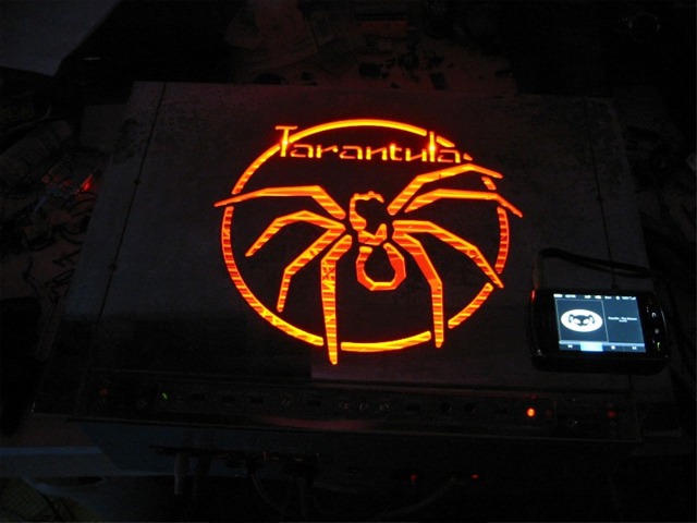

The first generation Tarantula was the limited edition one with the spider cut out in the top of the case. I believe that they originally came with red neon. You can buy CCFL lights to replace them. I bought a bunch from Newegg a long time ago, price was reasonable. If you replace it with CCFL lights, use the inverter that comes with the lights, don't use the one that came with the amp.
Most times I have seen the first generation monoblock refered to as the LE Tarantula, or the Tarantula 2kW. The soundstream website used to have the manual available for download, I believe it was listed as Tarantula 2kW on there.
Later,
Jason
**Edit** Attached a pic of one of mine

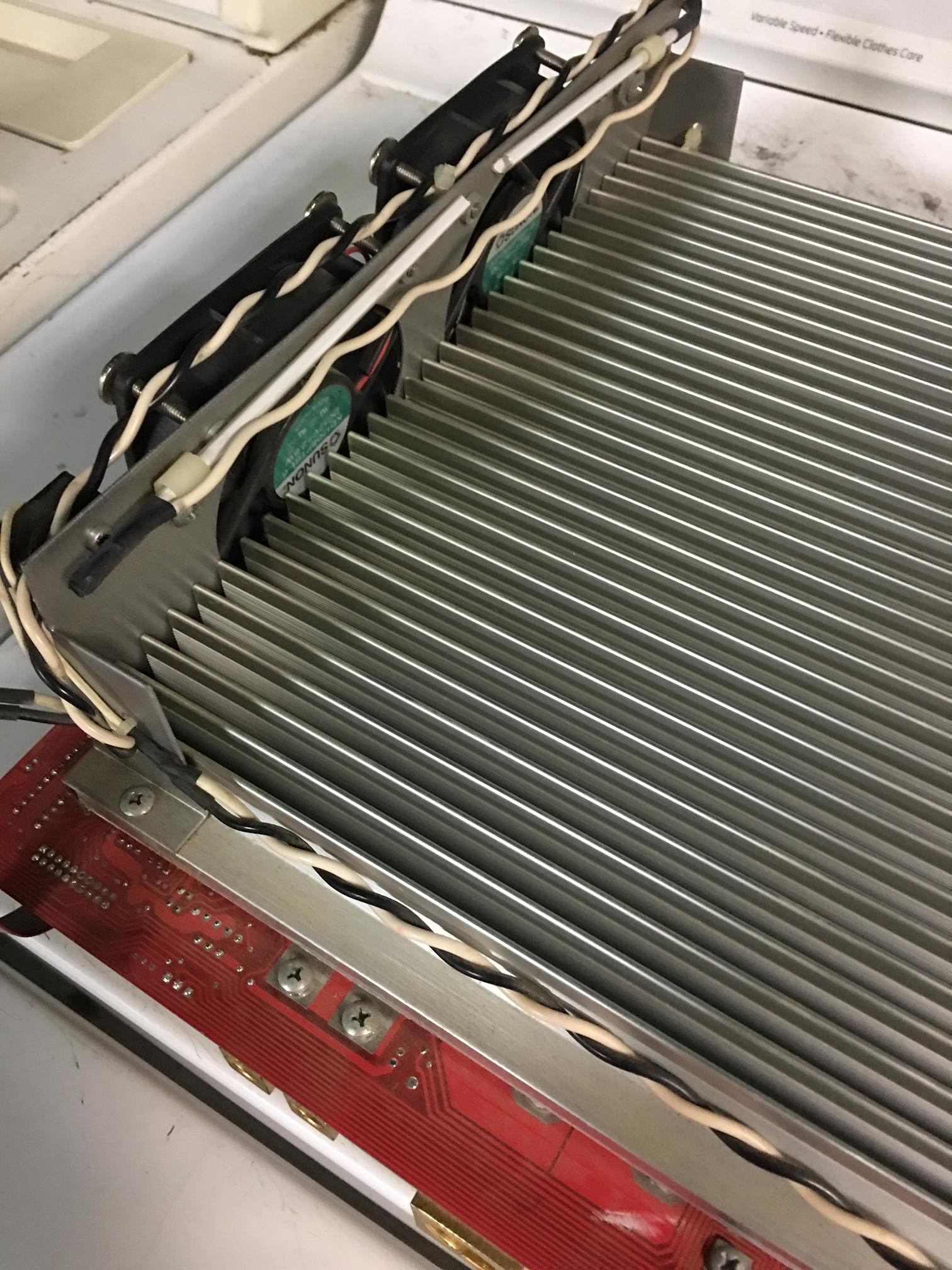

Sorry been very busy..
Here are some pics of the internals..
Wondering if led's are the way to go to replace the broken neon tubes and if so what value resistors would i need if i find a 12volt source inside the amp and run the led's off 12 volts ?

One thing to consider is the acceptable dimming for the LEDs. The 12v source feeding the amp isn't going to be constant. Running LEDs in series requires fewer LEDs but the larger number of LEDs in series will increase the dimming.

Red, https://www.newegg.com/Product/Product.aspx?Item=N82E16800888027
Blue, https://www.newegg.com/Product/Product.aspx?Item=N82E16811994001
UV, https://www.newegg.com/Product/Product.aspx?Item=N82E16800888040
White, https://www.newegg.com/Product/Product.aspx?Item=9SIA9PV3ZB3657
Green (but may be to long), https://www.newegg.com/Product/Product.aspx?Item=N82E16800888072
None of them are very expensive. They inverter is 12V supply, they are about perfect for these uses...
