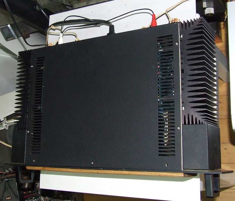

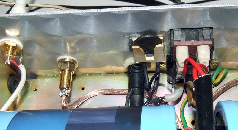

case - found in another room

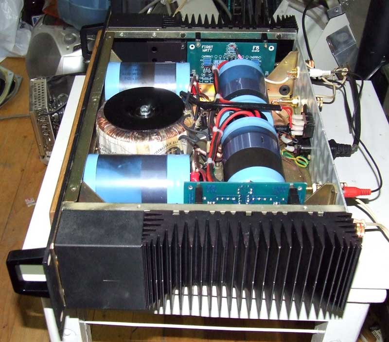

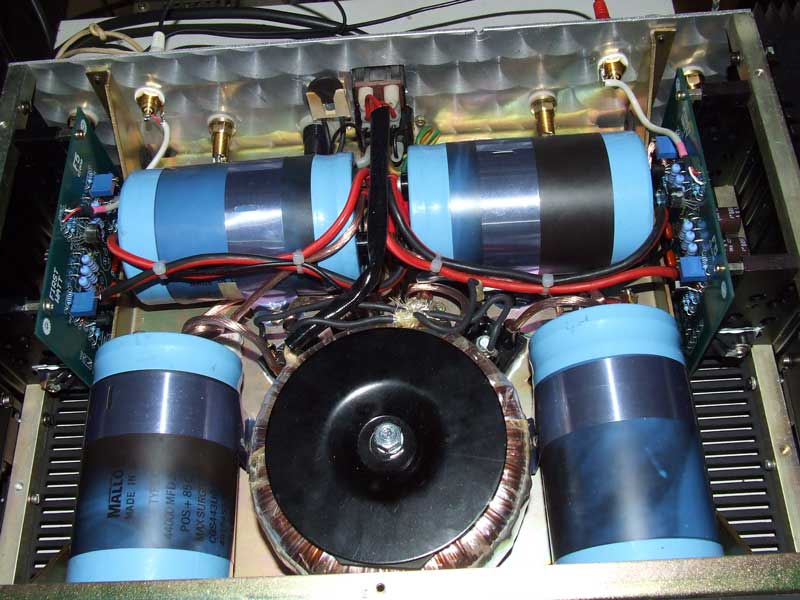

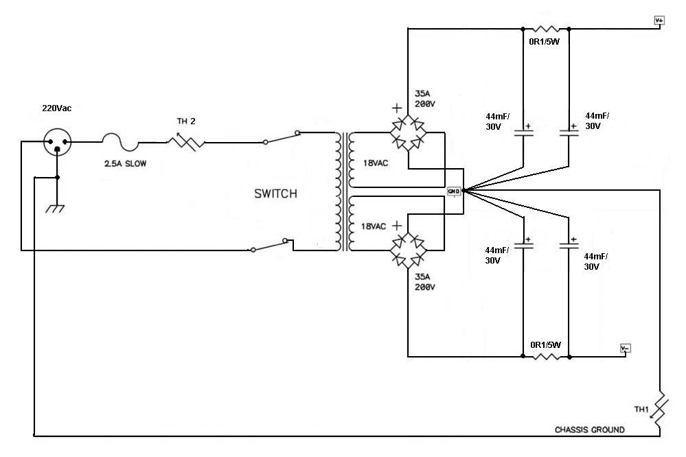

caps - 44.000/30 Mallory
donut - 2x18Vac/350VA
graetzs- generic 35A/400V

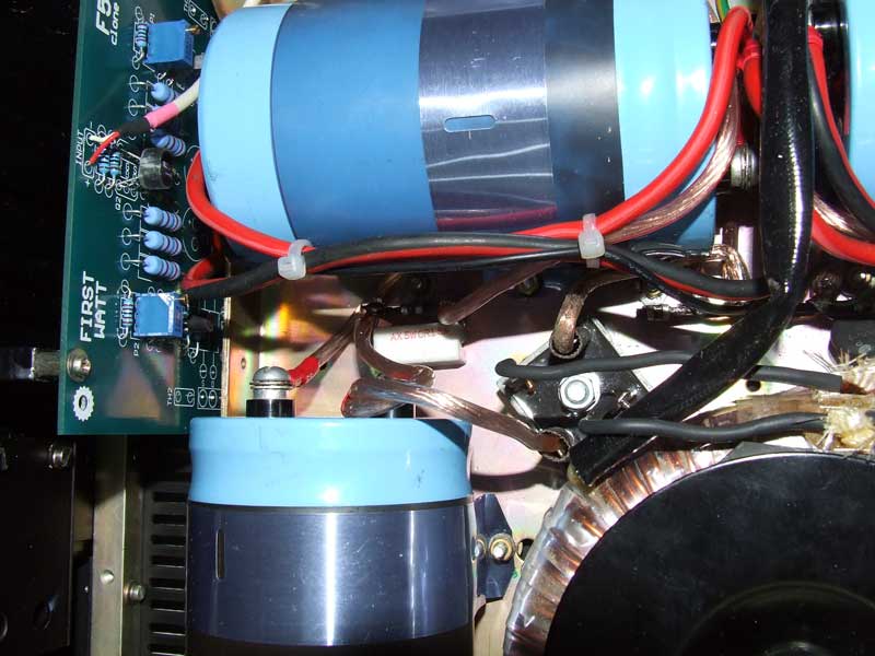

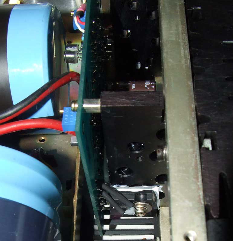

pcbs by local GB ( copyleft by Borko)
wiring - mostly Visaton 2,5 qmm
connection - Nonamers

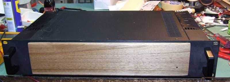

wooden front plate - treated with Dammar ........ ( maximum improvement in sound
Zen Mod said:wooden front plate - treated with Dammar ........ ( maximum improvement in sound)
What can I say....UGLY!...(but somebody said that already)...

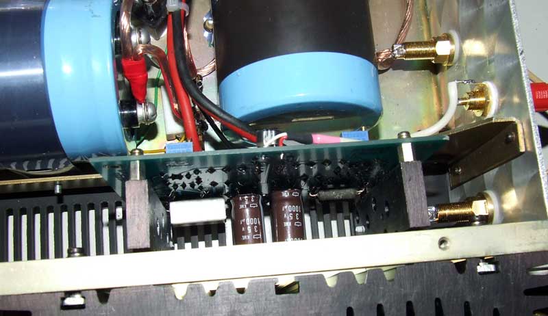

really tight case prevented really neat wiring .
I'm sorta ashamed with this one

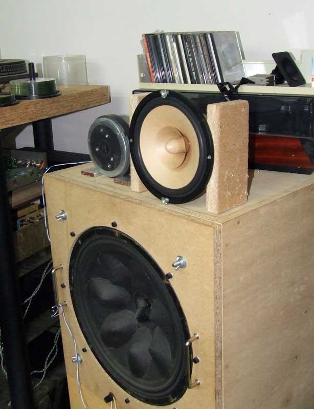

down ( not under ) is my precious LC1B , in ML TQWT box originaly made by local fella - here known as Zoran ; Selenium is dreky D205Ti , conneceted as helper to LC1B , via 1uF VQ and T attenuator .
Sonido is ..... open air ..... that's certainly most open (open) baffle I know
regarding wifey - you know our old saying ........ "good **** , peace in home " ..........
