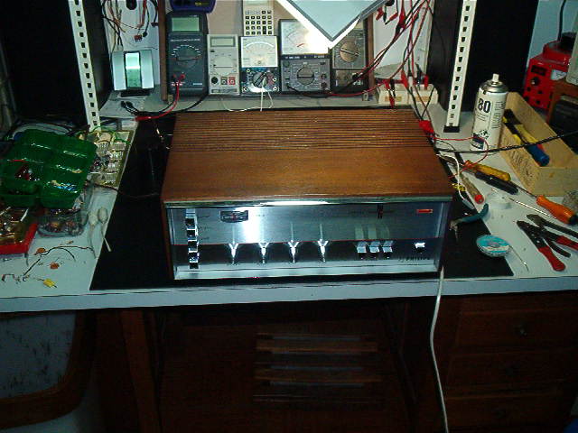

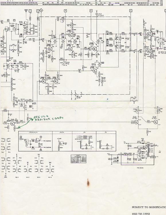

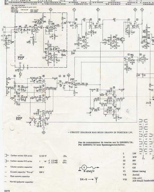

Here it goes the matching amp 22GH499 of the tuner in post #8.
20 W per channel .
In the input of the output stage, a BC 107 transistor is the only silicon device, all the others are germanium...
The VAS use a AF118 , the drivers AC 132 - AC 127 and the finals, a quasi complementary symmetry of AD149.
A particularity , the power amp is completely regulated (even the outputs ) by a discrete regulator based in a ASZ15 germanium power device and the output of the amp is capacitor coupled to the speaker...

Hi Tube Dude,
Can you send me the hi-res pictures of above circuit diagram.
I have philips, Hi-Fi Tuner+amplifier (15 RH 738 HiQ International ) model. I,am having a problem with it. and trouble shooting it.
