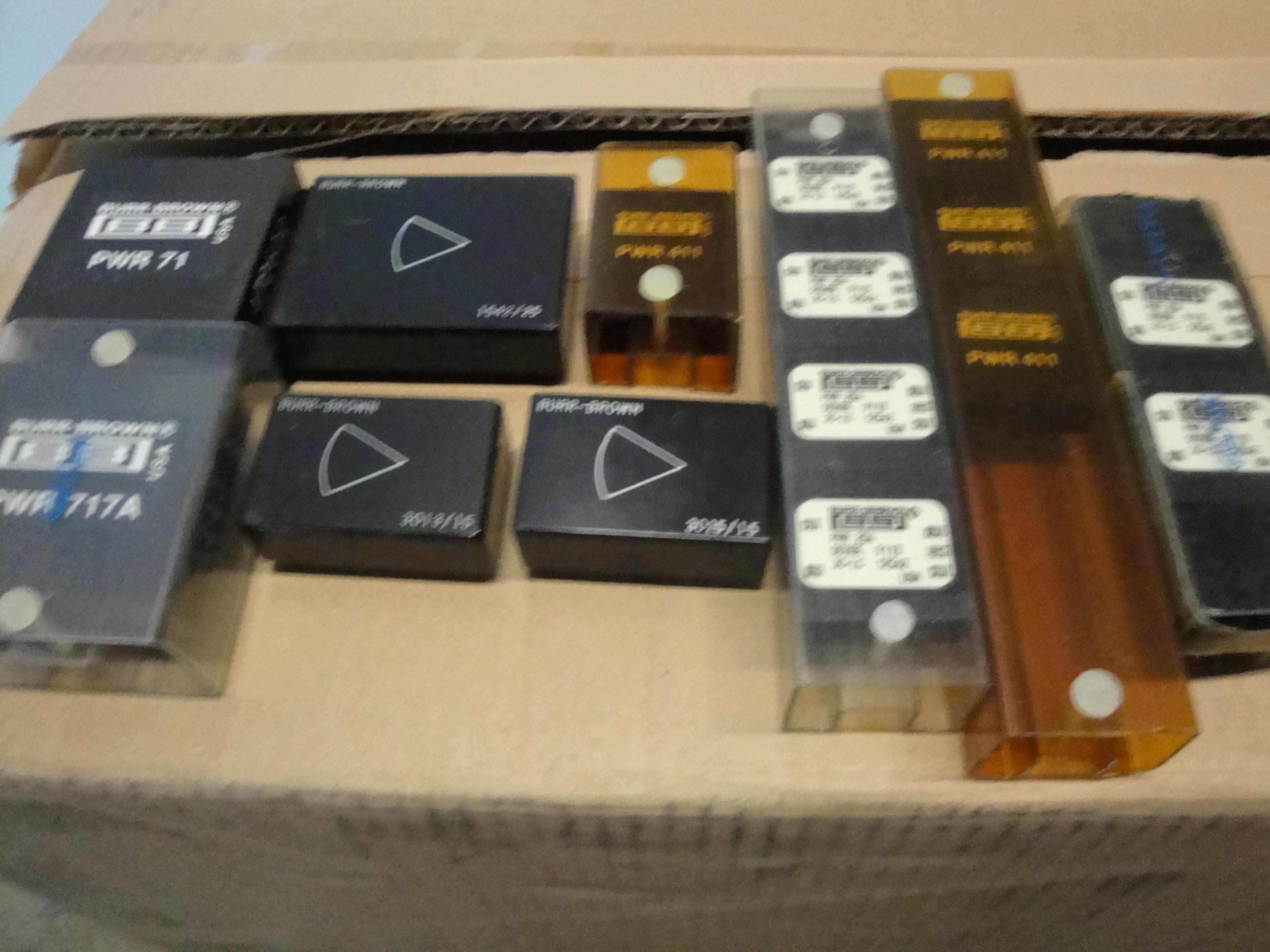

What is inside those BB opamps ? Discrete ? Any good ?
The equipment where I found those inside had a bandwith > 200 kHz
The Burr-Brown "Discontinued Products" sheet lists the OPA602AM as a replacement for the 3308/12C.

jacco vermeulen said:Unisonic UTC3308
Unisonic is a modern dual opamp with single supply, that BB is single opamp with dual voltage supply.

I think I will try it just for fun. The pcb on the picture is a complete line buffer with discrete output stage inside feedback loop.
Burr Brown, Intech, Analog Devices, Teledyne Philbrick, and others manufactured discrete op-amps. In the 70's, at Intech, I designed and characterized a variety of descrete op-amps and designed production test fixtures. The A-148A is a JFET input op-amp with a Bandwidth of 10 MHz. The 990 discrete op-amp circuit is ventrally identical to the A-148A with the exception of the JFET input and a few improvements.
The RIAA amplifier board has two A-148A’s on a 22-pin Vecotor board. It has been in use for over 42 years.
