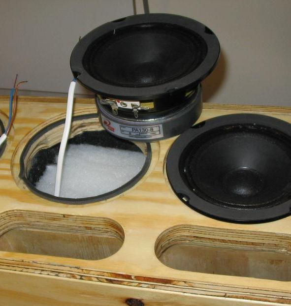

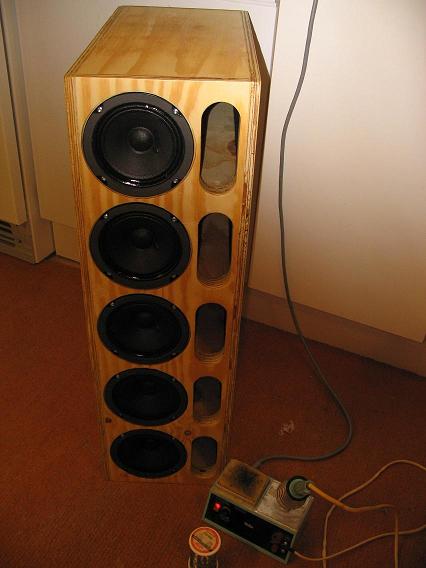

Hi boqie,
I also vote for sretens stomp box rec. it's more suitable for practising purpose than the Behringer.
Given your:” and hooking it up to a 30 watt "old pioneer receiver" and to keep cost as low as possible:
I suggest to choose some small inexpensive but and very good sounding drivers and build the enclosure with your daughter involved:
http://www.partsexpress.com/webpage.cfm?DID=7&WebPage_ID=3&Start=2&ObjectGroup_ID=585&sm=1&so=2
They also sound good when used for play back recordings and in my opinion; the 5-inch needs no other supplement in the top octave and sounds nice at the lower end too.
A year ago, I build two field programmable arrays, up to five drivers when bessel-array is the right choice, where all drivers are separated and had slotted-ports with the 5-inch version for general-purpose instrumental/reinforcement and for use in medium sized locations.
You can start with less and it’s easier and even more flexible to build separate stackable boxes to grow with and in this case 3.2 Litre and a port with 2-inch circular diameter and a length of 4 inch.
½ inch Plywood is adequate and spray-glue ¼ inch felt of wool (or ¾ inch foam) for covering internal walls.
The latter is needed for reproduction of recordings and makes the sound from vocals smoother.
I bet this little box and your old Pioneer amp together with the suggested stomp box will outperform most of the existing crappy toy like practise amp on the market, with no low end at all and tin-can like sound, especially when comparing with similar driver size and the low total cost which was the prerequisite.
B
