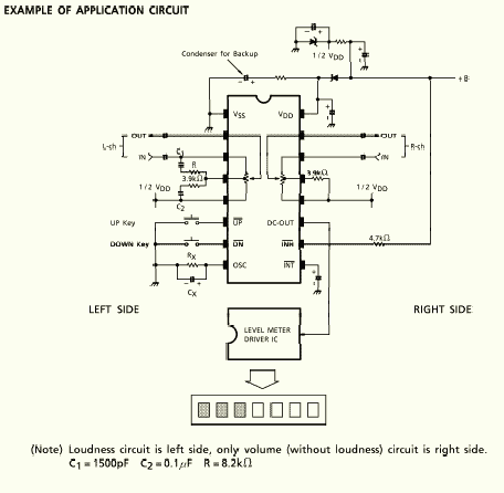

TC9235
TC9235
see PT2256 on this page:
Technical Library at Princeton
Here is PDF !!!!!!!!!!!!!!!!!!!!!!!!!!!!!!!!!!
found in Russia - Thank you Moscow!
toshiba PDF for TC9235P - 11 pages
Electronic Volume Controller compatible with TC9235
0dB to -42dB Attenuation controlled by 2dB/step.
-42dB to -78dB controlled by 4dB/step.
Attenuation controlled by built-in OSC and UP/DOWN Pins.
not bad! I wouldn't mind using it
Even if it is not HiFi you can have some good use for it.
