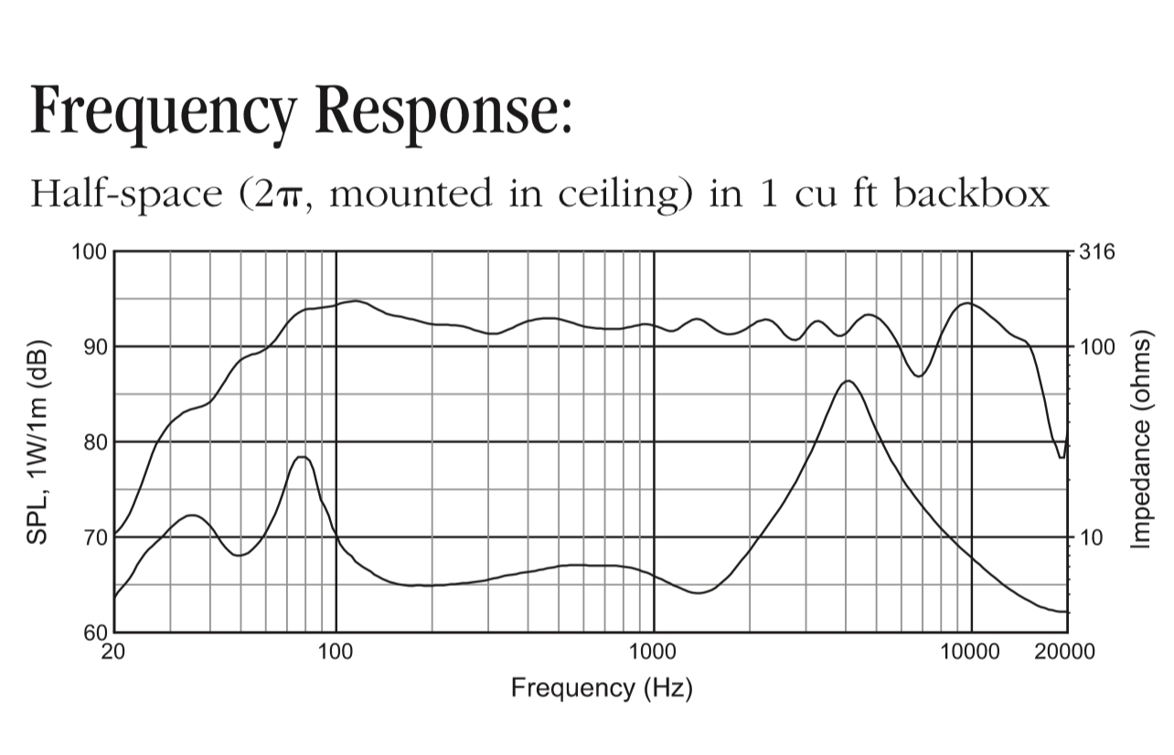

The JBL speaker used requires 2 cubic feet and just tuned to Fs.
So any design you adapt just needs that volume and calculated port.
Read the JBL datasheet which basically describes the same requirements

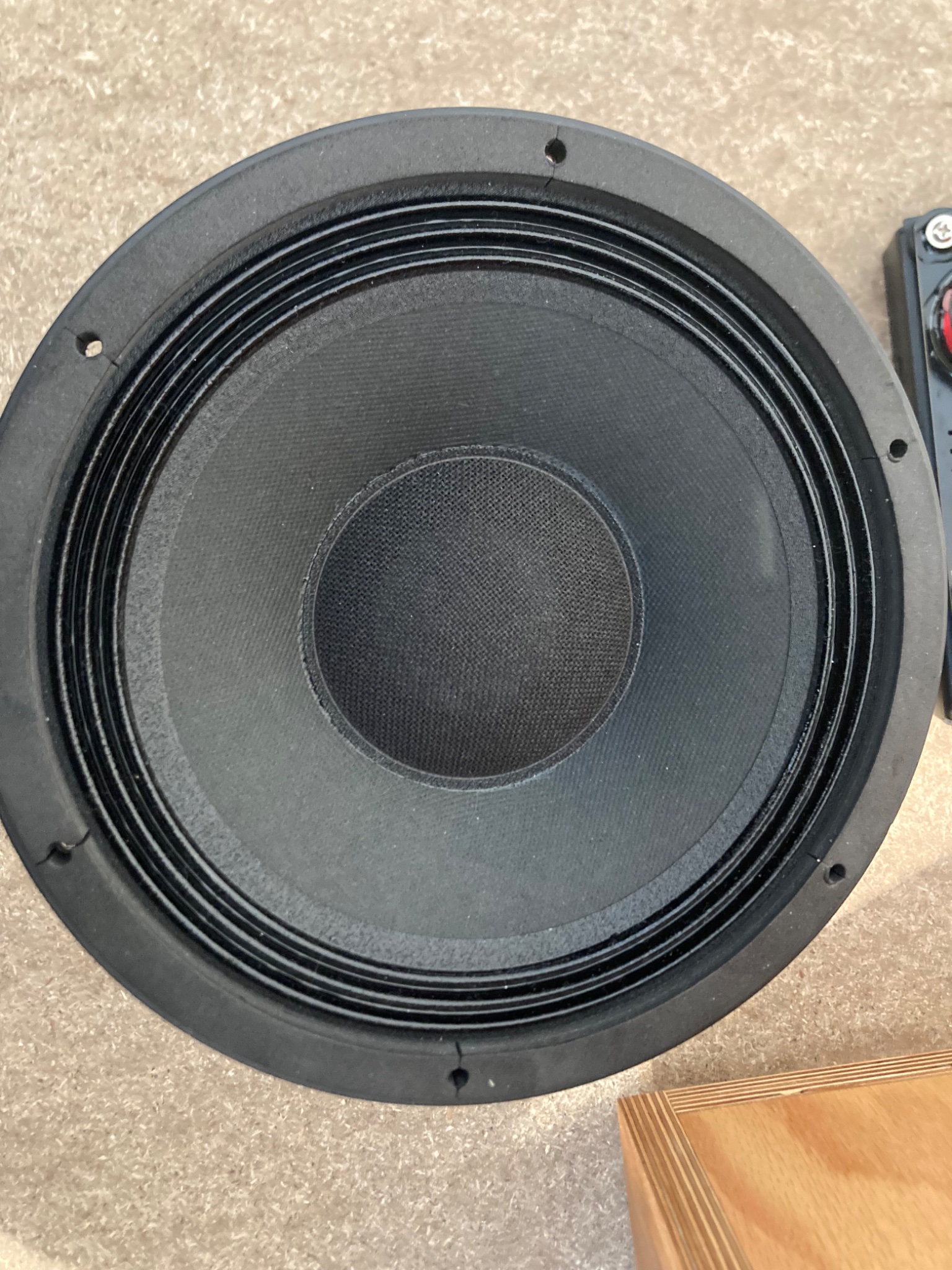

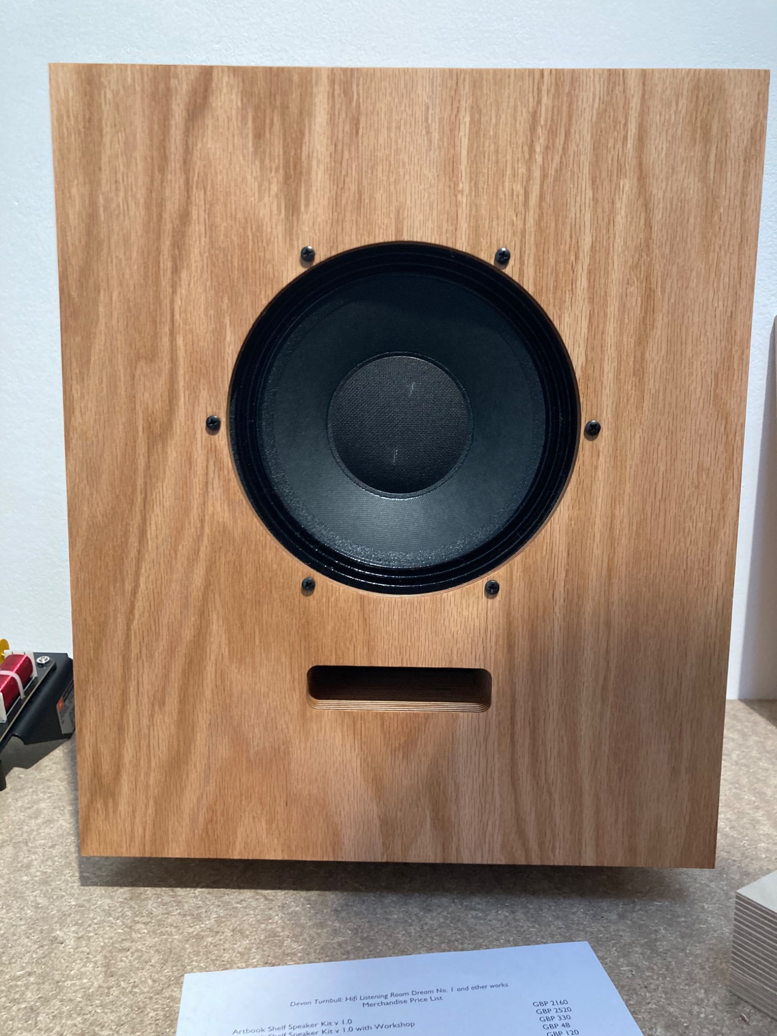

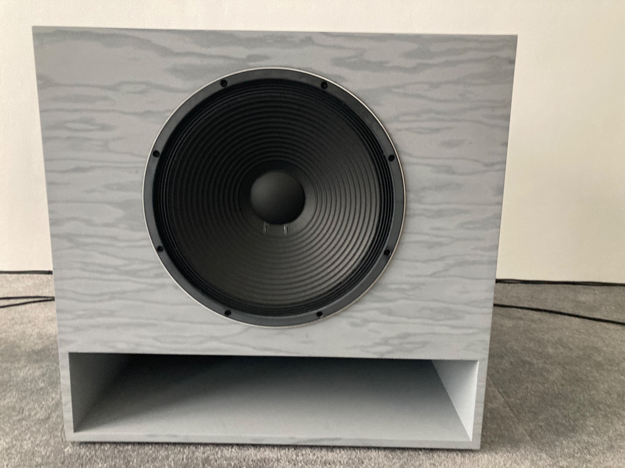

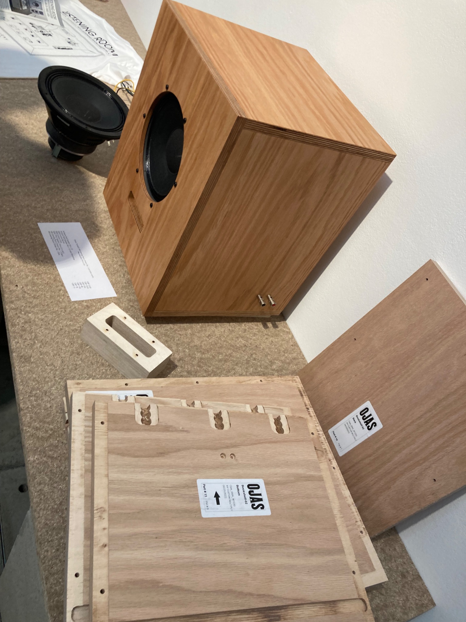

I built a pair of the Ojas coaxials for a client. The sound was unobjectionable. Given the cost, it’s definitely a lifestyle accessory though I’m not sure how that translates into holding its value on the second-hand market. As an aside, I tried to get the same client to consider coaxials from DIYSG a few years prior and they were uninterested. Not sure how the concentric 8” coaxial from DIYSG stacks up against the 8” used in the Ojas but measurements look slightly better for the concentric 8, iirc.

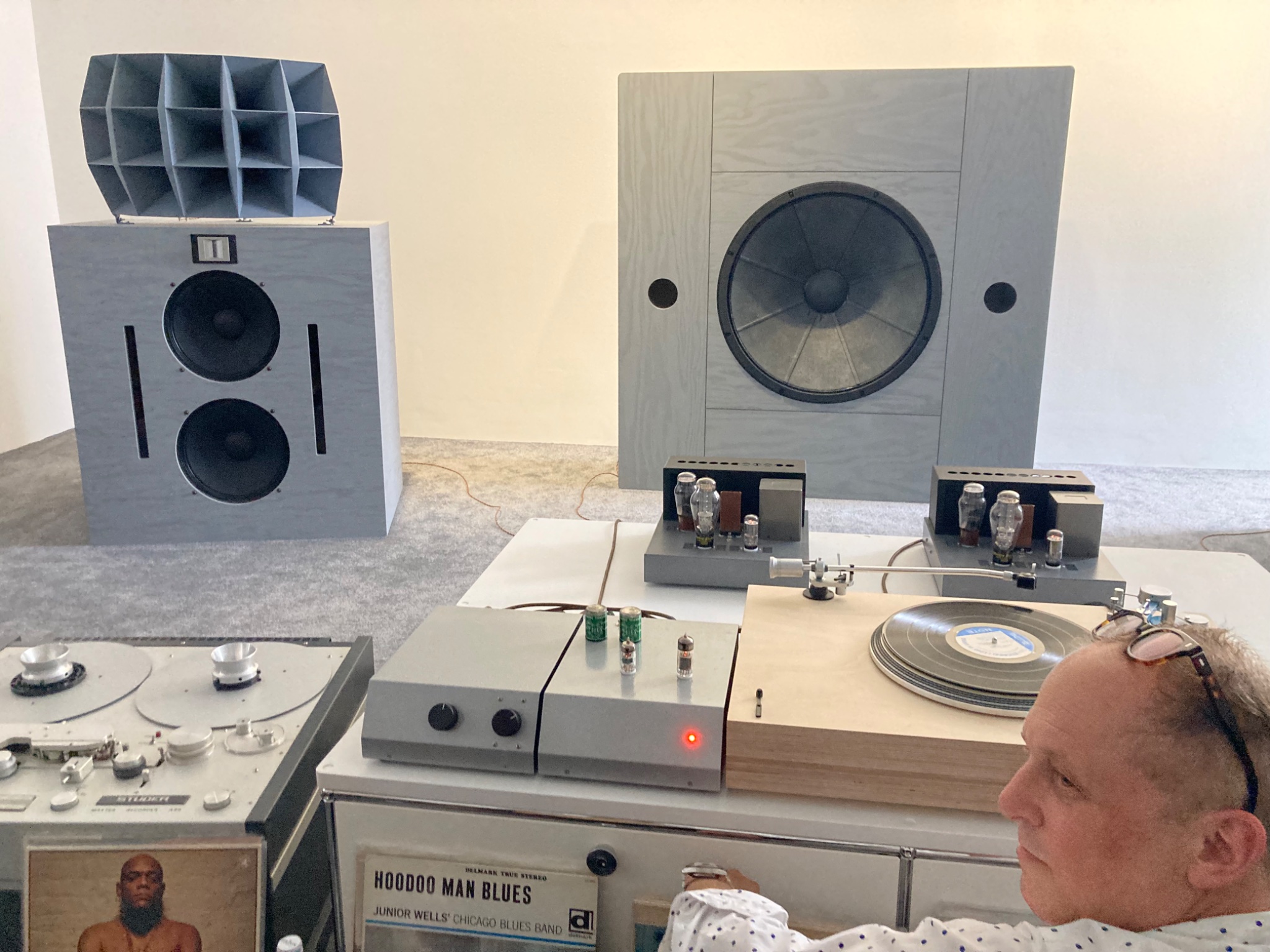

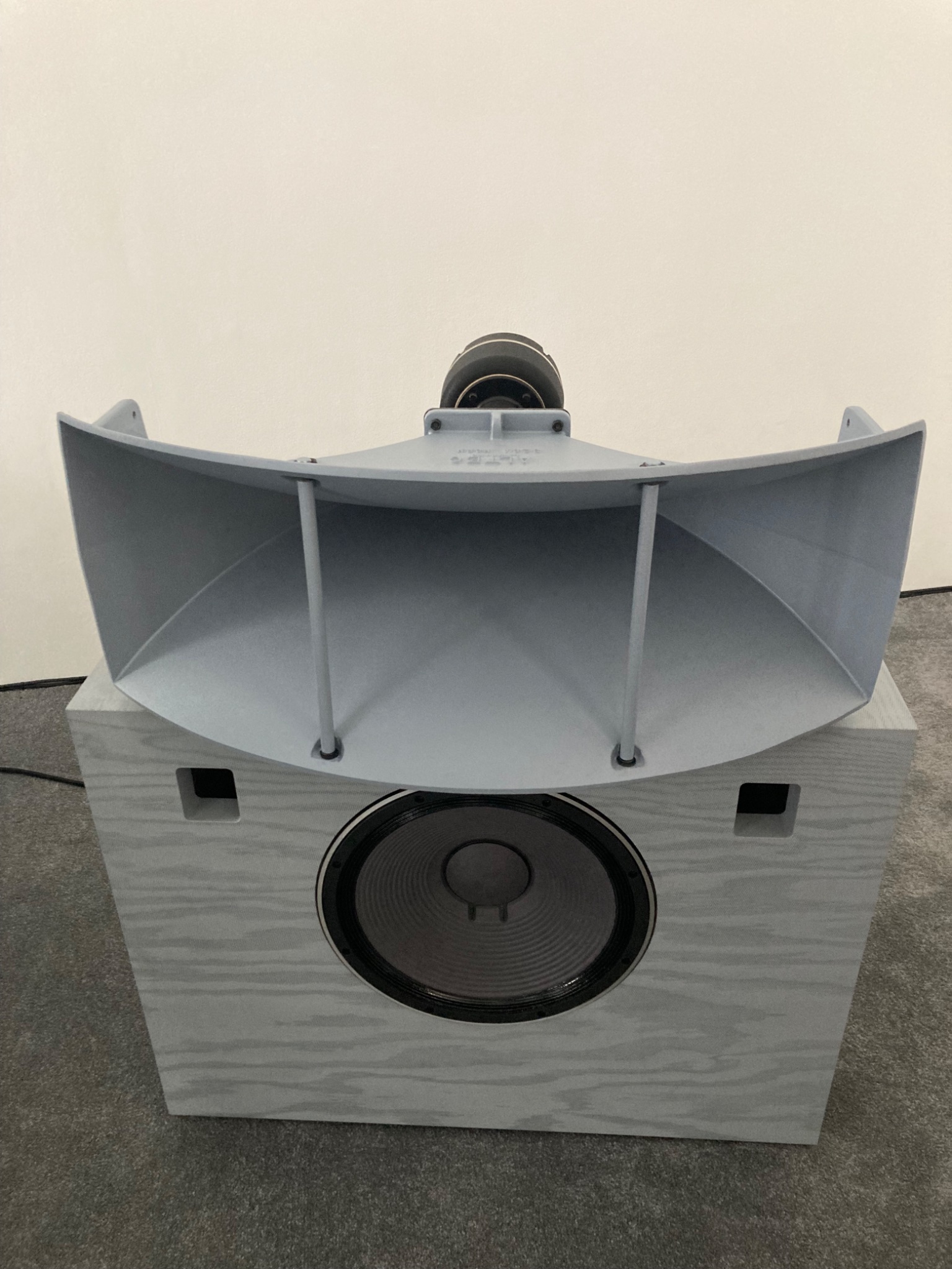

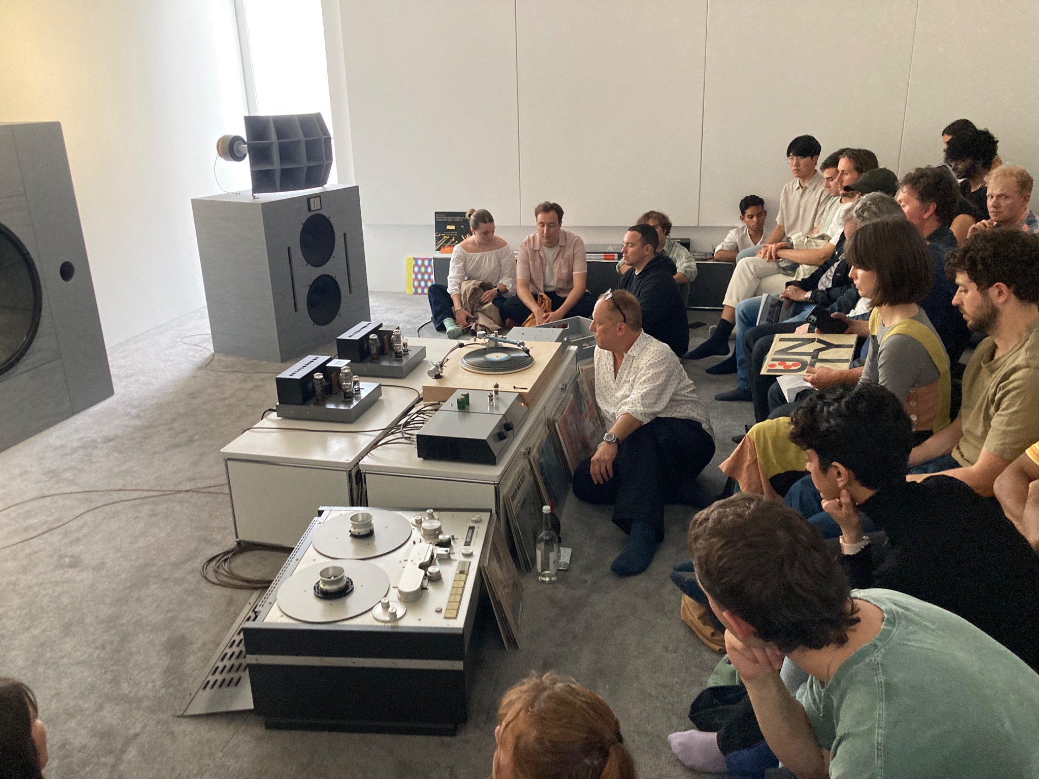

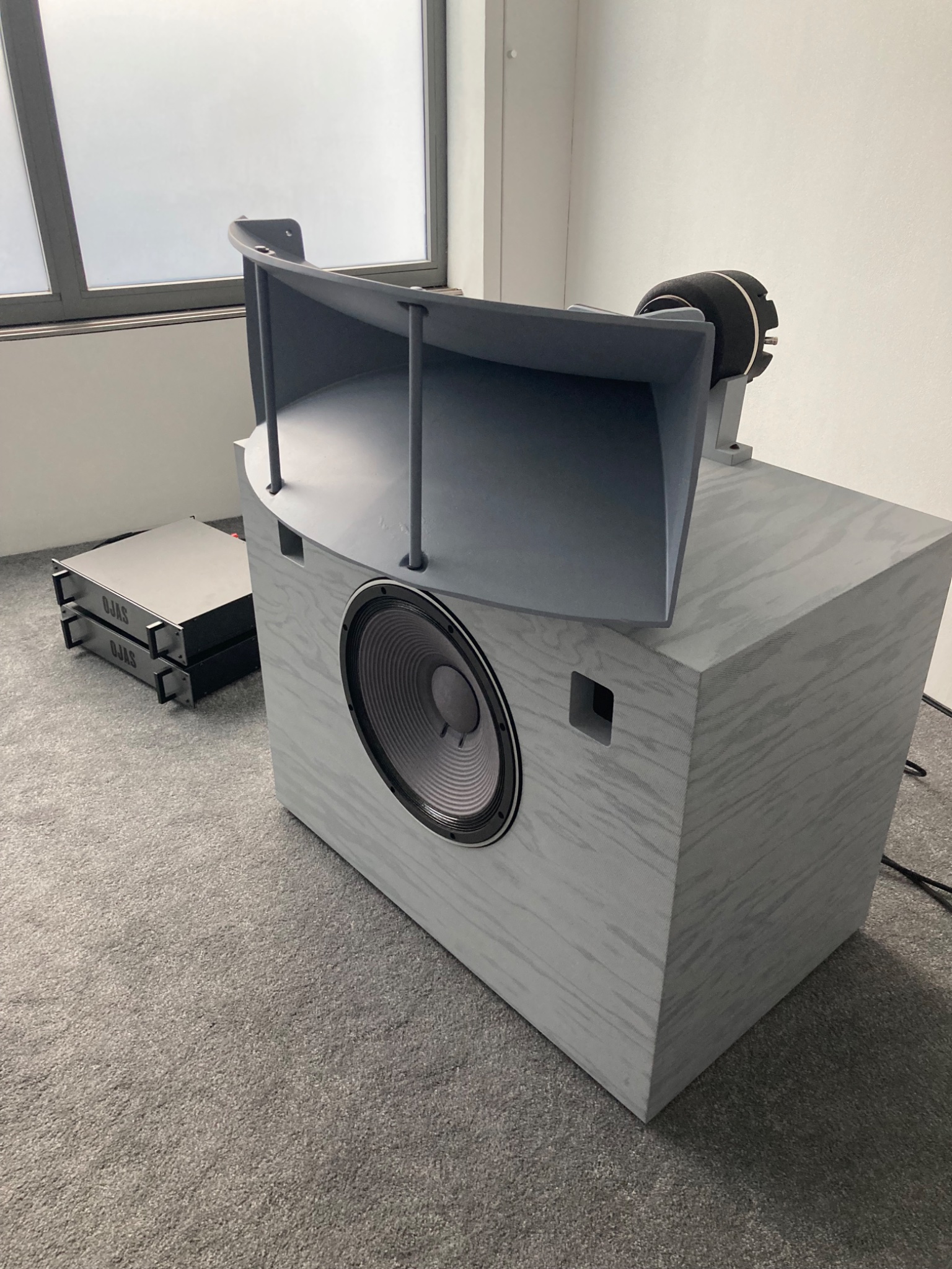

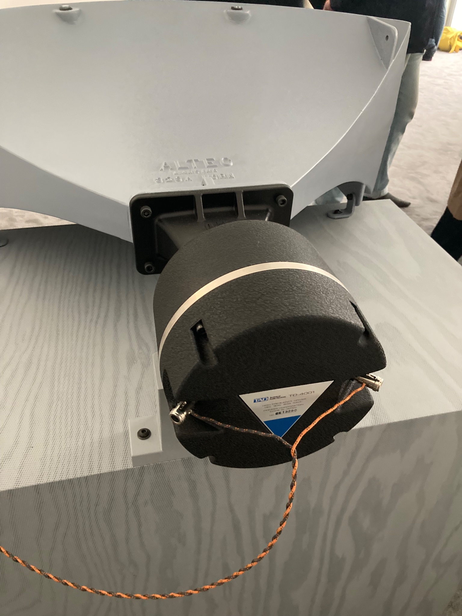

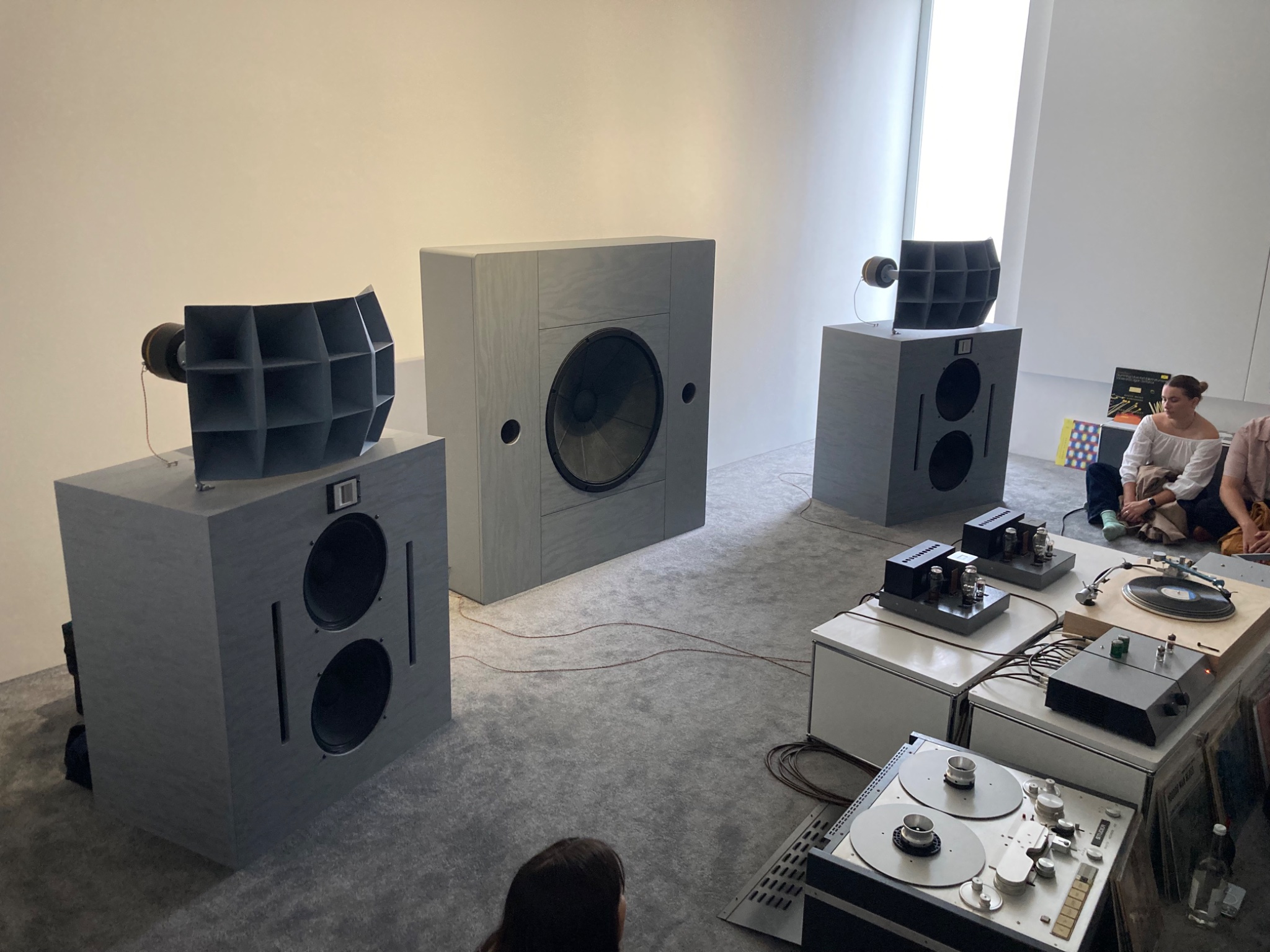

I saw it. Long queue, eventually got a seat and later even a seat in the sweet spot. The room was full of people and the windows were closed so the lack of oxygen made me rather sleepy. Music was from turntable, old jazz and similar records, likely mono.I came across this exhibition too late to go and see it
The sound was not modern, there was a fuzziness to the mids, wether that was the large woofers reaching too far into the midrange or also the records, I don’t know. I prefer a more modern horn sound, viva audio and the like.
Pictures attached. Only the big system was in play, the other speakers were exhibits.
