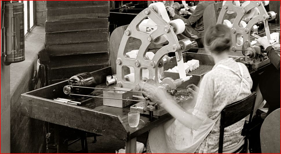

Nice picture, pointy!
You can clearly see she has the former prepared with a few wraps of separator material, but hasn't started the metal foil electrodes yet. The top metal foil spool has a bit hanging, which I suppose she is starting. Notice her neighbor is actively wrapping all parts ... you can see the top and bottom metal foils sandwiching several layers of separator.
Notice the winding machines have several spools of separator. It appears three spools are active, so this particular capacitor has three layers of separator between the two foil electrodes.
yes you would need 2 layers plus of paper, they worked for “atwater kent radios” and in the full picture there maybe about 50 people making caps. in the picture you can see some wooden trays the workers would fill them with outer cans and then pop in the inserts(they were paid by the tray). after that some guy would come round dressed in a brown lab coat and put the trays on a rack shelf and then oil them. some company used a vibration shelf to cut down the time it would take to shack the air bubbles out.

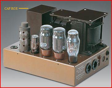

if you are making more than one cap for an amp you can try to do it as "leak" did. put them all in a metal box with a full flange and gasket so the top seals on, nearly all of these have lasted 50 years with no "leaks".
