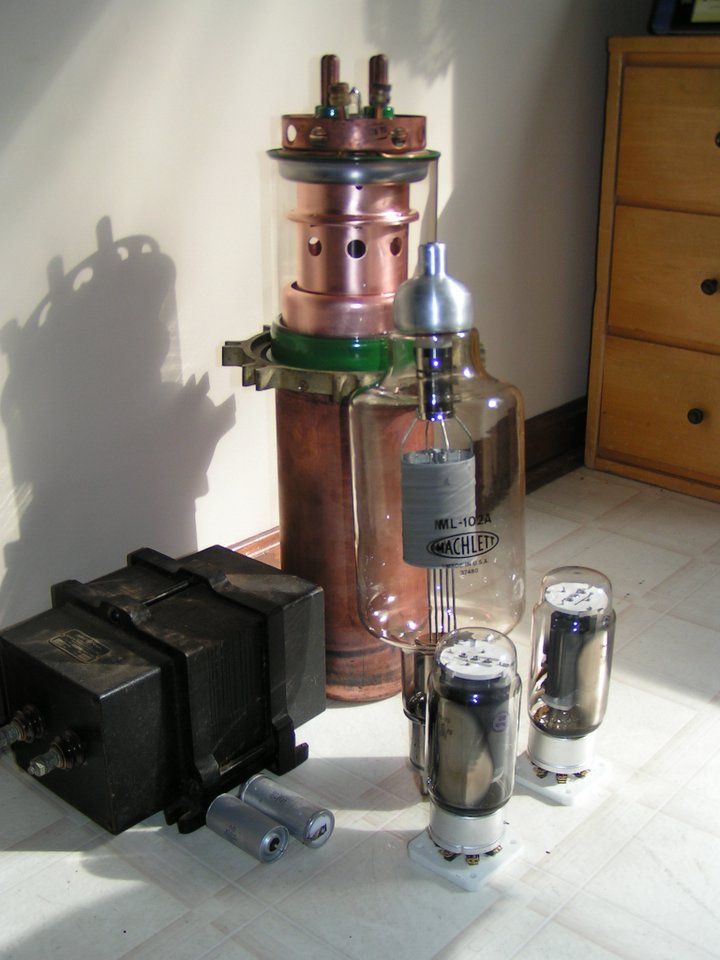

Pearl Tube Coolers. Not sure how well they work. The seals are one of the more important parts to cool if you are using forced air cooling.
Heres a pic of a water cooled GU23A triode, along with a high vacuum HV Machlett diode, a couple of GM-70s and what is likely a radar choke. The pipe connections are for grid cooling water.
Your right, it doesnt take many at all, and things may get interesting once DC electricity is added. Water doesnt stay technically pure all that long in most enviroments either.
Setups where water is used as a dielectric are often heavily and continuously filtered, it is an undertaking really only for specialized physics laboratory use etc.
