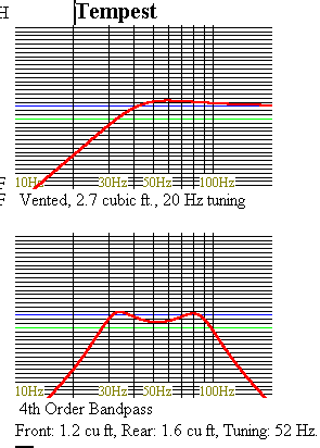

I have a few ideas, a couple of which are fairly wild. I will just give the first couple of conventional notions first.
A) A vented box of 2.7 cu ft, tuned to 20 Hz, put into a corner. The box iself gives you a smooth response that is 3 dB down at about 32. However, a corner boosts the output at the vent frequency about 5 or 6 dB. When this happens, your curve will change so that you should be 3 dB down around 27 or 28 Hz. When it comes to loudspeakers, 6 dB = half an octave = double the box volume.
B) A fourth order bandpass box. This is generally recognized to be 3 dB more efficient than the vented system. So right there, you make up half the difference you are losing by halving the box volume, even without help from a corner. I ran it on WinISD, and got best results from the following: Front chamber: 1.2 cu ft, Rear chamber: 1.6 cu ft, Tuning: 52 Hz.
The response on the graph for the bandpass looks slightly ragged, but remember that it only amounts to a couple of dB between the highest and lowest points, and that is not particularly hearable in the real world. On the graph below, note the extra output below 30 Hz-it is right in the range you were aiming for, and it is above the 3 dB down point. That is your 3 dB benefit for the fourth order bandpass box.
Incidentally, I don't think putting the bandpass box into a corner will help your bass extension much. The resonance frequency is 52 Hz, so that is where most of the increased out put will go.

Here is the graph for the vented box and fourth order bandpass box. Blue line is the midpoint, green line is the -3 dB down line:

Kelticwizard, thanks for your work on this. Interesting ideas. The 2.7/20Hz vented looks like it has a decibel efficiency over a 2.5 sealed as it is. Does a vented box actually react more to a room's transfer function?
2.5 Sealed: can be stuffed pretty heavily so I could get away with a smaller box for the same response or that size box and slightly better response.
2.7/20Hz Vented: Higher efficiency, but the big thing for me is that xmax is going to dip bigtime at 20Hz, so I can drive the sub with more power at less distortion giving me a better window for a linkwitz transform.
1.2/1.6/52Hz 4th Order Bandpass: Warming up to the idea.. not sure.

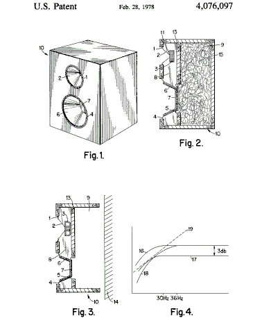

Here is some info on one of the two systems I was talking about. It is the Augmented Passive Radiator enclosure. It is essentially a dual chamber system with a two passive radiators connected together. Lest this sound expensive, remember that a passive radiator can be nothing more than a piece of weighted styrofoam hung in an enclosure opening. This particular system seems to be adaptable to passive radiators that can be homemade at little cost.
I will admit that I have not made this enclosure or a handmade passive radiator yet, so I cannot say for absolutely certain that this is so.

By cutting the volume of your speaker in half, you lose 6 dB. That is the equivalent. The augmented passive radiator system is 3 dB higher than a vented system, so you are halfway back I include an illustrative page form Clarke's patent.
In a couple of days, I will give you info on a sort of augmented passive radiator version of a bandpass system. It is called the Acoustic Lever and it was invented by Earl Geddes, former audio engineer at Ford. More about that later. It might increase your efficiency even more than the 3 dB the passive radiator system is supposed to.
Anyway, just to make sure, in these illustrations of the front-mounted augmented passive radiator system, the driver is the smaller cone on top, the passive radiator assembly is the larger cone on the bottom.

Just thought that I would add that the Augmented Passive Radiator has a lot of variations possible. However, 2 of the most useful appear to be:
A) It has the same 3 dB down point as a vented system of the same size with the same driver, but has a 12 dB/octave rolloff from there instead of 24 dB/octave like a bass reflex. This adds a certain amount of bass in real world rooms where "room gain" is a factor.
B) It has a 24 dB/octave rolloff like a vented system, but the 3 dB down point is a quarter octave lower than the vented.
Plus, there are variations like 3 dB down points even more than a quarter octave lower than the vented system, but with a 30 dB or higher rolloff per octave. This last alignment is for the man who likes bass and isn't fussy about transient response.
