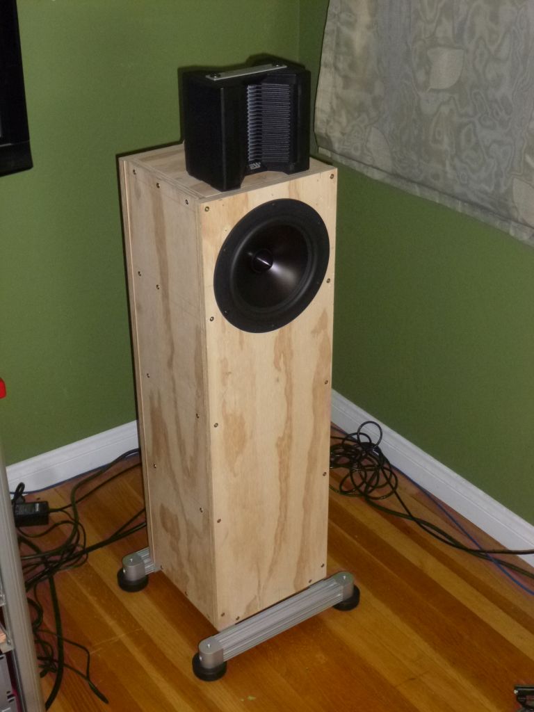

Has anyone ever heard the Kithara or any other Oskar Heil speaker?
I'm currently using the RS225 with the Big Heil

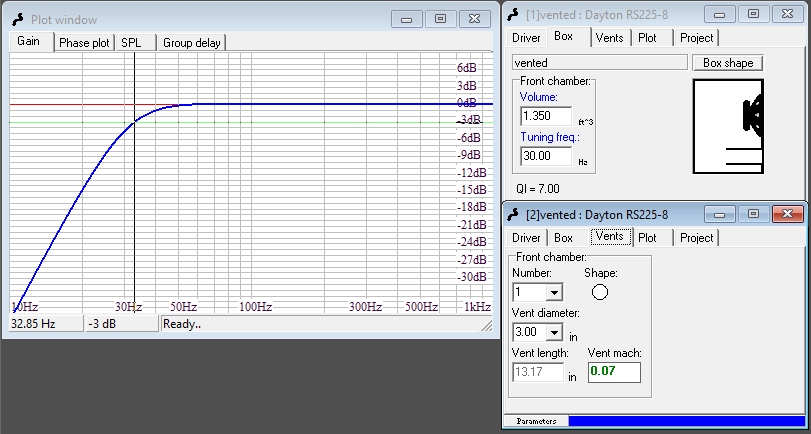

Hi themcul,
I modified the RS Duet MLTL cabinets (Paul Kittinger design) that I previously built. I kept the 10"x10" width and depth the same but shortened the height to about 30.75". I removed 1 of the 4 internal braces and converted it from a MLTL to bass reflex. I used a down-firing 3" Precision Port and raised the cabinet about 2.75" for port clearance.
Attached is the WinISD model I used. F3 is about 32.85 Hz as shown. I use miniDSP crossed @ 1K and biamp the drivers. No subs needed unless you're a bass freak 😀
