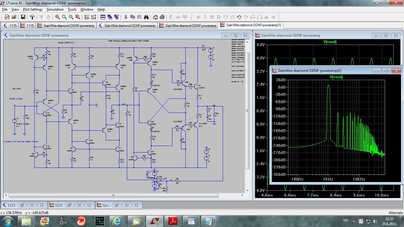

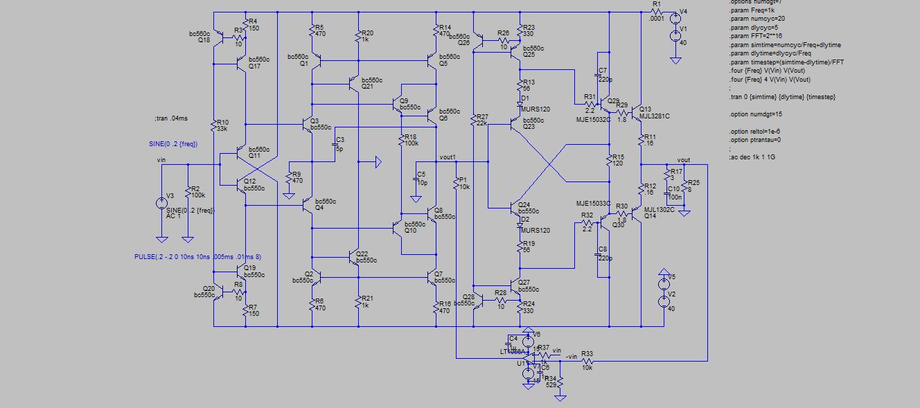

This is no GNFB amp, the gain part is a current conveyor and output stage use Only Distortion Negative Feedback (ODNF).
The gain is set by the P1/R9 ratio.

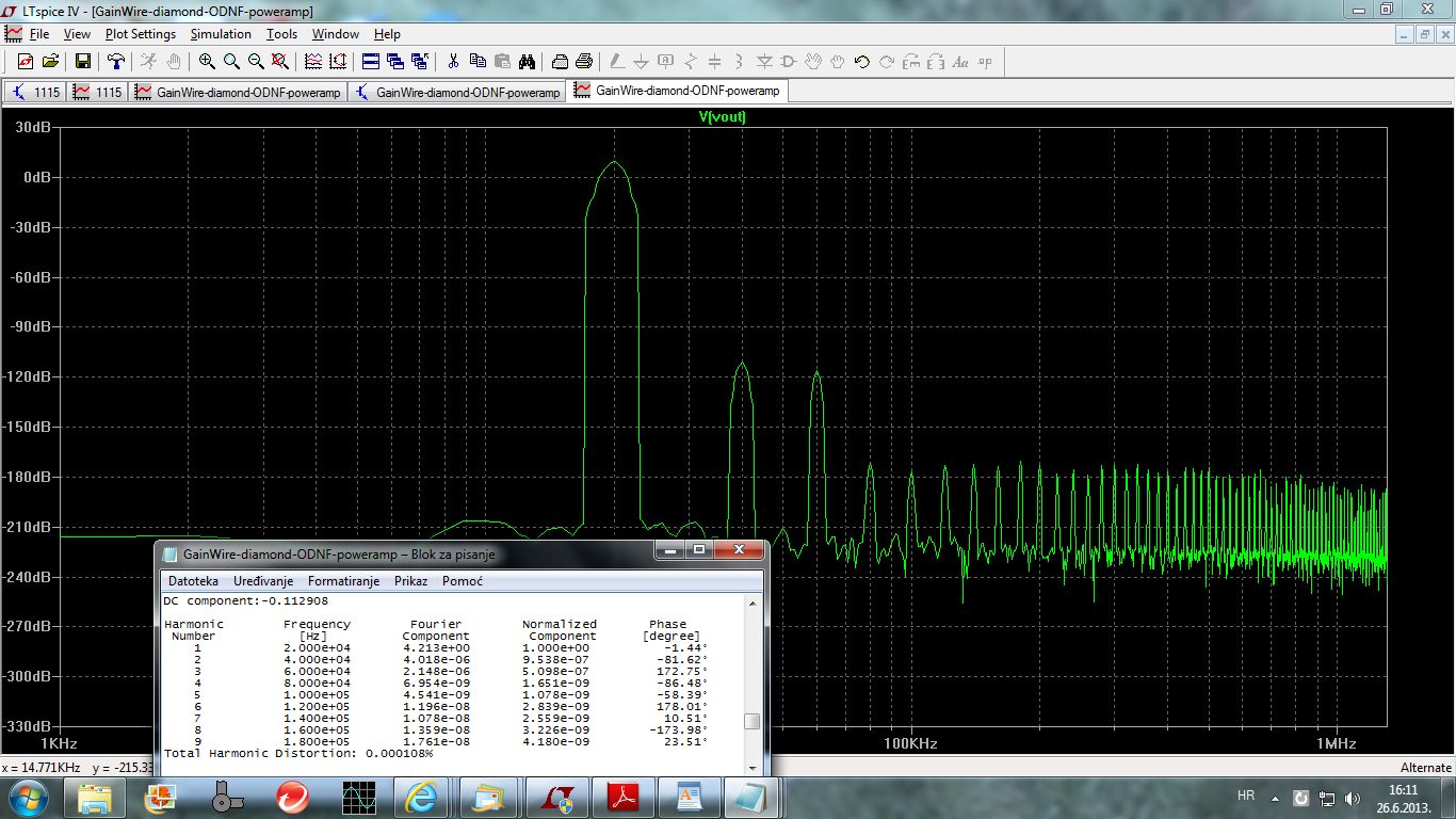

Distortion was lowered at 1 kHz with ODNF from 0.036191% to 0.000323% (40dB) and at 20 kHz from 0.037325% to 0.006647% (15dB). I am not sure what is the reason for that low improvement at 20 kHz, could be the OP amp used in ODNF or I do something wrong here. Comments and suggestion welcome.

In LTspice at least the choice of op amp can have a massive affect. Try LT1128.
Simple changing from LT1056 to LT1128 I've got oscilation, so simple swap does nor work, need more simulation.
Try putting a cap across the opamp from output to inverting input. Start at something stupidly high like 1n.
This is based on what I have found using a similar system in a global feedback amp. Remember, it is a feedback loop and may need some compensation.

With 5 pF it still have small oscilation, with 7 pF is table and distortion at 20kHz drops fro 0.037325% to 0.003628% and that is 20 dB still to little.
Try reducing P1 in value.

Your implementation of ODNFB is interesting. Do you have a sim for just the section enclosed by ODNFB? This would let you know how much THD is from that section and how much from the input section.
Luxman runs the output stage openloop and compensates for the voltage gain stage errors (using ODNFB), so different from what you are doing.

Hi Struth,
Yes I simulated separately the gain stage and output stage. The gain stage has very low distortion in whole audio band, almost all distortion was generated in the output stage, that's why ODNF was used on output stage.
BR Damir

Damir, you seem dissapointed, those are very good numbers for a amp that doesnt use GNFB. Look around and try find some that can even come close to that. There simply is none.
The choice of opamp is important and Id use one with much higher performance that the LT. The reduced improvement at high frequency is simply the lower loop gain of the opamp resulting in the opamp less able to correct errors.

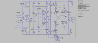

An japanese diyer Shinich Kamijo(deceased) explained,
ODNF differs from HEC or ZDR ,which can theoretically cancel out entire distortion,
ODNF cannot cancel the distortion entirely.
The amount of improvement depends on the loopgain of ODNF loop ,which is almost the same as in GNFB.
Only Distortion Negative Feedback Circuit
Your simulation looks showing -6dB/oct ,in accordance with the theory ,dadad.

Oop! Was going by memory. Looked at the Luxman drawings I downloaded ages ago and the ODNFB monitors the output and the input but controls one of the push-pull VAS devices.
Still, are you certain your current conveyor has negligible THD? Have you measured it?

Thank you Shinja,
Yes ODNF does not cancel all distortion as that a kind of NFB, But HEC is also kind of NFB how could it cancel out entire distortion even theoretically, because of positive feedback involved? I never heard about ZDR.
In my simulation distortion increases with 6dB/oct and that is reflection of the opamp I used. Probably with better opamp the knee could be moved ut to higher frequence.

Yes I measured it, here is THD20k at the same output level I simulated whole amp.
I would like to point to the one particular thing. The gain of the current conveyor can be controlled by changing P1 value(in this case P1 is a volume control), but for ODNF it requires constant gain of the input stage. In this case advantage of having constant noise level at all volums is lost. My intention is to try next the same input stage with HEC output.
