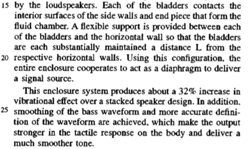

According to the patent # 5895896, as disclosed in U.S.Pat.No.5,281,777 issued to Alton Jr., the flexible bladders receive acoustic pressure waves generated by the loudspeakers.The fact that there is nothing out there on them and they went out of biz long ago, makes me question the water bladder tech.
The water bladder produces "about a 32% increase in vibrational effect over a stacked speaker design".
Considering tactile transducers are several orders of magnitude more efficient in making things shake ("vibrational effect") the water bag technology seems rather wasteful.
Drivers look substantial, but with only one coil working will be low efficiency and may have limited excursion in one direction-which would make them "shake" more 😉 .
The IBS subwoofers may exacerbate IBS (Irritable Bowel Syndrome) 🙂
A quick test with a low frequency sine wave or 9volt battery in either polarity applied to the terminals should determine if the excursion is symmetrical.
Reconing the drivers may cost less than equivalent units.
At any rate, the the cabinets should be useful..
