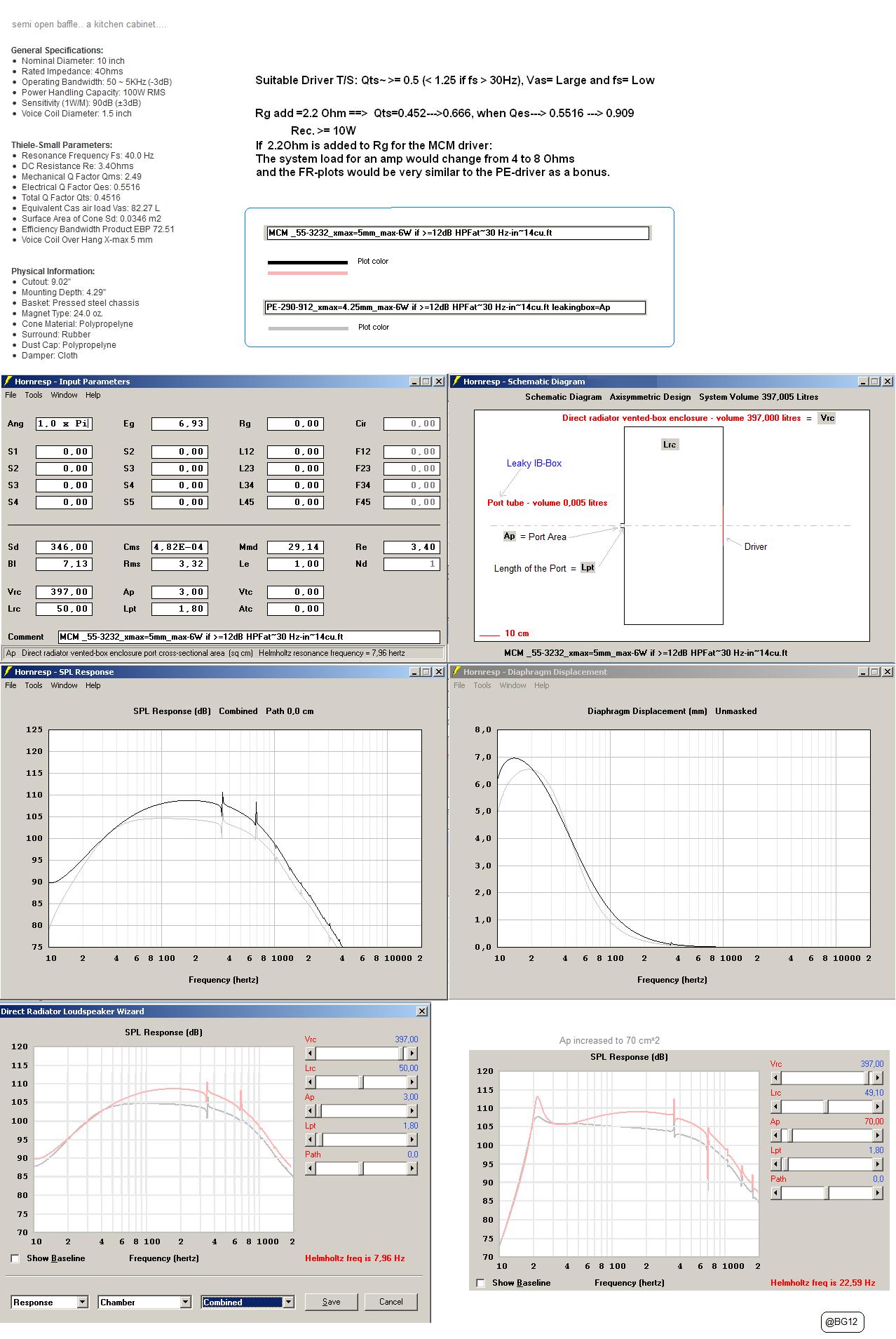

So what sort of TS parameters should I be aiming at for a 10inch sub driver that I can mount on the side of a cabinet that has about 10 to 15 cu ft of space inside but is not necessarily sealed? It has drawers and cabinet doors and shares space with boxes of food and canned goods🙂. The driver would never be driven hard enough to open these doors, but decent clean very low spl bass would be nice to have in here. Space to put the driver would be about two feet back toward the wall between two cabinets that have approx 8 inches between them.... little bit of slot loading there. Will use one of these. I just got a pair extremely cheap from a friend who got a bunch from the NHT sale and never used them all.

Hi, Here is a suggestion using a inexpensive driver (xmax> 3.6 mm) in a ~14cu.ft(Vrc) leaky enclosure.
Download HR and input the given numbers(or pick another Driver that suits your need):
Adjust the 'leak' in the wizard screen, i.e. Ap and Lpt until it represents your cabinet space leaks.You may also change the Vrc and Lrc too if necessary.
b 🙂
b 🙂

bjorno, what is it in the TS numbers that suggests that driver for this?

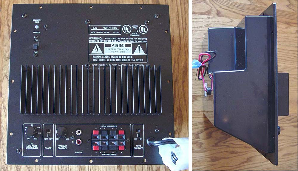

I'm going to go with the original idea and use that Foster 100watt amp along with this 10 dollar little Jugo of a driver (at least it's got good rubber and no rust). The most fun will be doing this ultra cheap since this is the kitchen for crisssakes and the receiver, cd player, and mains are pretty middling.

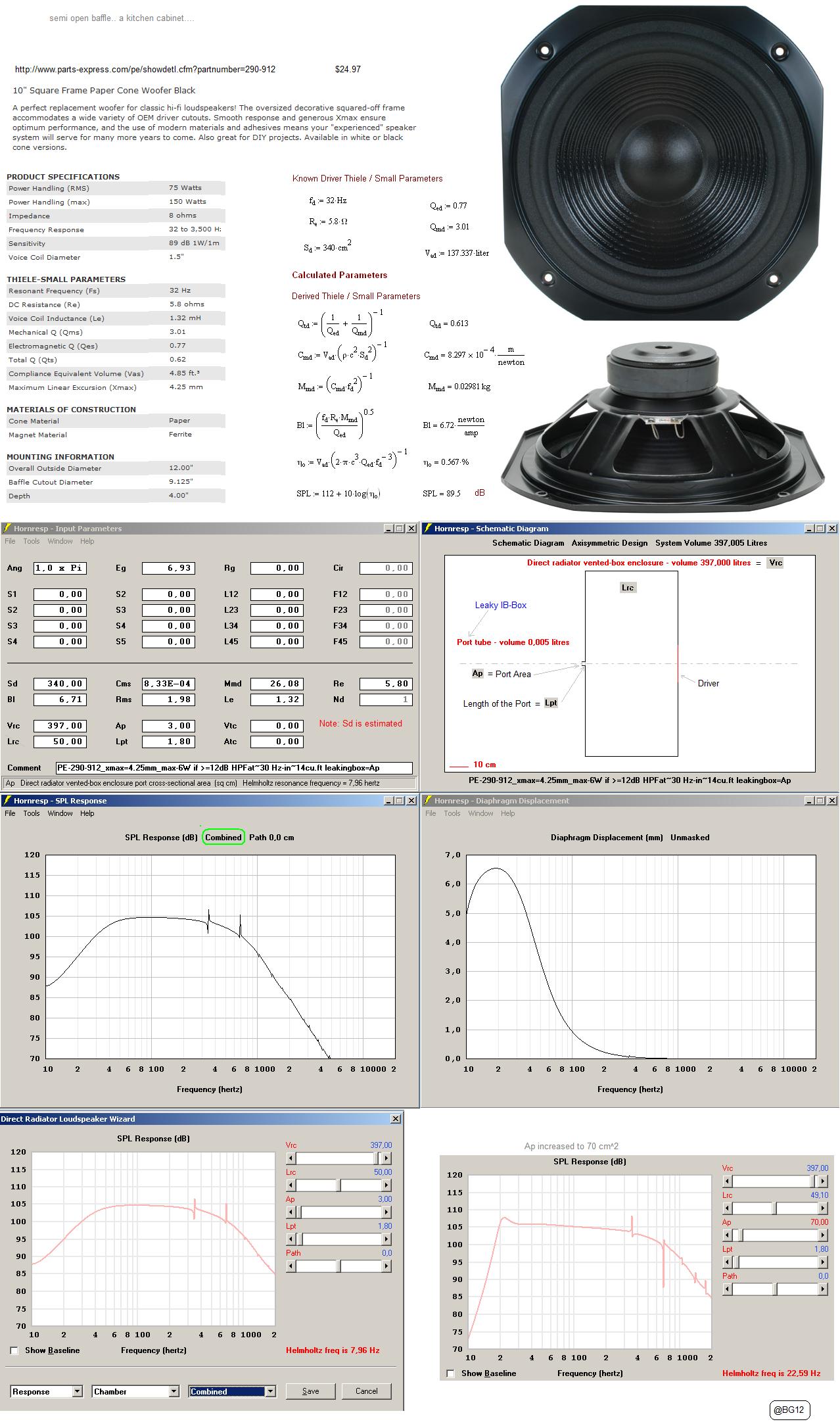

Or this PE one for about the same price....?
GRS 10PR-8 10" Poly Cone Rubber Surround Woofer 292-421
It's been noted that MCM specs are unreliable. The bumped backplate on the MCM driver makes me wonder if the xmax really might be greater than the PE one.
