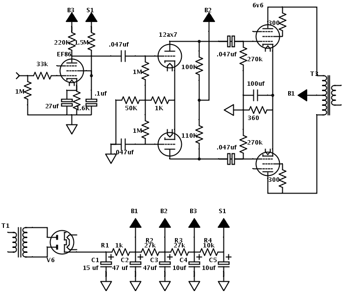

I built an amp a couple threads ago, in my "help choose a guitar amp to build" thread.
Was just using an old, cheap woofer. I put better speakers on it, and all the fun is over.. Lots of noise.. (old speaker didn't go high enough in frequency, and was inefficient)
I cleaned up most of it and the amp is silent other than a slight hiss when the input is grounded. Also, there's a volume control between the input and LTP, and w/ that volume down, the amp is silent.
But, with nothing plugged into the input the amp makes a loud buzzing.
I'm not sure what's normal w/ a high gain instrument amp, so I'll just list some symptoms..

I completely rebuilt the input stage a few times today.. Replaced all the antique carbon comp resistors I was using, cleaned up messy solder blobs, and replaced everything again! no changes.
Any ideas? Is the amp likely the culprit, or is it ok since it's quiet when the input is shorted or a cd/mp3 player is connected?
This might be a stupid question but are you using 1/4" "shorting" jacks for the input? They ground the grid when there is no cable plugged in and are mandatory in MI amplification.
As far as the noise floor when an instrument is plugged in, sounds like a ground loop issue.
I'm not using a shorting jack... Thanks! I feel a little better now, because shorted, it's almost silent (just a little hiss, which I think is normal).
I chased ground loops all day.. I was using an old chassis, and originally left things grounded to the chassis as they were.. But now everything is star grounded to the first cap.
Well actually, I have the ef86 cathode and 'rg' and the input socket (so the guitar) all connected in one spot, and that junction connects to the first cap.. It's probably wishful thinking this will make a difference, but I'm heating up the soldering iron now..

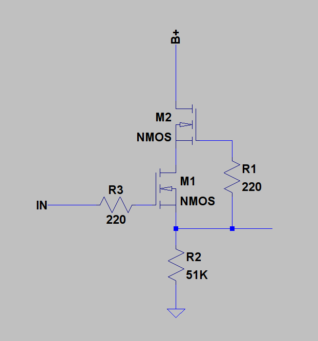

I just realized I don't need a negative supply to add a source follower after my ef86, do I? I've only used them to drive negatively biased power tubes, in the past.. But here, the signal is well above 0v.
So, just a mosfet, 100r gate stopper, and 220k on the source, right?
(My schematic is no longer complete.. The tone controls are between the ef86 plate, and .047uf coupling cap.. I'd insert the mosfet directly after the plate, and before the tone controls)

Yeah, the proposed mosfet topopology will work fine, just make sure to chose a mosfet with low CRSS (capacitance gate to drain)
More here: http://www.irf.com/technical-info/appnotes/mosfet.pdf
Perhaps George (tubelab) or Anatoliy (wavebourne) will suggest suitable mosfets based on their experience. Mine is limited to DN2540 in cascode ccs and mu-followers and I use low rp tubes with them. (Their CRSS is way too high for use here IMO)
Perhaps you could even use a cascoded follower to reduce the effect of
CRSS, and then you could use commonly available DN2540.. I would run enough current through it to get relatively high transconductance, perhaps 3 - 4mA or more.

( note difference between enhancement and depletion modes in this sort of application)
I'm afraid this is over my head, and I've tried to self-educate w/out much luck.. (I'm assuming you meant "note the difference" and not "no difference")
The standard diagram for a follower (on guitar amp forums) uses an irf820, which is enhancement mode.
The LND150 and DN2540 are depletion.
I added the LND to my circuit, wired in just like the irf820 diagrams. So, gate connected to the input tube plate (w/ a gate stopper). Source connected to a coupling cap, to the next stage, and large value resistor to ground. Drain connected to b+.
It works... as in, it passes a signal.. But that's all the testing I've done.
I know that can be improved several ways..
But, should something be different, even for the most basic follower circuit, w/ depletion mode?
That is correct. I have used LND150's as followers in exactly this way. I usually use a 100K for the source resistor.
Wiring the LND directly to the plate of a high gain tube may lead to oscillation. Add a resistor in series with the gate, and slip a ferrite bead or two over the wire between the resistor and the gate.
If the noise in your amp sometimes turns on and off abruptly it may be oscillation. Try a small (100pF) cap from grid to ground on the EF86.

Think I had a bad cap on the ef86 screen.. I tacked a new, grounded 10pf cap to it, and it got much quieter. (hiss went down, and very faint radio station pickup went away)
Changed the 12ax7 ltp to 12at7, for a little less gain
Added plate to grid feedback, of 200k resistors between the 6v6 plates and the 12at7 plates.
I did that all at once... Then tested again, and it's much better! Still a little too much hiss, but the amp is a 'rats nest' of wires and not enclosed. Once I build the final copy, I'm sure that will be better.
The loud buzz from the guitar is also much lower now. Still picking up the same interference (still have the same quiet line through my house), but it's an acceptable level now.
