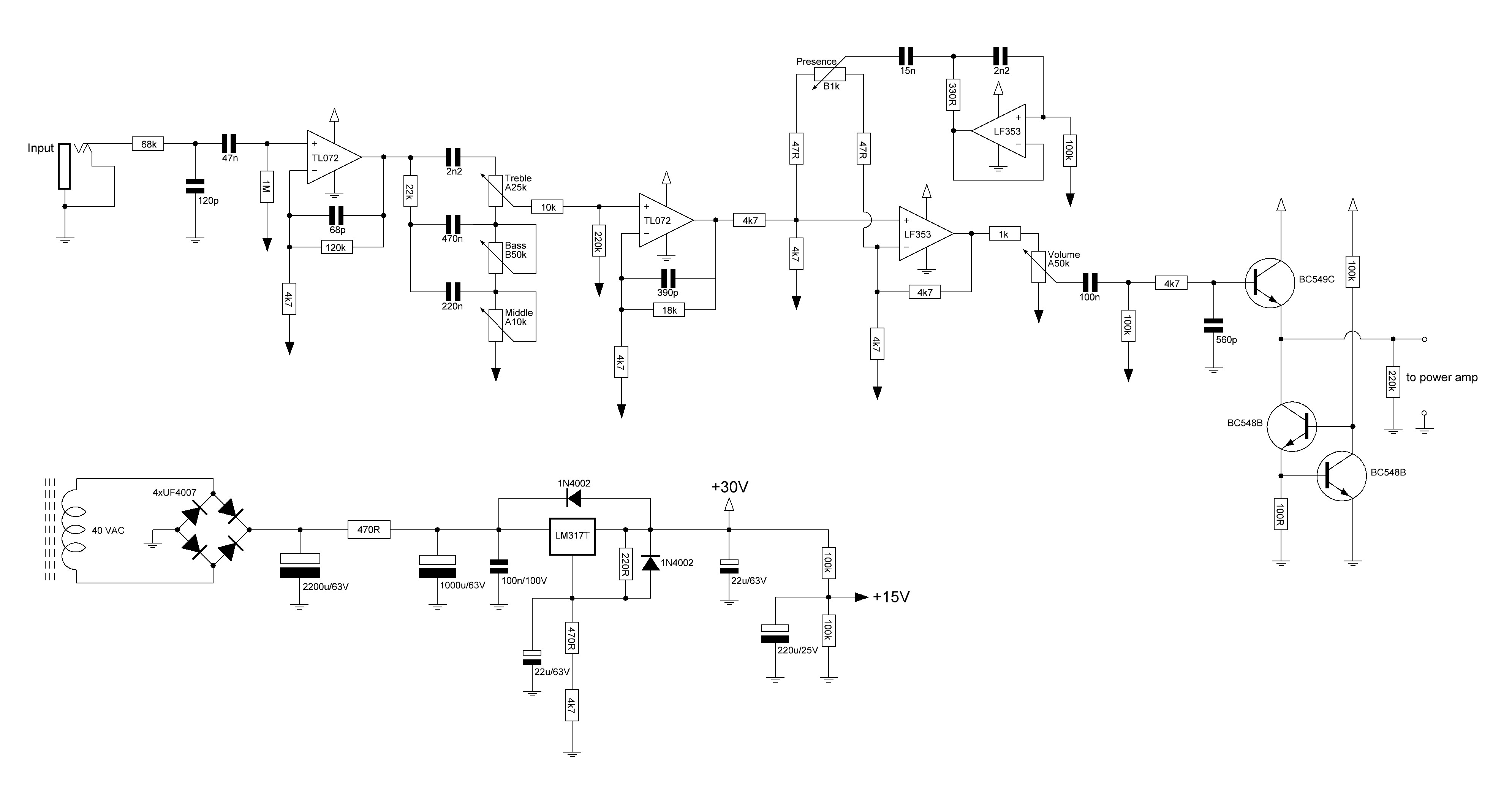

I am starting this thread to discuss a problem that occurred after constructing the guitar preamp shown in the schematic attached.
The preamp is fed into a transistor power amp - a JLH 30 watt design. It works pretty well, and is designed to have sufficient headroom for input voltages up to 1 Vpp.
The strange thing that happens (I posted it on another thread, but could not provide sufficient information) is that when turning on the amp, I can hear a subtle "charging" noise of several kHz, that lasts for some seconds and then goes. I say "charging", because it is clearly pretty much like such a sound.
I assume that an oscillation happens before the power supply is stabilised. I have made the following tests:
Does anyone have a similar experience or solution in mind? Thanks in advance!
- applied a 2.2R resistor in series with a 2.2uF tantalum cap across the +30V terminals - nothing happened
- turned all controls down - no change in the noise
- discarded the 220u cap - the noise became louder but shorter
- removed both the 220u and the LM317 supply, feeding the preamp through a 1k resistor connecting on the 1000u cap - same results as before
- short-circuited the power amp's input - no such noise could be heard, which persuaded me it came from the preamp
- simply removed the LF353 IC from its socket, without making other changes - no noise
I don't have much of a clue what the problem is, but after a little thought, a simple way to make sure the +15V voltage goes up proportionally with the +30V voltage is remove the 22u at the +30V output and put it across the top 100k divider resistor, and put an identical value across the bottom 100k resistor (of course removing the 220uF there). If you need about 22u across the regulator output, use two 47u's across the divider resistors.
the inputs to the opamps are outisde of the common mode range for a long time during turn-on. For the opamp to do what you expect, its inputs (both TL072 and LF353), per the data sheet, must be at least 3 volts above the negative rail.
The previous poster's suggestion would make that happen more quickly.
In the worst case, you might need some kind of mute circuit.
There are also some other ways to make the "+15V" rise more quickly.

Well, thanks for both answers! It seems to be a logical explanation that the behaviour becomes unpredictable until the 3V are reached, but I tried the instant rise by removing the 220u, and the situation changed, but not the way I wanted (see my first post). I will give it a try and have a look at the sites you posted too, when I find time.
Still it is weird, but the parallel rise in the supply rails should be given a chance!
I'm thinking the noise became louder because there was plenty of feedback through the unbypassed "ground" connection.discarded the 220u cap - the noise became louder but shorter
Looking again, it still happened because the 470 ohm and 1,000uF in the power supply slow down the power supply rise time substantially, to a large fraction of a second. Short out that resistor, and toss out the 1,000uF as well. The regulator will reject the ripple voltage very well on its own, and there's not much current (thus not much ripple voltage) in this circuit to begin with.

You might get quicker startup by replacing the two resistors/capacitor with a 7815 regulator. You should be able to retrofit it to an existing layout too.
There are a couple of alternatives - one is a symmetric supply. All this really requires is a transformer with either dual secondaries, or a centre tapped transformer. You can even make it with a single secondary, using half wave rectification which is good enough for a few opamps. Often you can get a plugpack supply with an AC output and use that.
Another is a virtual ground - this is similar to what you are doing, but usually with an active source such as a regular, or an opamp to create VCC/2.

Well, using an opamp to deliver VCC/2 was my initial thought to be honest! Just discarded the option out of laziness of putting another IC on the layout. 😀
I am also considering the 7815 regulator. Thanks for the advice! I hope I will have syfficient room, as you say.
I short-circuited the 470R resistor, but the noise did not go. Now I am going to try the regulator solution!
Tried the regulator solution, and it seems to be working flawlessly.
I discarded the 2x100k, 220u network and replaced them with a 78L15 regulator, putting in series with its input a 1k8 resistor to drop the voltage. I added 10u at the 15 volt stabilised output, in parallel with a 4k7 resistor to draw some current. Eventually it will not be needed, since about 2,5-3 milliamperes are already drawn.
So, no "charging noise"! I did receive a second pop on turn-up, coming from the preamp - sharper than the pop coming from the output stage, which is smoother. I removed the LF353 from the circuit to check it came from the preamp's new supply and was not a remaining of the old problem, and it was still there.
So, problem fixed for the time being! I am going to try fitting a soft starter to get rid of these pops. By the way, I am leaning towards using a simple soft starter published in Elektror Electronics - using a bridge and RC networks.
