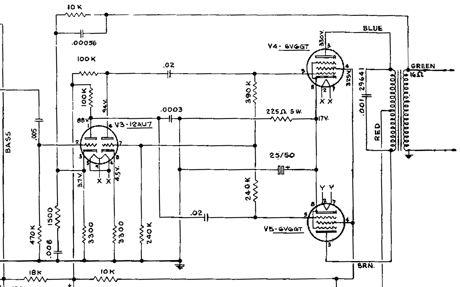

This schematic is modified from an old Bell & Howell projector amp for model 302 - PP 6v6's with a 12AU7 PI. Can anyone identify the PI circuit? It appears closest to "floating paraphase" to me.
My only complaint with this circuit is that I'd like more clean headroom/volume. Driving it with a guitar, I'm getting clipping at about 1/3 of the way up on the volume.
The clipping/distortion itself is pretty musical to me - that keeps me from switching to LTP or some other type of PI. But I'm looking to get a more "drummer friendly" volume from the amp without being slaved to a ton of crunch - idealy I would have a workable "clean" volume and then hit a boost pedal to push it into saturation.
I don't have all the specs of actual voltages and such to provide, but I did send a sine wave at 1v rms through the amp and found that the PI is distorting well before any Preamp stages - I don't even know that the preamp reaches saturation/clipping.
Basically, I really love to tone of this amp, but want more range of use and volume.
What can I change in the PI circuit to get more or to reduce clipping?
