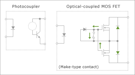

I have seen a schema of optically coupled MOSFET ciruits, as a solid state reay. I saw that Renesas has astory line about isolated mosfet drivers. Some vendors focus on 100kV switching. . . But we need automotive quality like Toshiba's TLP570xH IGBT & MOSFET Isolated Gate Driver.
While this picture assumes the mosfets are inside the package,

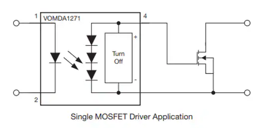

the following is a driver that needs external Mosfets: VOM1271.
Just. Four pins!
Drive a single or back-to-back N-mosfets (sources combined).
"Unlike conventional MOSFET drivers, which require an external power supply to provide VCC and or VDD rails to the driver itself, the VOM1271 obtains all the required current [=voltage] to drive its internal circuitry from the LED current on the low voltage primary side of the isolation barrier." The cell generates the voltage to turn on the mosfet, up to 8.4V.
The essence is that the driver signal is totally isolated from a power line. useful for switching power lines. Or. For instance as speaker relay, as it can handle AC. They handle 40A both ways. With <5mOhm resistance, and "<-90dB distortion".

An example of a driver that is isolated, is: VOM1271 (Vishay) = Photovoltaic MOSFET Driver With Integrated Fast Turn-Off, for Solid-State Relay. There must be more.

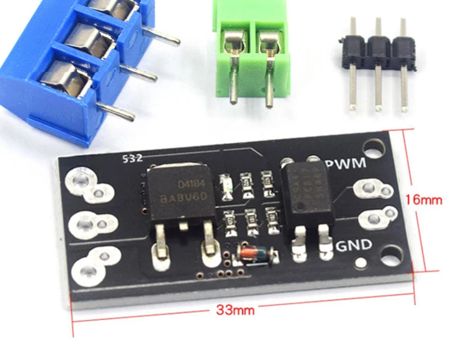

+ I found an almost complete board, not yet totally to my liking (it is single switching direction, not bidirectional such that it is useful for AC/speaker or as a relay on the negative rail but more on that); the optocoupler is a Sharp PC817 as far as I can read the picture. Other offers exist! See a 10-pack.

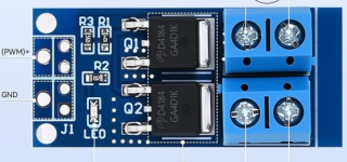

One can now bricolage a back-to-back second lr7843 mosfet (connecting the sources and gates together, the drains being ad-hoc/simultaneous in and output so it handles AC and negative rail . . .
