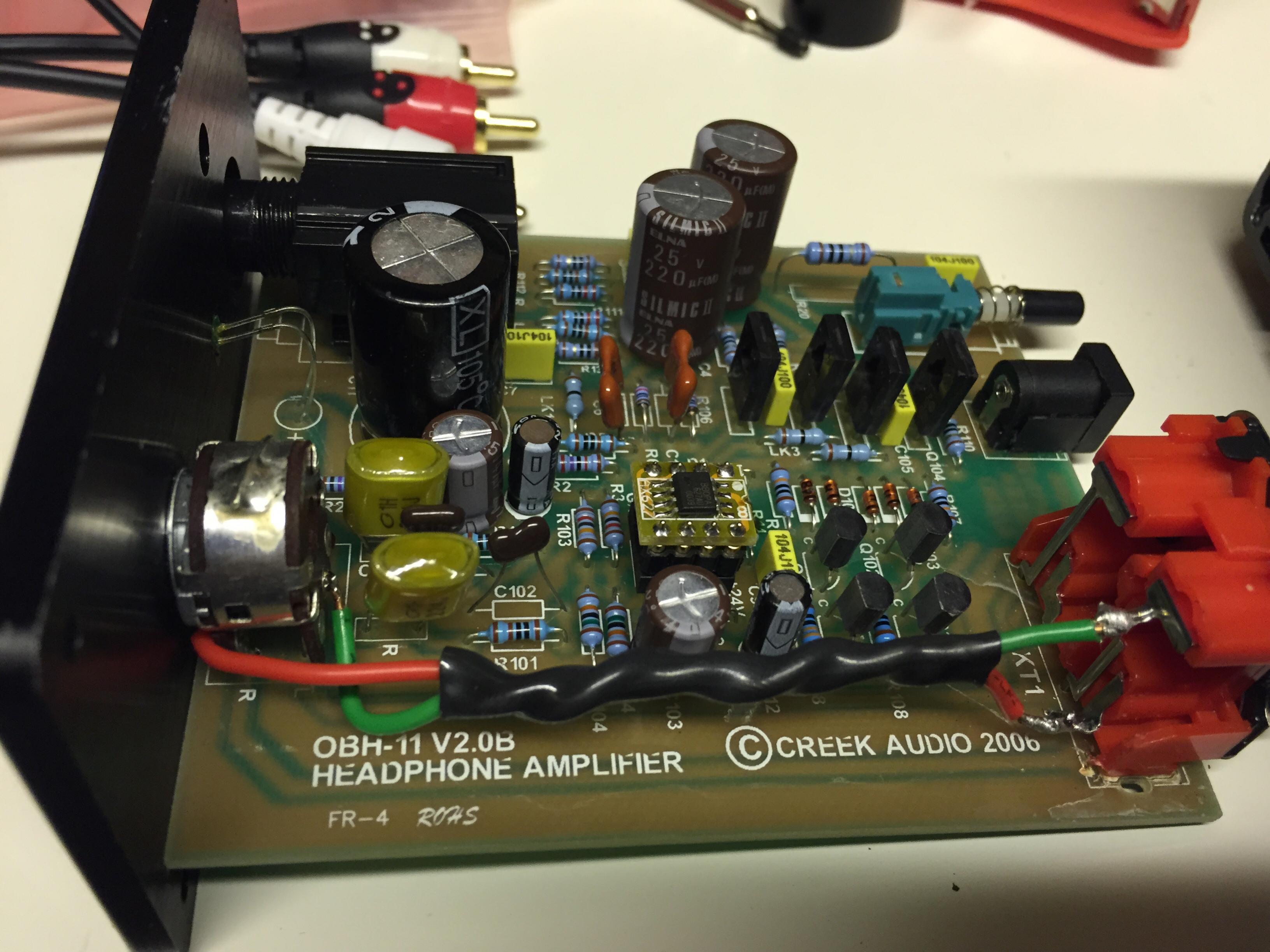

I've modded my already modded OBH-11 to act as a preamp as well as headphone amp. It was simple mod and I'm sharing it here because I couldbt really find anyone who had done such a thing. This mod allows me to use my Creek as a stand alone products rather than wiring it in-line between the amp and pre or source and pre. I simply cut the positive leads on the RCA output and bent them up. I then wired the positive leads to the positive Right and Left outputs of VR1. It sounds great and because it's truly passive, it works when powered off.

thanks for post, just digging around and found this. did you have any instructions on this, or just know how and what to do from other experiences?
awesome! Do you have any other images or additional instructions (I want to make sure I get it right)? I plan to make this modification, I have an OBH-11 I plan to use as a preamp for my recently assembled Amp-Camp-Amp
