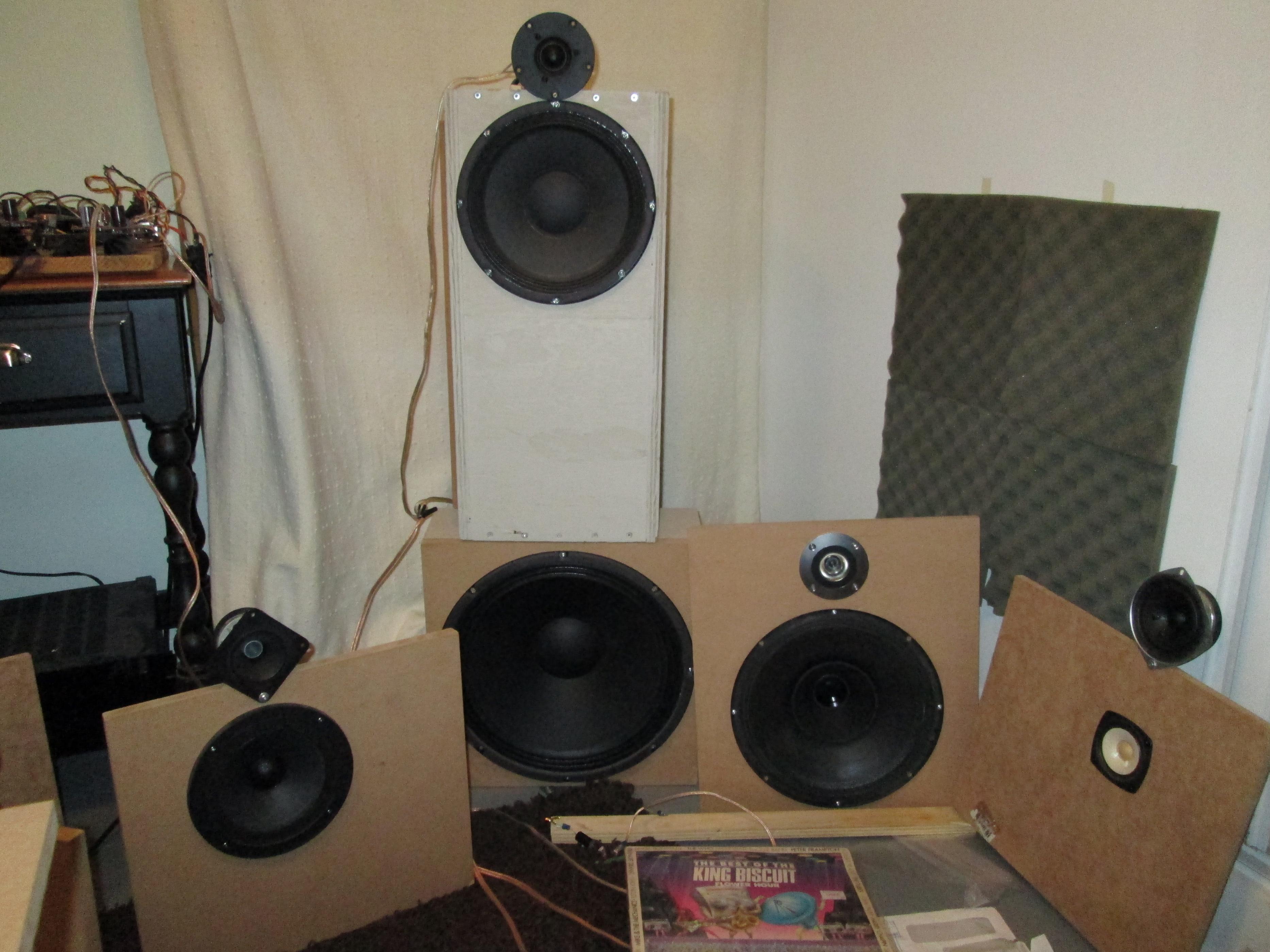

Nelson liked the Beta15 as a good balance of cheap and cheerful.
(I remember a massive 2x beta (passive) with a Lowther on top, can't find ...)
So did Martin.
www.quarter-wave.com/OBs/OB_Design.pdf
So do I:
http://www.diyaudio.com/forums/mult...-tool-real-time-dsp-crossover-adjustment.html
