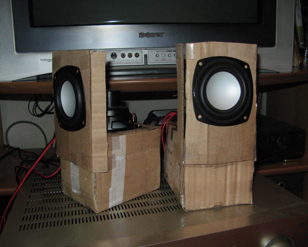

After messing around for a month, my Aurasound drivers came. I made a cardboard test cab for them, and I proved that the rear radiating wave can be effectively cancelled by a separate driver placed perpendicularly by listening to the space between the two drivers.
There was buzzing from the poorly made cab, but I still found excellent spacing and imaging with this set of speakers. BTW, they are meant for close field listening and not blasting, so don't feed them with extremely loud music. Anything with heavy bass with a sound pressure level of above 96dB is not recommended as this may bottom out the drivers.

I assume you'll be building a "proper" box for them, so (for the purpose of experiment), would you consider trying ported vs sealed on the rear driver?

Chris, I think I'll make a proper box with 1/2" ply wood with bitumen pads inside. Porting the driver would create a nasty steep roll off around 40Hz and I'm aware the power handling problem. There's bass, but you'll need a 6dB bass boost to make them sound like 6" woofers.

Yup, Tekton tried to get a patent, but it's still patent pending, so feel safe to use it for personal use. BTW, I believe this is a bit different from Tekton's patent, and to twist the design a bit, I want to try use a transmission line for the cancellation driver.
Anyway, they sound very spacious and vocals are excellent. It reveled that Madonna's albums are DSPed with some phasing tricks and as these speakers are highly directional (real monopole bass), it sometimes sound like "out of the head".

Boris, the transmission line idea is fantastic, provided it's long enough to give a near-infinite baffle loading to the driver (correct stuffing should help this).
Have you crossed the rear driver over? I found 2nd order LP around 400Hz good on my design a while ago.

I did not use a single filter. I just inverted the cancellation driver to limit the treble from the cancellation driver. For those who hate reactive elements, this is a good thing. 😉 But I still think I can try adding a filter.

... But you don't listen to the space between the drivers. What do you hear when you set them up in a "standard" listening configuration, then switch the rear drivers on and off? Then switch the front drivers on and off while leaving the rear drivers on?
My point is, at the frequencies for which the rear driver is supposed to be effective at back wave cancelling, I suspect you will find that the majority of the bass you hear actually comes from the rear driver.
I don't honestly think this design idea makes much sense. WIth such a small baffle, unless you sit within inches of the front speaker cone, the low end is going to be totally dominated by the box woofer. You may as well make a true two-way, or 1.1, you might call it. Besides, what you really have here is mainly a passive radiator tuned to a few hundred Hertz, lol.

@Don Hills: I have small ears so I did actually listen to the space between the drivers. There's absolutely no bass from the rear, and bass is really monopole in this design. The mids and treble is dipole as it's not as effectively cancelled out.
@Andrew, I didn't think it would work, but it did work. No passive or active components, no crossover. There's no bass from the rear. Close-to-wall didn't help a single thing in this design, it messes up the mids.

I trust your statement about the mids. That scene is probably pretty complicated. However, you're still certainly dealing with an overall monopole woofer, created by the driver in the box. The monopole will seem to appear at the front cone, but it will be dominated by the box woofer response.
@Andrew, but there's absolutely no bass from the rear... I can't figure it out... Maybe you can treat the OB as a system and the box as another system, then you'll end up with the conclusion that bass is from the boxed driver, but if you treat the front as a system and the rear as a system, you'll end up with my conclusion. I think we need some one with a PhD in Physics or acoustic engineering to solve this problem as we cannot "label" waves like we do in chemistry.
But anyway, the truth is there's monopole bass, unlike what some suggested. It's a funny experiment, and you've got to listen to that. Who said bass must be omni-directional!
Noo, no PhD, the bass is not that hard to figure out. Thinking ideally you just have two cones moving exactly as much but opposite in the back. No sound. So the monopole appears at the front cone.
Unfortunately the cones aren't moving exactly the same. And since the dipole cancels at very low frequencies in exactly the same way, except for slightly different compression levels of air because of the box sound pressure, you are left to listen to the box woofer at more than a few inches from the front cone. No big deal.
