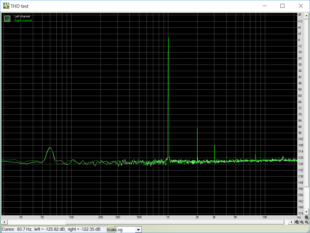

I have measured Agdr's Super CMOY 1688 at 700mV and it does quite admirably with a nice harmonic profile of mostly H2 and a little H3 and not too much of other stuff, although H6 and H8 start to rise up. Agdr's design has no buffer - just a straight opamp. The power management on the Super CMOY 1688 is exceptional though with rail-cut MOSFETs controlled by a comparator. Turn on thump is suppressed with dual MOSFET latch, which also serves to shutoff quickly to prevent turn-off thump.
Here is the measured FFT at 1kHz and driving 270R load at 700mV (as measured with Focusrite Solo 2G at 96kHz and 24bit):
It's puzzling why there is a small bump at 60Hz as the amp is battery powered as well as the laptop and audio interface. Same interface on my Pocket Class A has no 60Hz bump.
By contrast, your measurement of the O2 FFT almost looks like there is some mild oscillation going on, albeit at very low levels as the FFT is kind of lighting up like a Xmas tree forest with all those higher order spikes. I wonder if a compensation cap(s) may be off. I had a similar experience on the Super CMOY when I ran it temporarily with 10pF comp caps instead of 47pF compensation caps. Or is is simply the AP gear is able to reach down into the -150dB noise floor so the "trees" look taller?
No oscillation was observed on my 400 MHz o'scope.
I bought the amp directly from JDS Labs. If the compensation caps were off, it would be because JDS didn't install them. That would violate the licensing agreement of the O2, so I have full confidence that all specified parts have been installed.
The -158 dBV noise floor of the AP should not affect the absolute magnitude of the THD components. They may look taller at first glance, but you need to read the graph to compare. The reason the FFT shows a lot of harmonic content is that the O2 provides a lot of harmonic distortion at that operating point.
