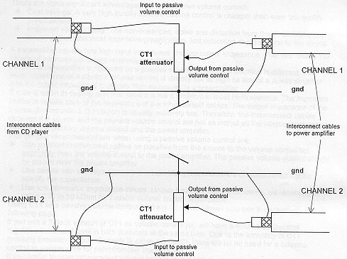

Anyone knows what resistance one should use as passive amp for the Forte Model 1 Power amp?
I've just connected 2 Volts CD-Player through 50 kOm potentiometer (500 - 2M Ohms total resistance) --- signal in incredibly low!

I think the model 1 input impedence is 47K and input sensitivity was like 1 volt or less for full power output so shouldn't be a problem with a CD player. Make sure your pot is hooked up right.
2M total resistance measured!
How have you wired up the pot and how did you measure that resistance?
A 47k input impedance would work better with a 10k log pot.
schematic i used was like this:
i didn't measure any resistance yet, i read it in manufacturer's datasheet.
"Total Resistance 500Ω ~ 2MΩ"
thanks, i'll try 10k pot tonight and compare!

!! thank you all, i've solved the problem (cables were pseudo-balanced, rewired now). WORKS!
but now it's too powered. i can use just about 20 degrees angle rotation for non-extreme volume adjustment. ( 50K potentiometer )
