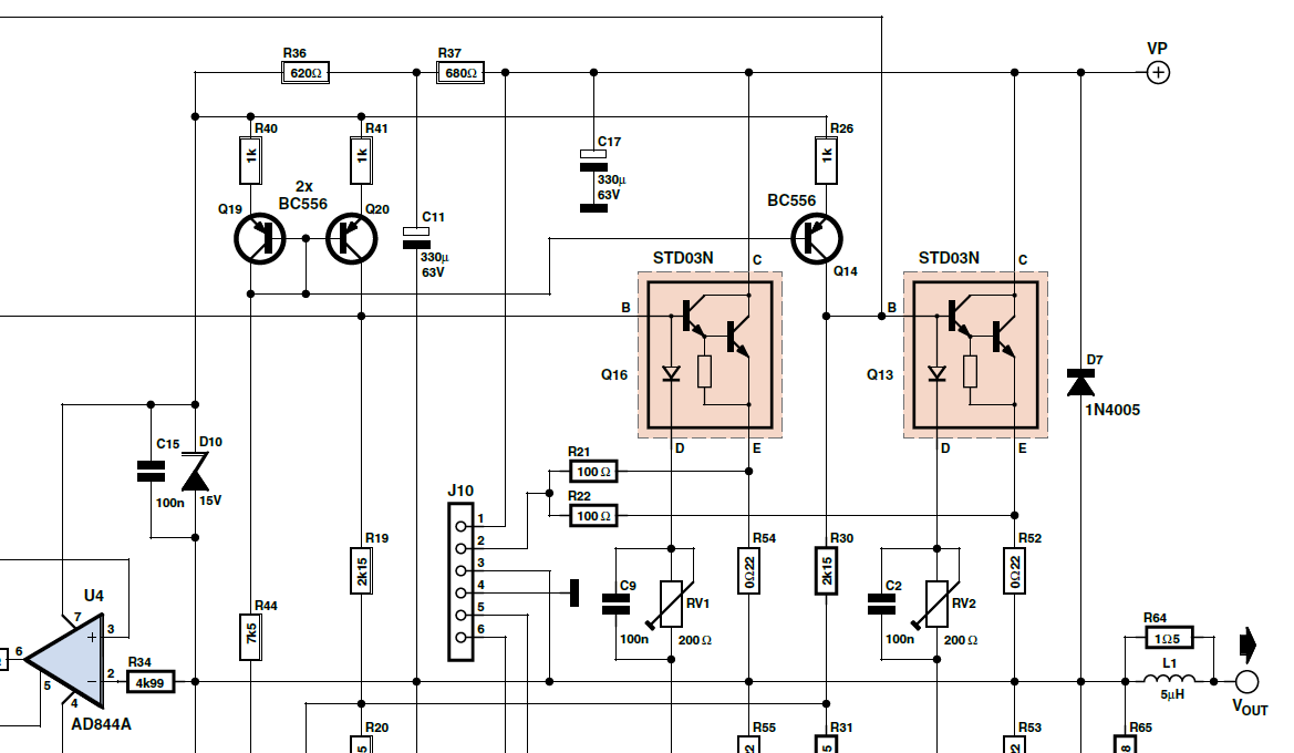

There's nothing wrong with the idea, it is the basic voltage controlled current source. The need for floating +/-15V supplies is a disadvantage but easily solved: supply the opamps through a pair of resistors & zener from the main supply, and bootstrap the resistor midpoint from Vout.
Edit: I see abrax mentioned the bootstrapping too. The cap load is much lower than the value of the cap because it will be in series with a highish resistor. I have used it in my paX amp with very high values, see C11, R36, R37, D10, in the attached, with no issue.
This gives you +/-15 floating on the output voltage.
Jan

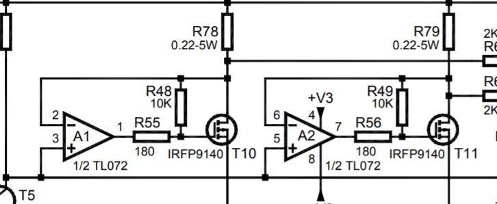

I believe the Vellement K4020 amplifier kit used this approach
https://www.velleman.eu/downloads/0/manual_k4020.pdf
I think the PFETs T10/11 are wrong drawn, Source and drain should be exchanged.
Seems likely. Note that the Vellman design runs the current sources referenced against the rails not the output, but yea basically the same idea.
The cascoded 061 as an input stage is a nicely weird touch, especially love the way the feedback is organised!
Not too sure about 071s as mosfet drivers, I would have thought something with a rather beefier output current capability would be better.
You could take the Velmann variant and diddle it just a little by putting the load in the ground return to the power supply, and floating the caps, rectifier and transformer, upside would be that there would be no need for insulating washers on the power devices (Effectively ground the output node, seen that somewhere? Carver??).
As to the capacitive loading that is what the little clutch of passives is about, the gate resistor isolates the opamp output and the little cap shifts the feedback to before the big mosfet at high frequencies, we will see.
