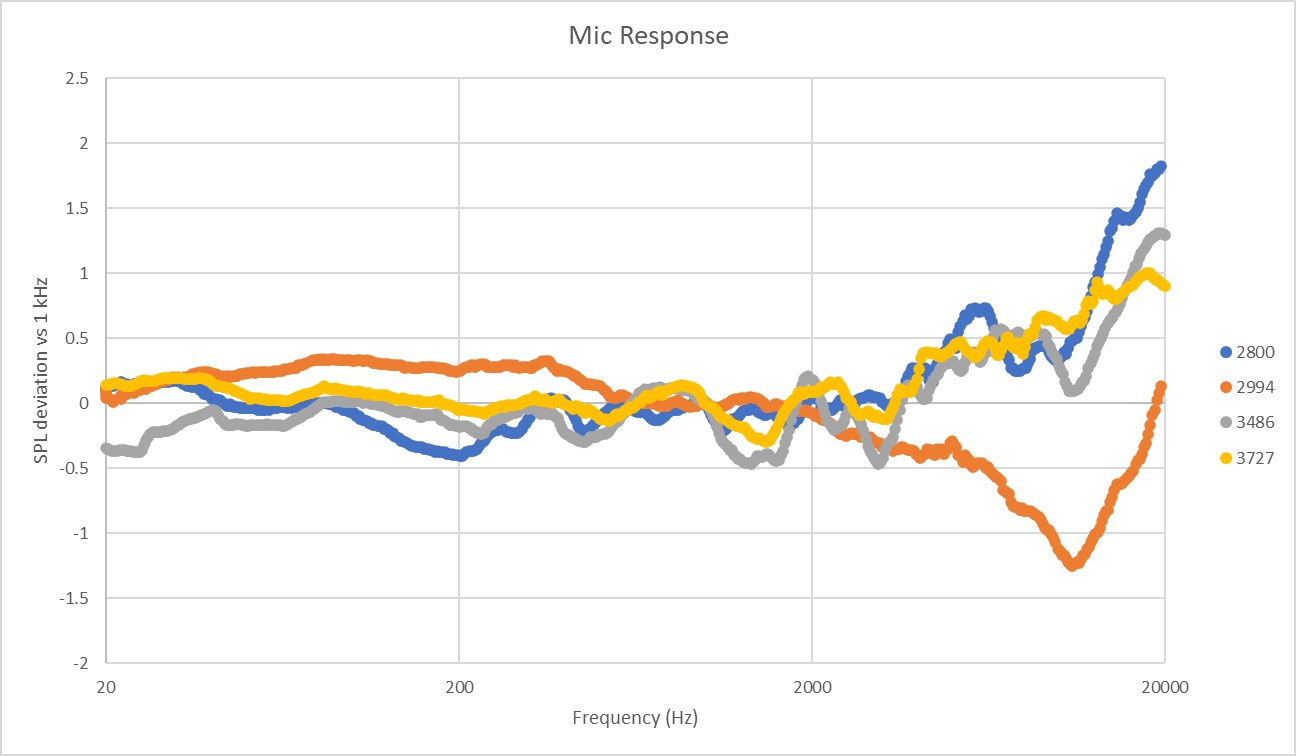

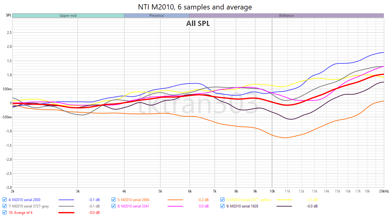

I note that you have two samples with the same serial number of 3727- Is this is a typo?
In combination with 1 other user @ ASR, thanks to your data, we now have 6 random samples of the NTI M2010.
They are all within +/- 0.5dB from 20Hz to 2KHz.
Above 2KHz, they have slightly higher deviation.
I've auto-traced and plotted these 6 samples on one graph, and also the mean deviation (red)

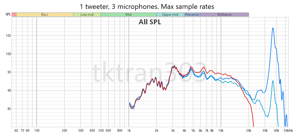

My hypothesis is that these tweeters have useful ultrasonic response above 20KHz. This undocumented feature may serve useful for people working / designing with hard dome tweeters:
eg. The same aluminium dome tweeter measured by 3 different microphones: Umik-1 (red), Sonarworks Xref20 (light blue), Earthworks (blue).
All microphones are calibrated by their manufacturers to their specified limits, but only 1 microphone shows the high peaky resonance of this tweeter, which would benefit from a correctly implemented notch filter.
Thanks to other users @Joseph Crowe & @DcibeL we should be able to confirm in the coming weeks whether this NTI M2010 has usable response to 40-50KHz.
