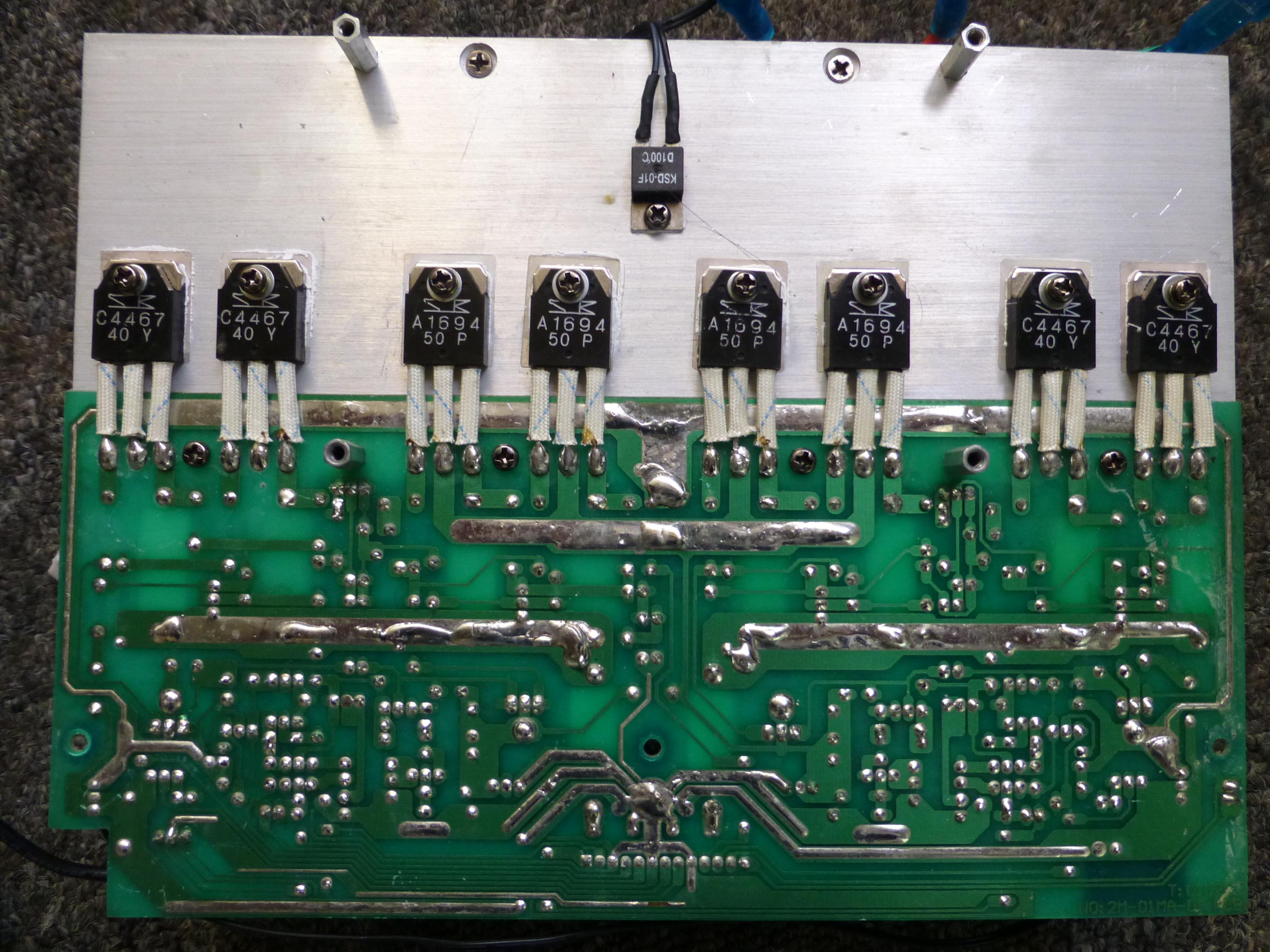

Just a quick question. I thought I fixed my amp but NO....
Now have to change some NPN Mosfets out...

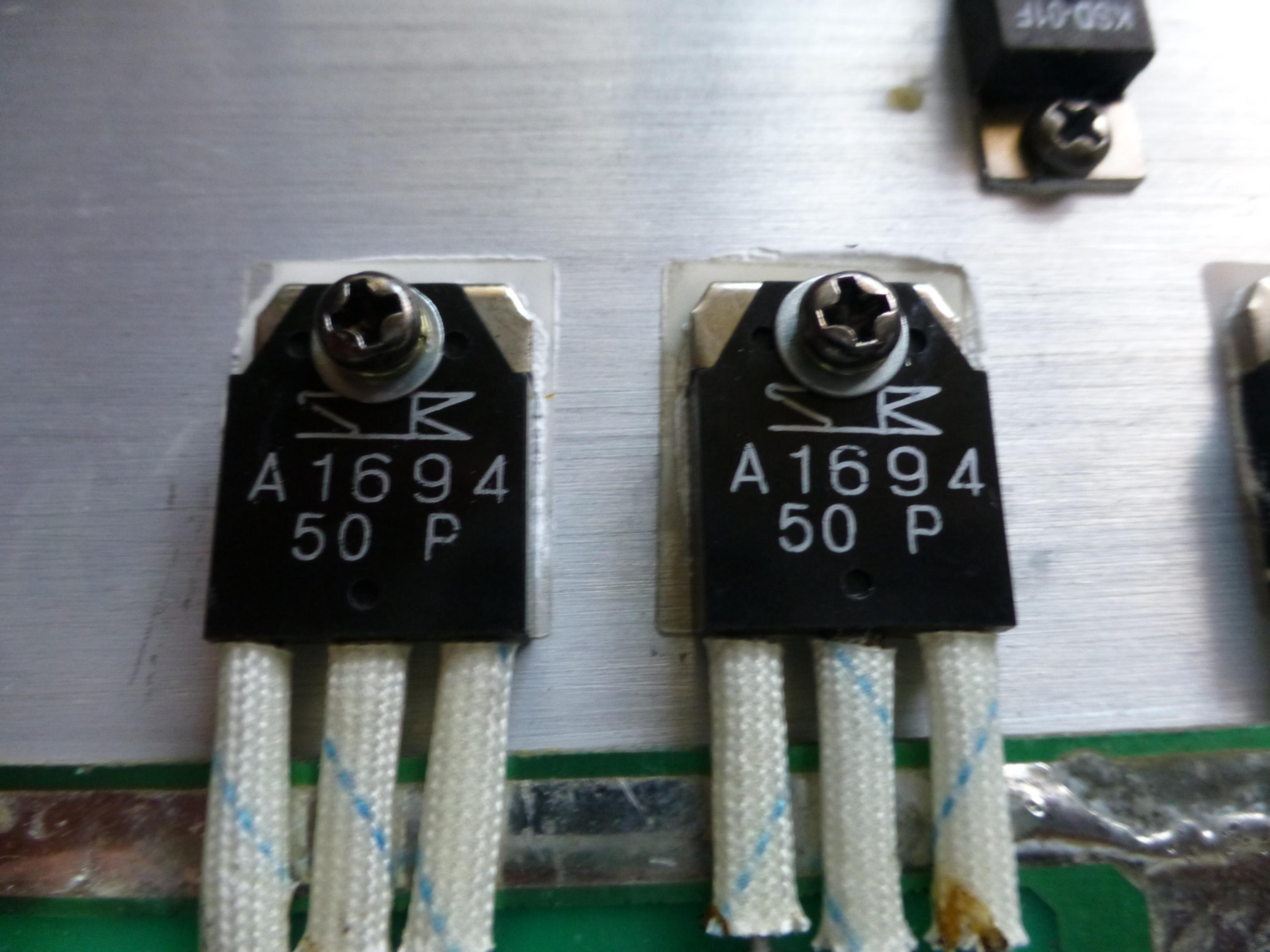

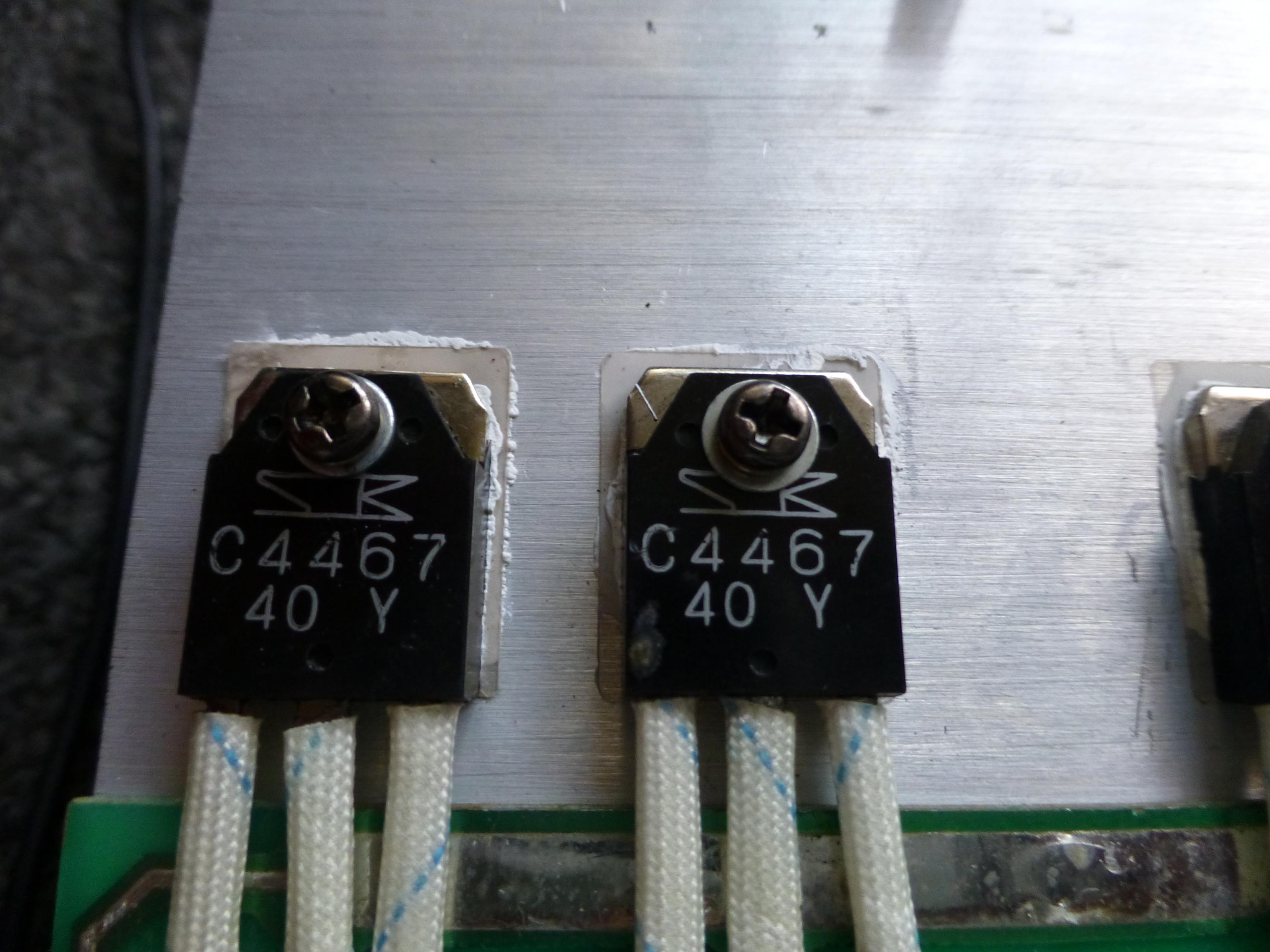

Question is, I presume they are output and input as, one reads something and another something else...
One is: C4467
Then under that it reads 40 Y (looks more like a "V"
Then: A1694
Under that: 50 P
I've found a few Mosfets, but they read 00 Y, not "40 Y" just 2 zero's
Is that right, or?

the parts you are dealing with here are not MOSFETs, they are Bipolar junction power transistors.
2SC4467 NPN type and 2SA1694
the letters signify the hfe (gain) groups
0 = 50 - 100
P = 70 - 140
Y = 110 - 180
i would go with either P or better Y types making sure that they are both of the same kind in the same channel of your amp.

By the way, 4 of them are leaking, where they should be Open Line, they ain't...Rather, just stuck in the on position, looks like I might have to replace them all 🙁 4 are labeled A1694 and the other 4 C4467

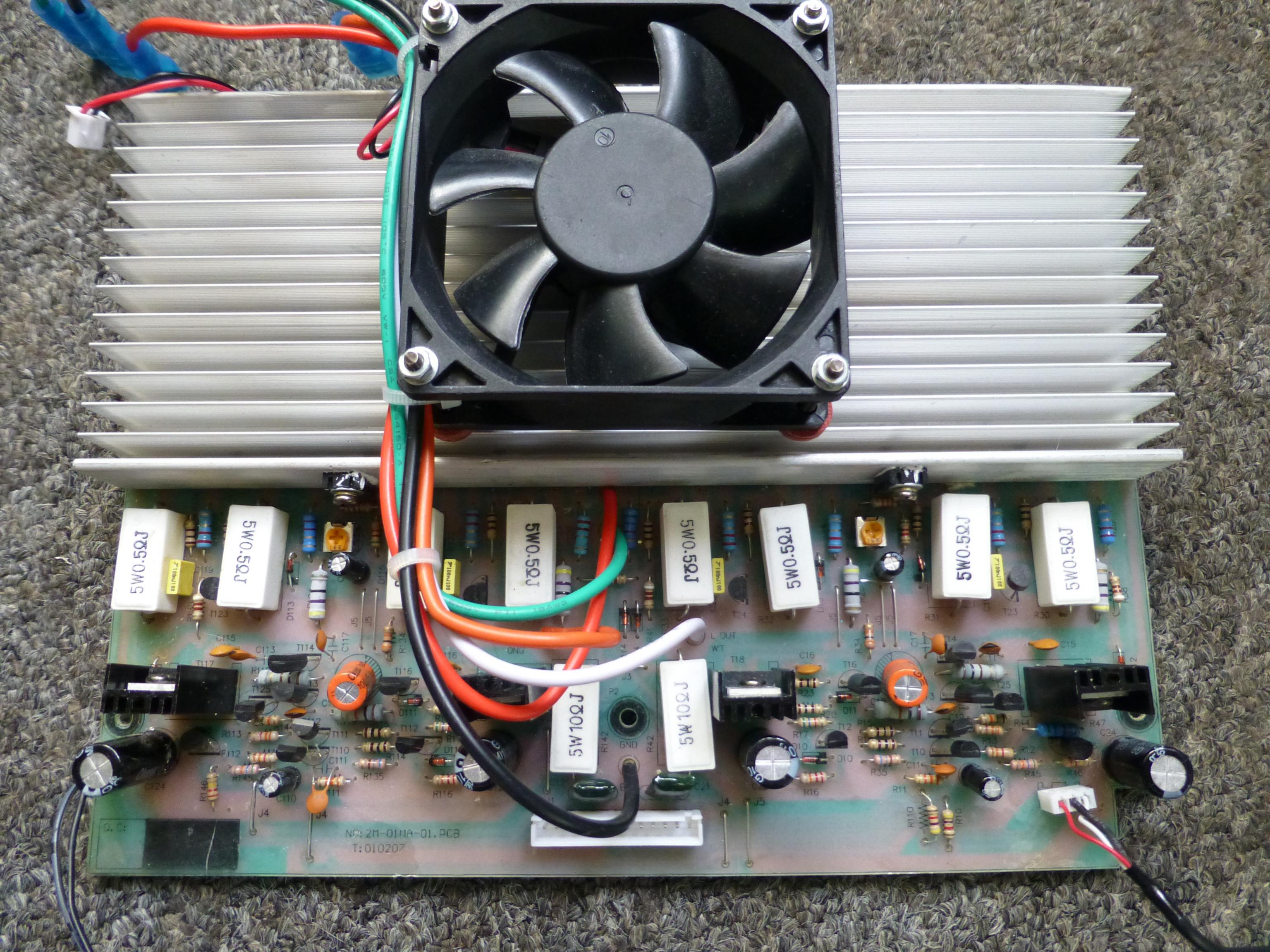

Here are the pictures bob 🙂

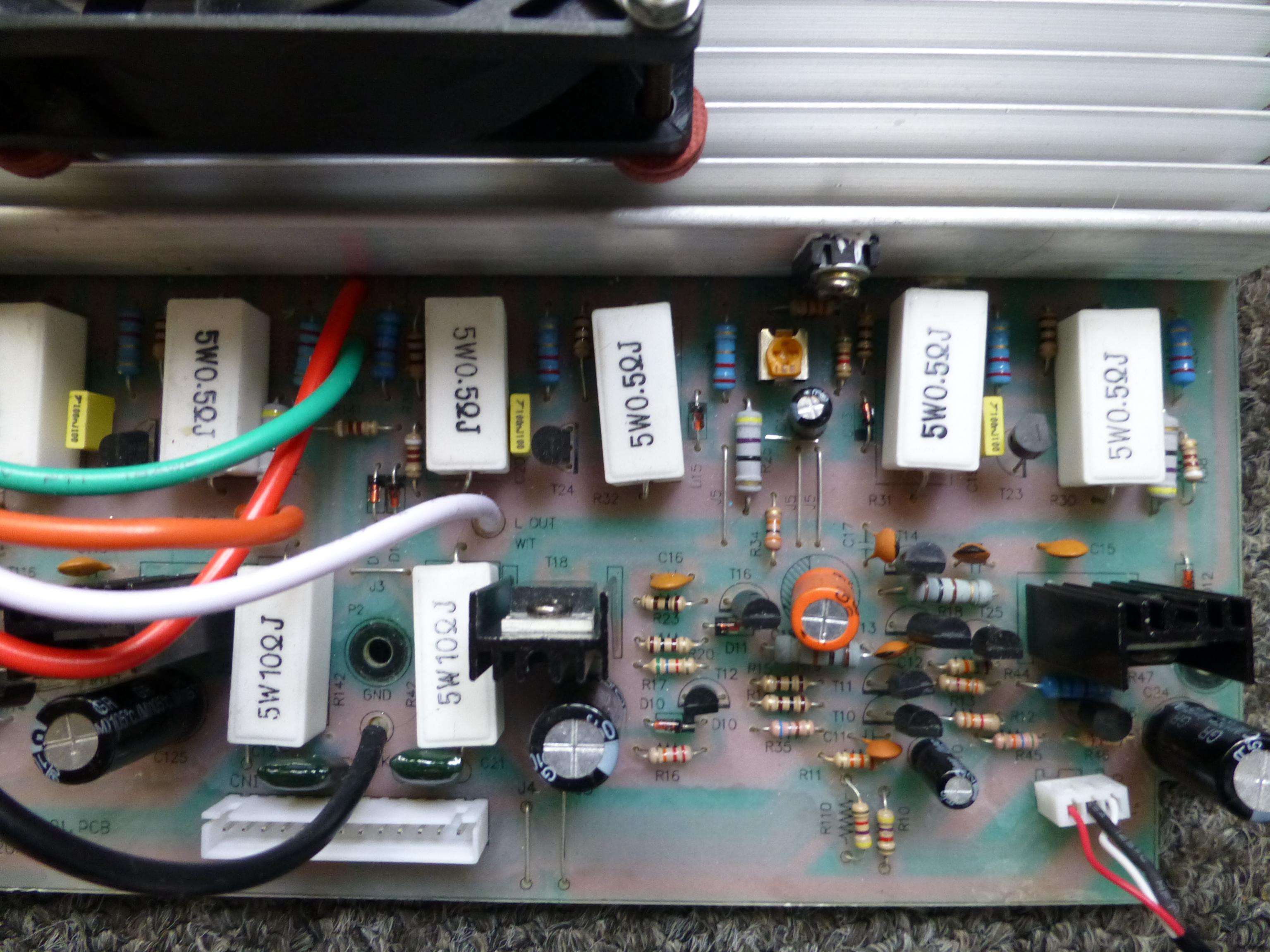

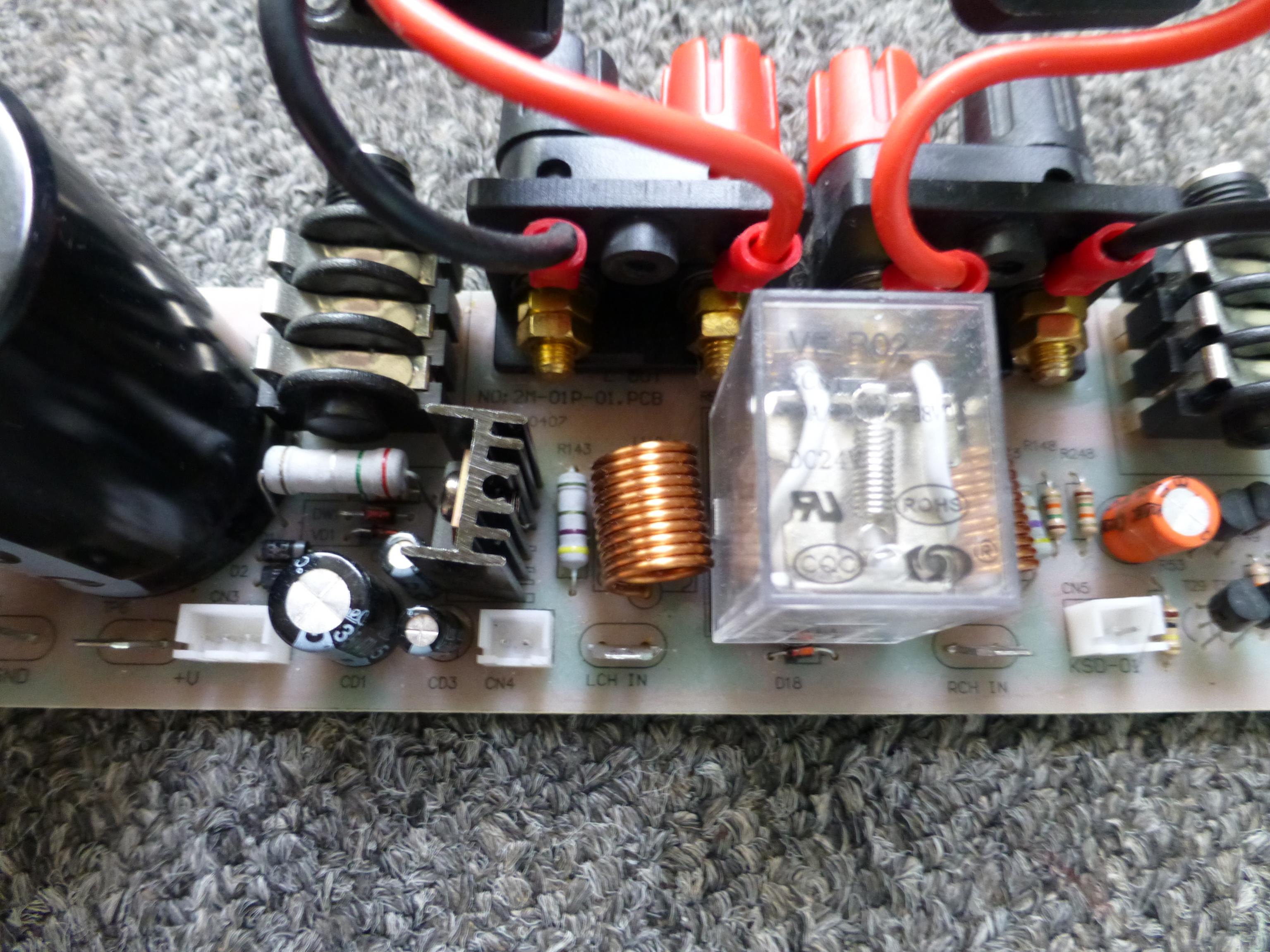

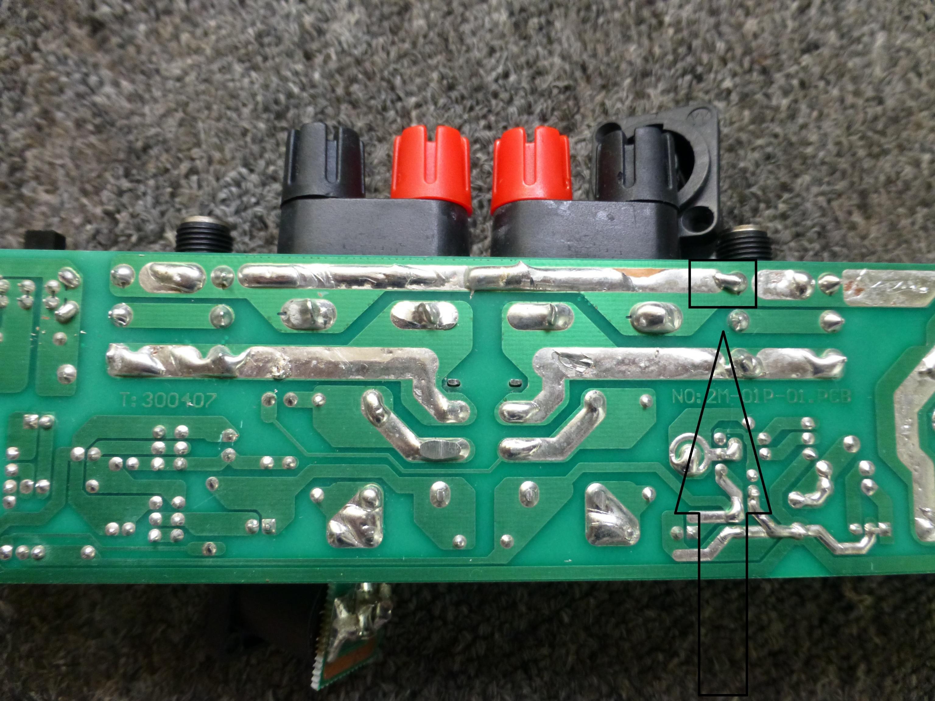

Just a little extra, what it was! doing, was the power protect would always come on when it was powered up, then if I removed the internal speaker terminals from the power board it wouldn't go into protect (it would for a split second on power up) then back to normal. I tested if there was any dc voltages, none, no resistance either in the speaker terminals, yet, as soon as I put the multimeters needless into the + and - of the external speaker terminals (with the internal amp terminals not connected) it would go into protect again.... So odd! no burn marks anywhere! all the caps read fine, except 2 that are weird, 100uf, but read as 125...
The ONLY thing I could see was, you see under the circuit board for the speakers (on the power board) not the main terminals, the far outside one's, the bit of solder that is touching the other solder and to the left it is not touching, is that a short? Or meant to be like that?
hi there
the bottom of the board where you indicate looks ok.

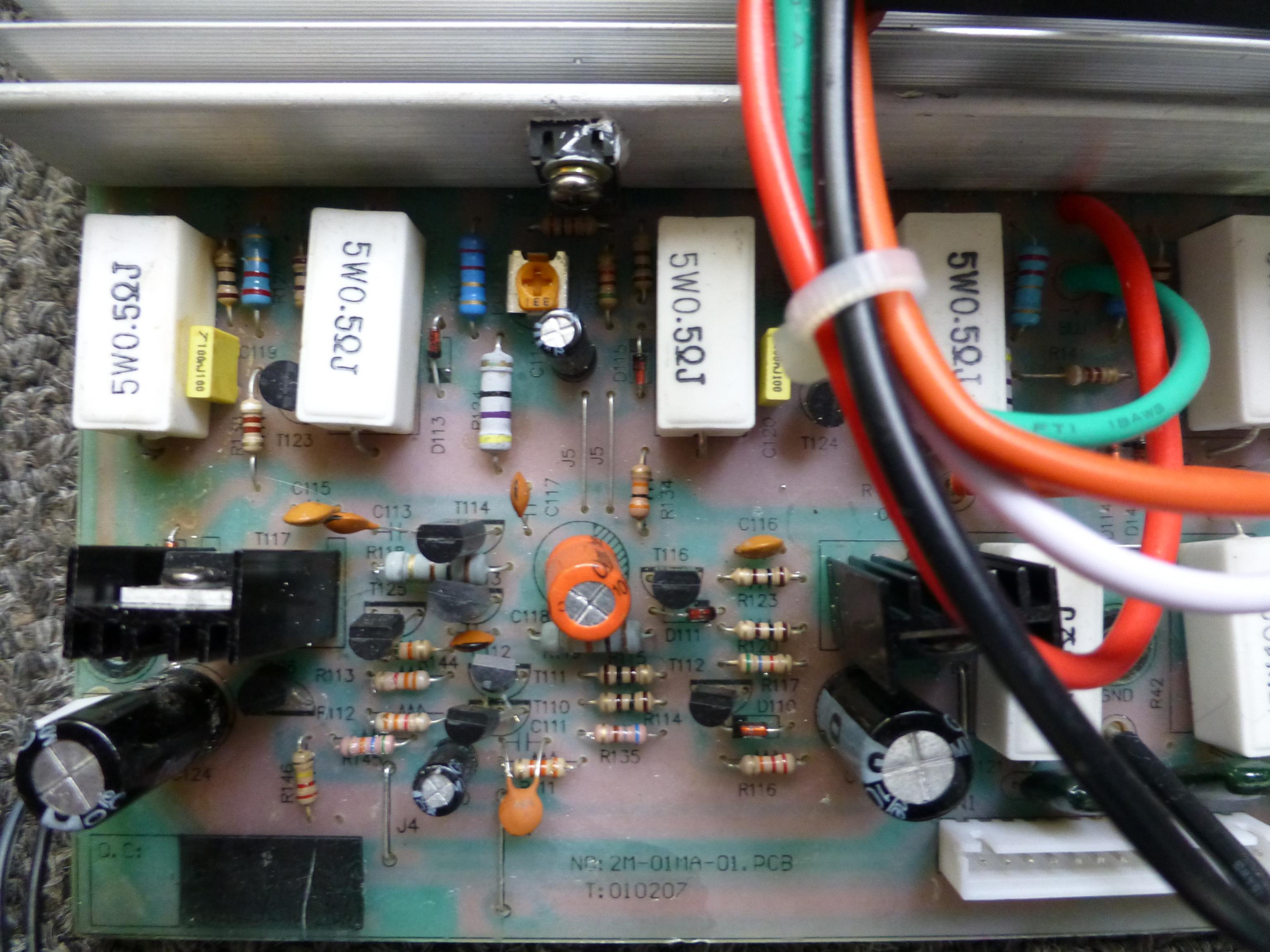

with the amp connected through a series test lamp on the mains 60 watt about right. all connections connected on output /protect board nospeaker no load.
power up and measure DC voltage from ground to to output of the amp before the output board this point is at the junction of the power resistors the big white ones,5watt 0.5Rr. looks to be the white and orange wires. check both outputs what are the readings?
