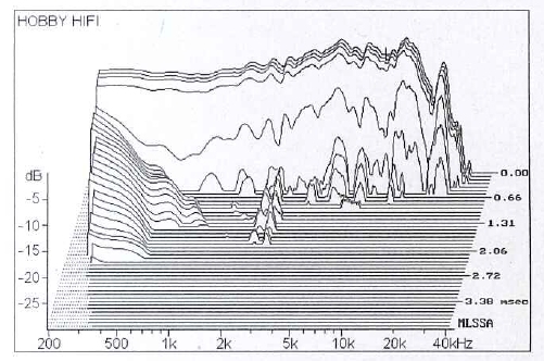

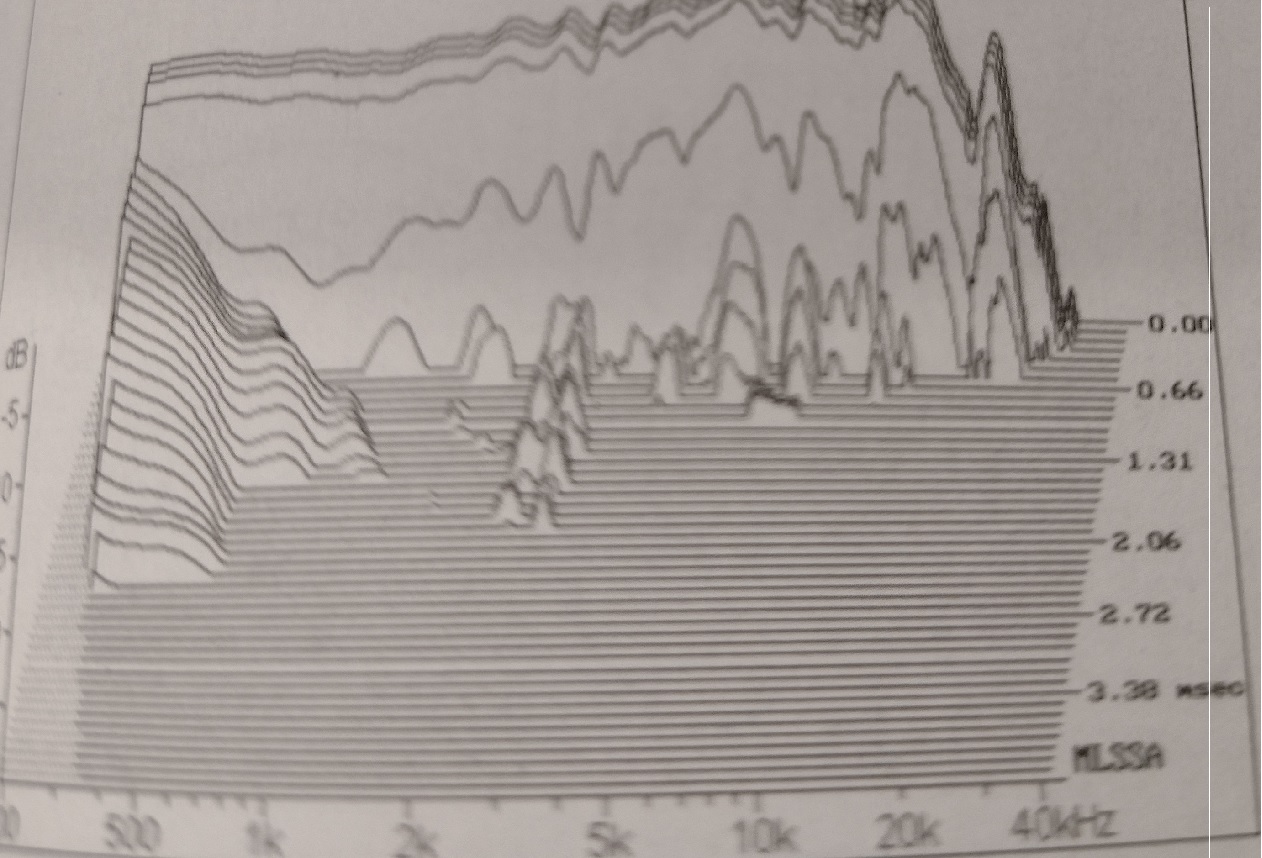

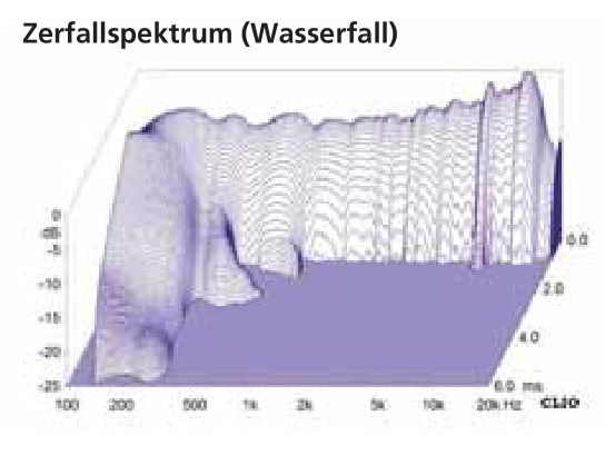

I am evaluating the 10F 8414 for my speaker build, so I gather four third-party measurements of this driver and compare them. Those measurements are Klang+Ton 5/2013, HobbyHifi 3/2015 and Voice Coil December 2013 (available on AudioXpress Test Bench - Scan-Speak 10F/8414G10 Small 3.5” Full-Range Woofer | audioXpress ) and Erin's measurement ( Scanspeak 10F/8414G10 Discovery 4 inch Fullrange )
The frequency response, Impedance curve and distortion plot of the first three measurements is very similar. But the CSD plot is a bit different. Hobby Hifi & Voice Coil measurements show a resonance at 2-3 kHz up to 2ms, while this resonance is absent on the measurement on K+T.
Another problem is when comparing the THD plot of first three measurements with Erin's measurement. On the first three tests, the THD has a small bump at 1-2 kHz, ranging from 0.5-0.7% at 90dB SPL (on Hobby Hifi) to 1.25% at 95 dB SPL (on K+T and Voice Coil). On Erin's measurement, the THD is below 0.3% at 96 dB and even smaller at 90dBSPL.
I think all of them use IEC baffle to test, but their results are somewhat different. As a novice in speaker measurement, I don't know why it happens and which measurement I can trust. I am very grateful if experience people can help me explain it.

CSD plots have many variables that influence what you see in them. 2 of these plots have a rather short rise time, which shows the frequency response as a sort of cliff. (cutting it short)
The graph from K&T, that is more rounded in shape has a longer rise time which shows the data as if it were taken a little later in time. Basically hiding that early view.
The Hobby HiFi plot...
If one were to EQ these bumps around ~2K flat, that resonance would likely disappear. You can see it in the Frequency response as well. But it's there in the driver. I won't comment on what's causing it but at some point a wide band driver changes it's behavior from piston to more of a controlled break up to be able to play up high. Basically the higher it goes in frequency the part of the cone that plays the frequency changes (gets smaller) due to flex in the cone. The 10F does a remarkable job of creating a flat, though slightly rising response.

The little ridge is over 20dB down and only lasts for a handful of cycles at 3kHz. You won't hear it, don't worry about it. The frequency response not being perfectly flat at 0ms will be far more audible.

Your explain about CSD is very helpful. I am too careless when not noticing different between the scales of time-axis on CSD measurement.
