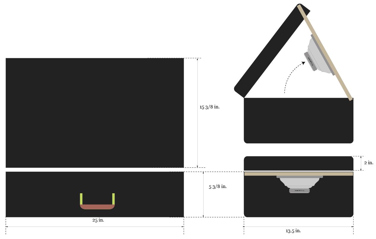

I'm working on building a suitcase instrument amplifier and I need some advice about the actual amplification circuitry. Here's the deal:
The amp will be built into an old suitcase I found at a flea market. The design I'm thinking of is a front panel that folds up from the inside and catches on the lid, not unlike one of those travel alarm clocks. the front panel will have two 8" speakers, right now I'm looking at Jensen's C8R (25 watts each, 4/8 ohms) and a VU meter or two for good looks. I'm attaching a diagram.

interesting idea. if your keeping it clean you wont need much of a preamp, a TL072/TL082 opamp would work fine. you can do plenty including EQ and volume with that. as for power stages ive only ever used a TDA2030 (around 10 watts) but theres probably a few push pull power stages using darlington transistors or MOSFETs. Theres some schematics around for some solid state marshall amps with these stages. as for mains power, a 15-0-15 2A transformer should be plenty. Im not sure about the speaker being completely open when flipped up. it will have a similar effect of not being mounted in a cab at all. not only that, wouldnt the open design leave the electronics out in the open? might be a bit risky if someone drops a pick in there and accidentally grabs some mains voltage...
No, you want to keep the suitcase closed or at least mounted on the bottom of the case if the lid is opened up any. If you wanted tilted have the amp sit open with the lid and the box siting on the ground, this will give you an idea of what I mean.

I like the idea of mounting the speakers on a baffle that folds into the suitcase - I plan to steal that for a project someday! To keep it cheap, you might browse Ebay for solid state amps with trashed cabinets or without cabs. I would suggest looking for something that has a decent sound to begin with - maybe a Yamaha GS or Peavey Bandit. Most DIY solid state guitar amp designs tend to be kinda crappy for anything other than squeaky clean amplification (think acoustic or some jazz) - the trick to a good sounding guitar amp is introducing at least small amounts of "desirable" types of distortion to the signal. Another thing you might try is to use a clean DIY power amp driven by a distortion "stompbox" - maybe a Bad Monkey or Boss DS-1 (both good sounding and cheap).
