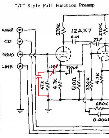

I'm probably overstepping my valve expertise here, but doesn't the 100pF capacitor Grid to Cathode need to be changed to 47pF shunt to ground. Otherwise, won't the cartridge will only see a tiny fraction of that 100pF for its required load?

Ehh .. now that I look closer at the feedback network, I'm probably wrong ..

Low pF grid to cathode is great at killing RF interference (because you are shorting a dangerous RF rectifier/detector diode) yet not loading source at Audio frequencies because it´s bootstrapped.
Grid to ground both loads source and does not guarantee avoidance of RF detection.
Doesn't the cartridge need/expect, have to have a capacitive load -- 47pF or 100pF or so -- for the proper, slightly peaked top-octave response?
...doesn't the 100pF capacitor Grid to Cathode need to be changed to 47pF shunt to ground. Otherwise, won't the cartridge will only see a tiny fraction of that 100pF for its required load?
Yes, the 100pFd cap is largely bootstrapped-out to maybe 10pFd.
No, we do NOT generally add capacitance. The design load of most phono is a few feet of coax (100pFd) plus the Miller of a high-Mu triode (about 100pFd). If the C is a little less than designed the error is usually benign: resonance a little high in F and Q a little low, both(?) going as square-root of C.
