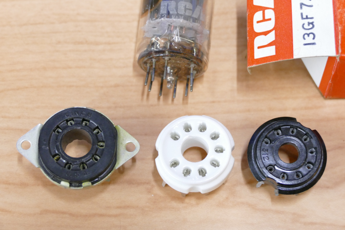

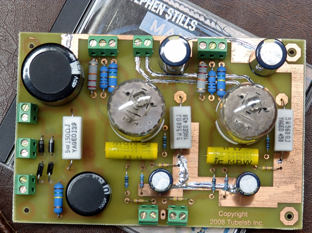

I need to socket a Novar tube PCB, but B9E sockets are rare and very pricey.
However B9D Magnoval is in production and available very cheap.
These two bases have identical circle diameters pin center to pin center of 17.45 mm.
But the pins diameters differ by about .26 mm. Novar are 1.02 and Magnoval is 1.27 mm.
I'm thinking I should be able to plug a Novar tube into a Magnoval socket, there should be enough closure in the springs to make contact no? its only .26 mm short.
As long as I never plug a Magnoval tube into it which would then stretch out the springs making the socket too loose for Novar.
For Novar tubes do fellow DIY'ers get good enough contact using the widely available B9D sockets?

Thank you sir! On epay they are going for 3 times this price.

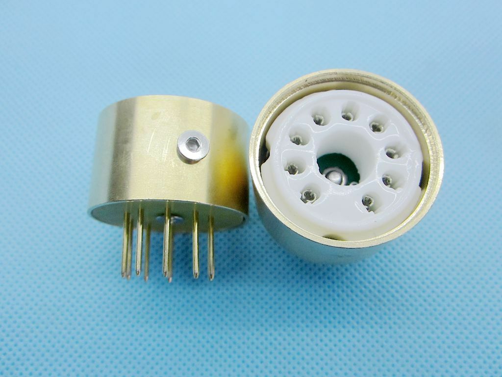

czhstore2013 lists some ceramic gold plated sockets on Ebay for Novar 7868, 6LQ6 and EL509. 2 FOR $10.
2PCS 9PIN CERAMIC TUBE SOCKET For EL509 7868 6LQ6 EL504 EL502 DIY Gold Plated | eBay
However, EL509 is Magnoval. I tried some, and the Novar tubes just fall out of the sockets. I was able to crunch the pins together with needle-nose pliers after removing the pins, re-assembling and then they work OK. But what a PITA!
ESRC had some Chinese Novar sockets that worked OK, I had bought some a while back. But I have no idea which supplier they got them from.
You can search Ebay for 7868 or 6LQ6 sockets, but most of them are going to be Chinese magnoval/novar(not!) sockets. Maybe someone has found a workable source?

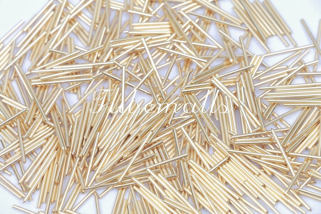

You can also buy individual socket pins for the Novar/Noval pins at Mouser. Keystone #1434 at Mouser I heard. If someone would make a small round PC board to mount them on, we could make our own (expensive) sockets. Male pins are available on Ebay, Tubemalls:
100Pieces Gold plated tube adapter pins DIY for 12AX7 12AU7 6BQ5 ECC88 EL84 6922 | eBay

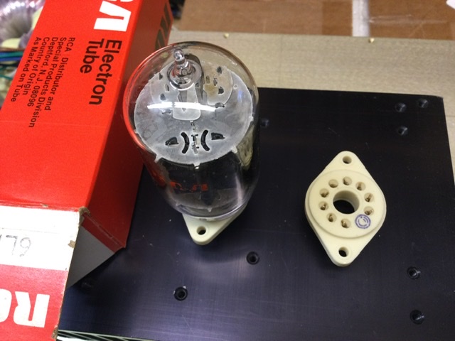

The ceramic ones I got from Tube Depot seem to be ‘ok’ with 6LR8’s in them. Not the tightest fit in the world but they don’t just fall out. Probably shouldn’t mount upside down or horizontally, though, if you’re using them on stage.

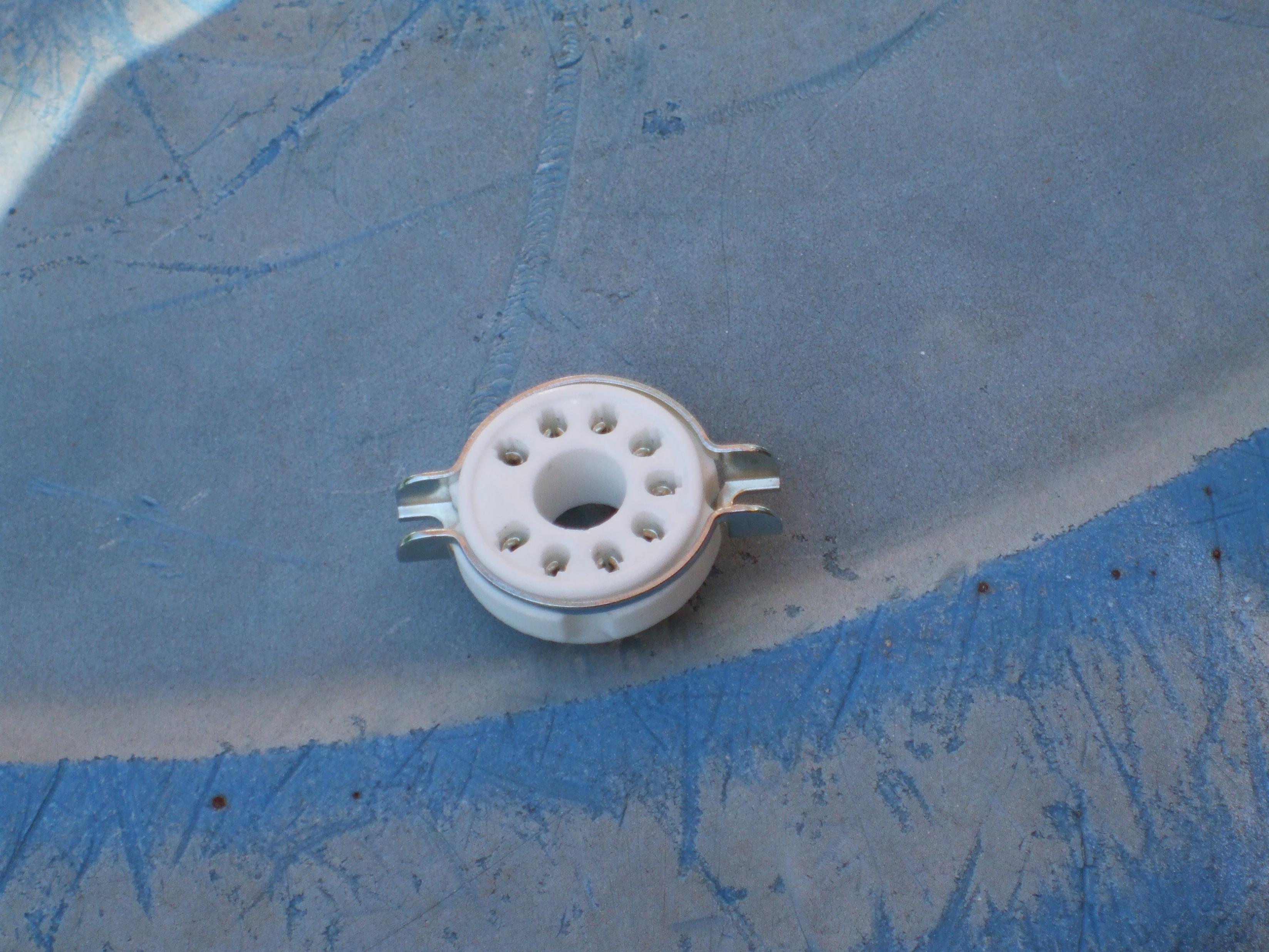

The "Novar" (Chinese, ceramic) sockets I got from ESRC years ago fit Novar tubes reasonably well also. But not firmly tight.
However, some further testing with a Noval pin found that about 1 in 3 sockets had a loose socket pin for Noval/Novar pins. So I always check those sockets meticulously for faults. They are fixable with a tiny screwdriver at least.
The source of "tight" Magnoval sockets that I just found look just like the ESRC sockets from back then. I will test them thoroughly when they arrive.

If one could use the Russian ceramic Magnoval sockets, do use them and leave the limited “real” Novar supply to folks who must use them. If you need Novars, look no further, or settle for “immitations” - get these from Radio Daze while they still have ‘em. I bought some from Radio Daze and I’m very happy with these Cinch “real NOS” Novar sockets.
A quick trip through my junk collection reveals two PC board sockets for the Novar, and one chassis mount. The middle one is the Chinese socket that I mentioned in the last post. It can be seen that the pin sockets have the least tension in them and the tube is fairly easy to put in and pull out compared to the other two.
I have no idea where the other sockets came from, but the chassis mount is marked "CINCH" and the other is marked 312 which is Sylvania's EIA code, so they were probably OEM made for use in a Sylvania TV set.

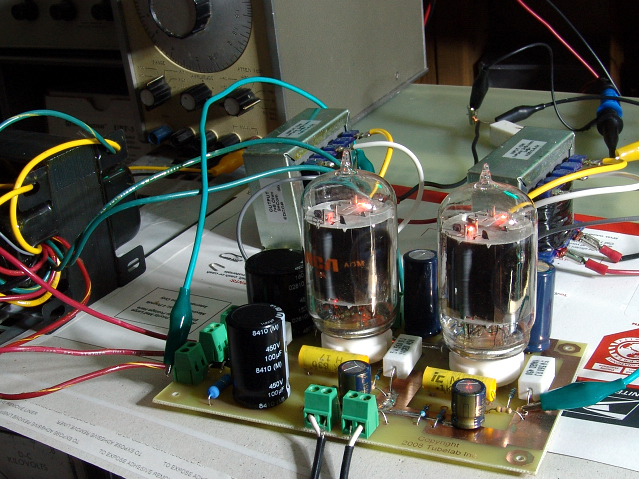

I'm only aware of 7868, 6LQ6/6JE6 and 6GT5 Novar tubes being used for audio in the past. So with the EH 7868 Magnoval version out now, the need for Novar sockets has probably evaporated.
But for DIY amps, there are lots of cap-less Novar Sweep tubes out there, suitable for modest power Amps: 12GT5, 17JT6, 22JR6, 22JG6, 17KV6, 6LR8, 6KY8, 6GF7

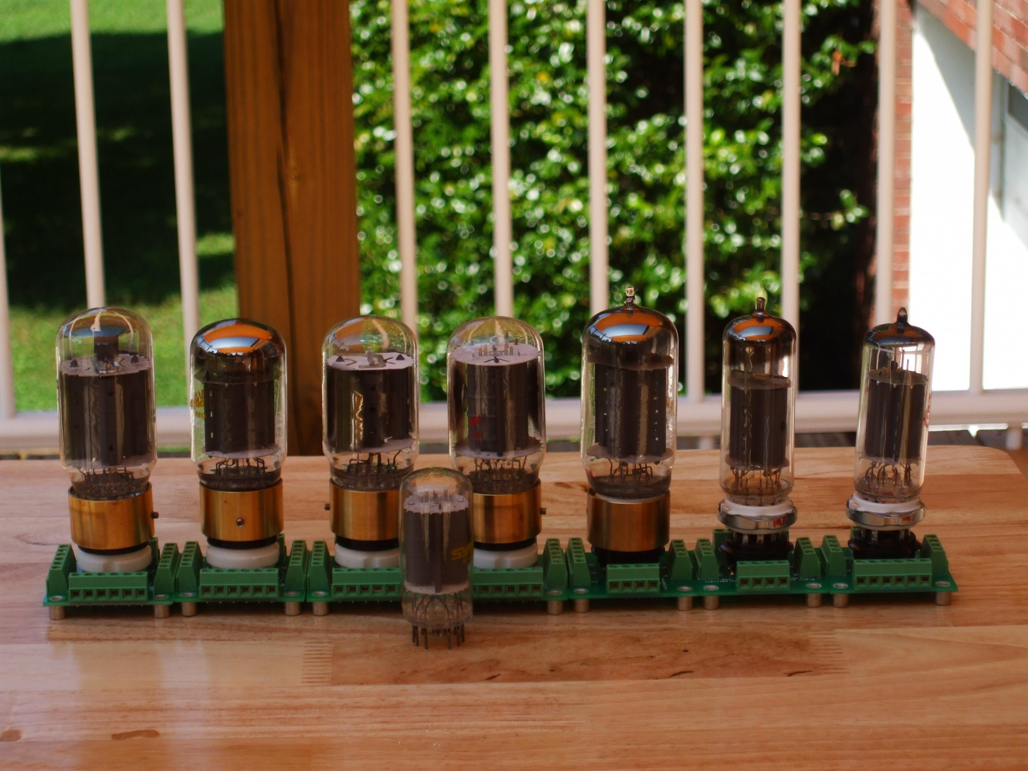

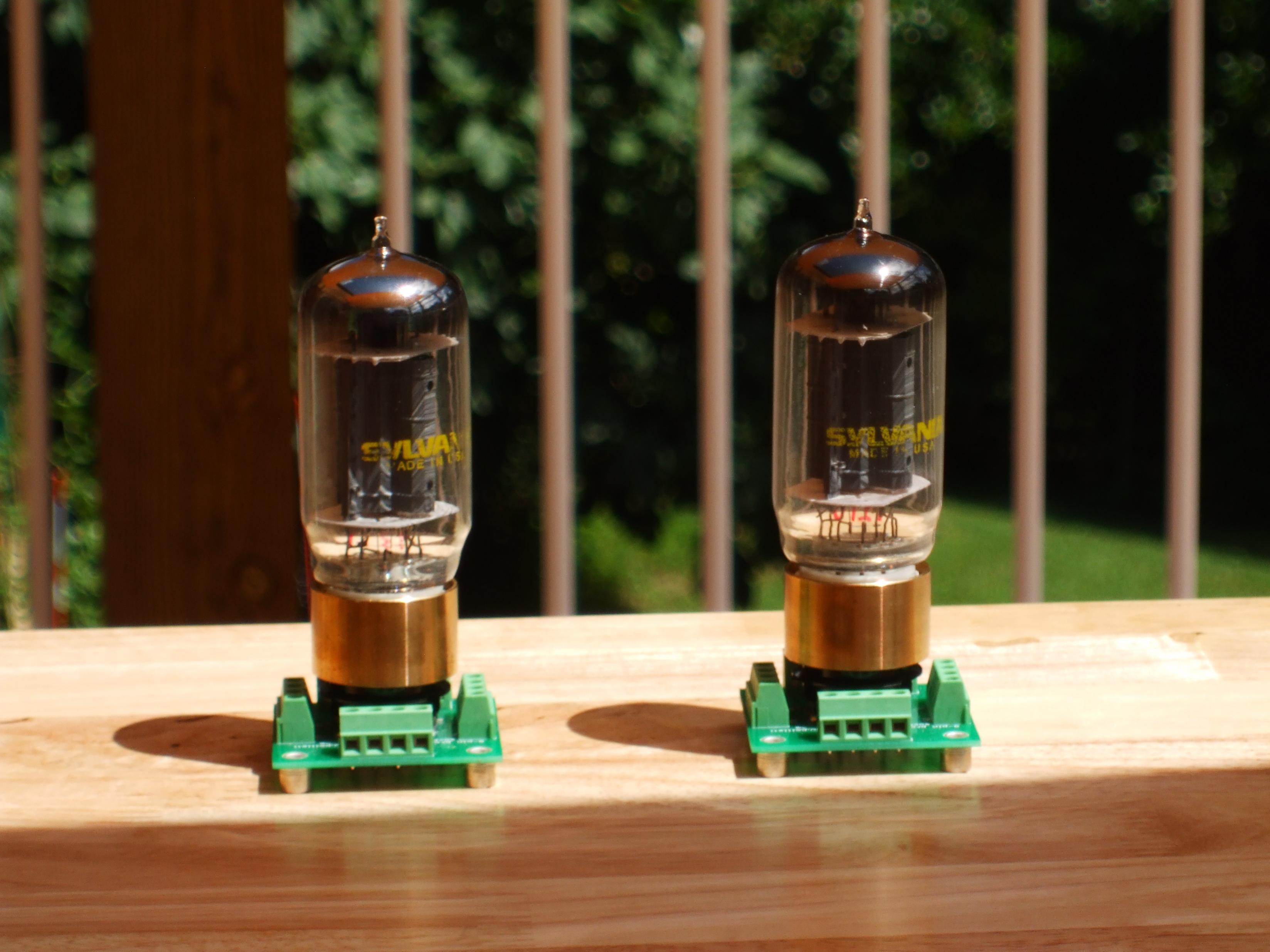

The Novar sockets I got from ESRC years back had a retainer ring included for chassis mounting. (1st pic) So you may have a bag of retainer rings in there somewhere.

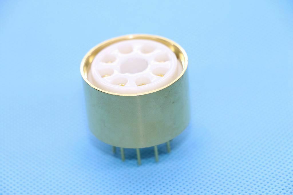

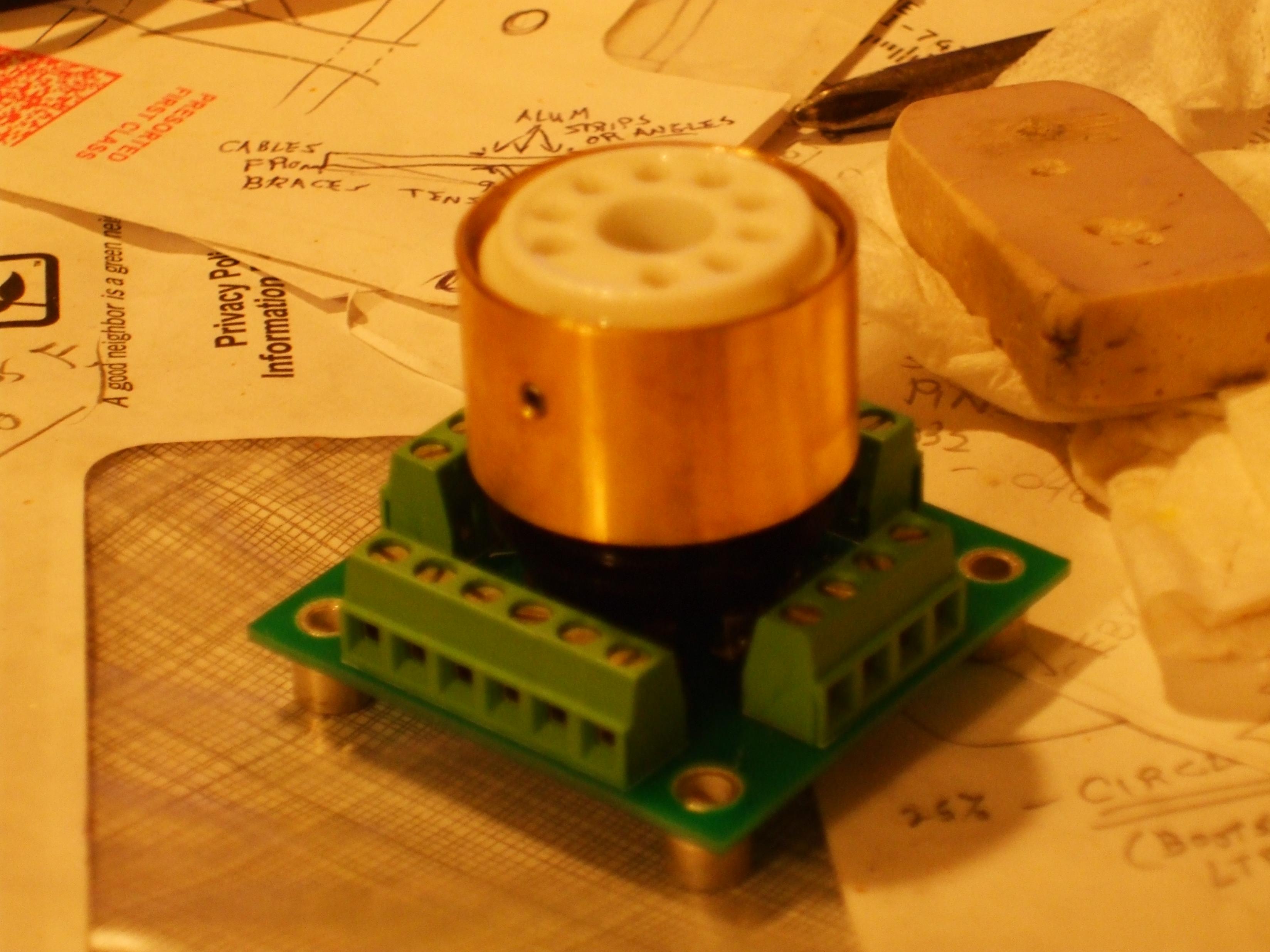

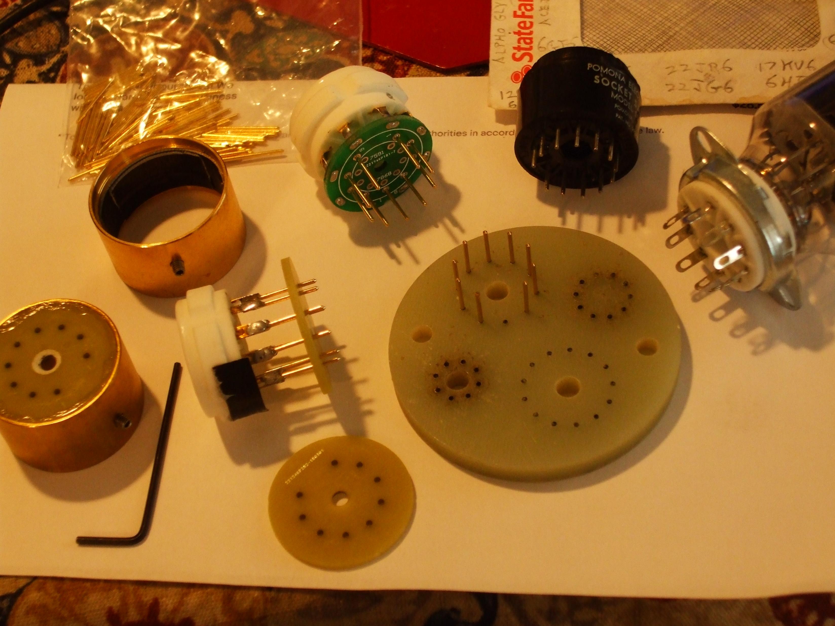

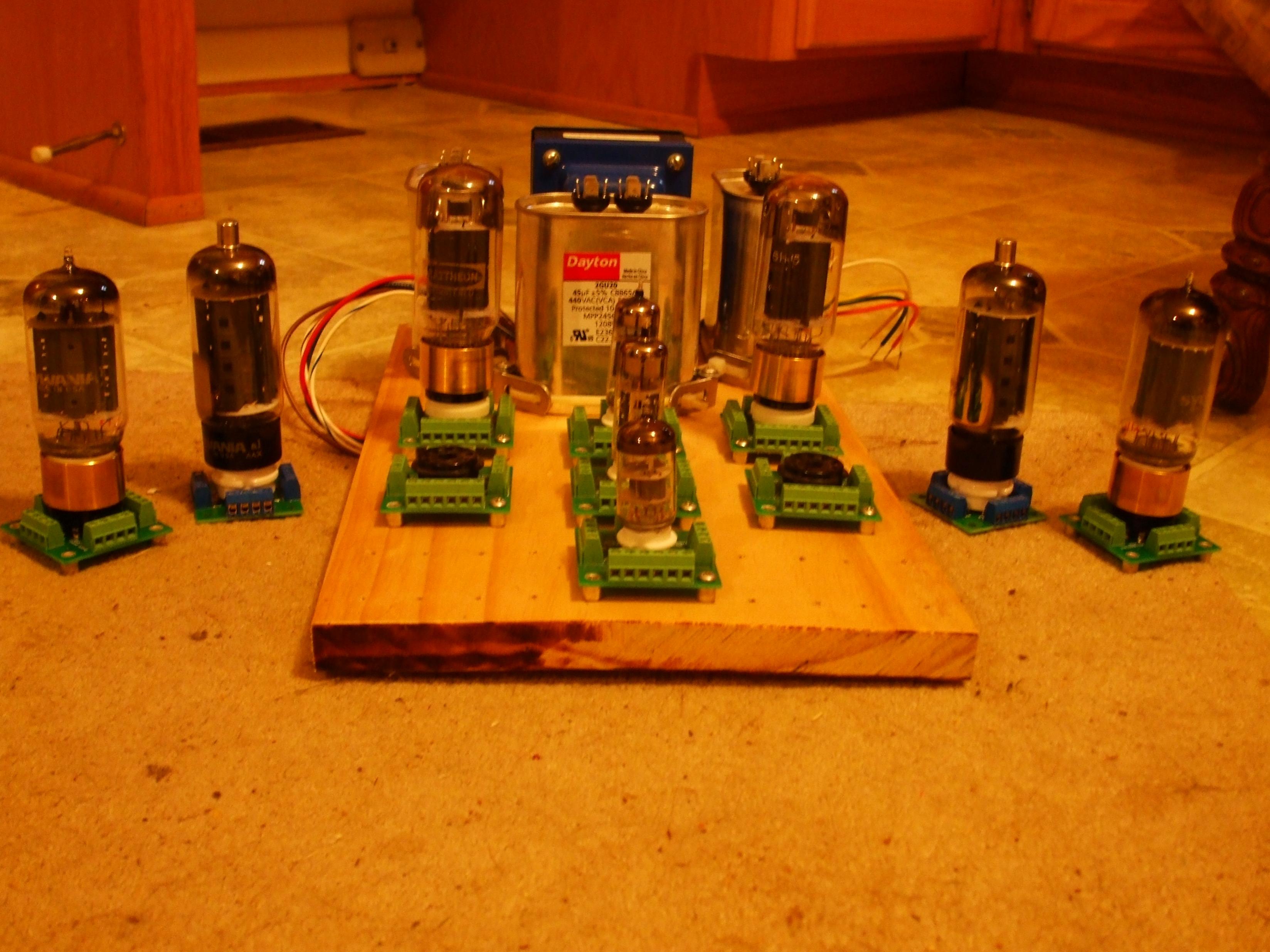

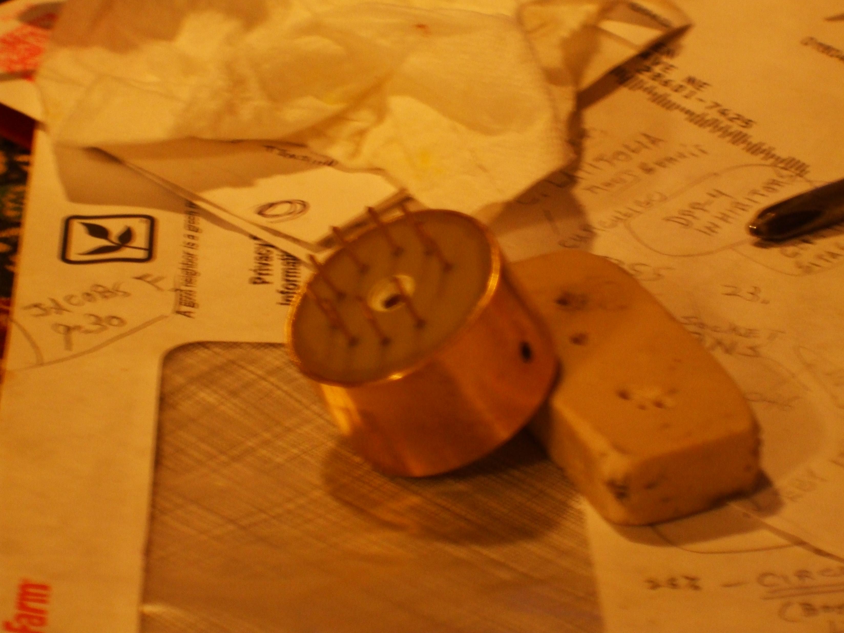

The first one I made (1st pic) was just for a Novar socket saver and possible bias current test adapter. I used a 7868 to 7591 adapter (2nd pic) to make it with a Novar socket up top and long pins (4th pic) soldered to it. I used a pin straightener (5th pic) (1/4 inch thick) to hold the pins in position. A tube in the socket keeps the pins aligned there while soldering the socket to the pin array. I Super glued the fiberglass disk to the "gold" ring on the bottom. A set screw holds the socket in place up top, but could be done better with a lathe to indent the ring better. Later I found there was already such a Novar socket saver product on Ebay (3rd pic).
I liked the look of just putting them on a Novar tube (looking like a fancy Octal tube). So I made some more. This way is expensive however. One could just use a 30 mm ID brass tube to make the rings. A lathe would be a big help, but a saw and file should work too.
I haven't seen any version on Ebay for Compactrons yet. I cheated on the Compactron versions here for the 6HJ5 by using a Pomona SS-12 socket saver inserted into the same gold (brass) ring and the set screw to hold it.

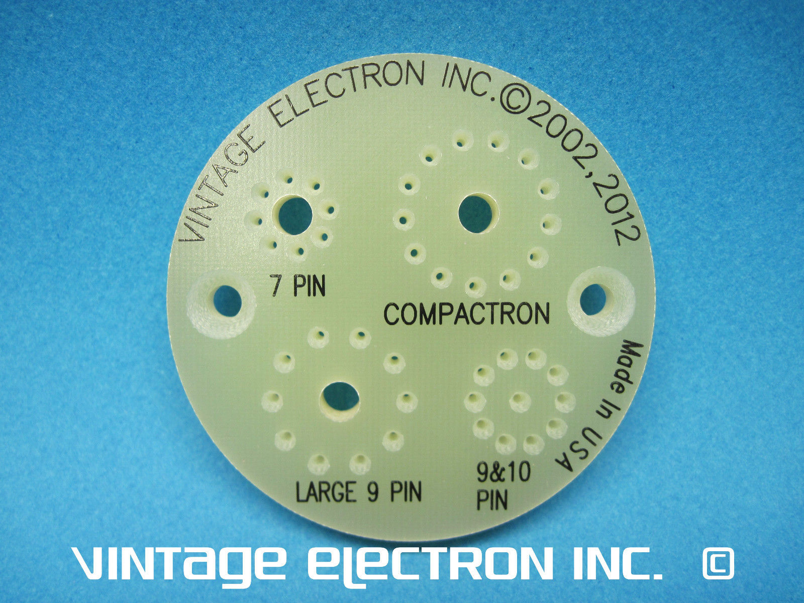

I plan to make some fiberglass/phenolic disks with 12 pin holes using the pin straightener for a pin hole drill guide. Then cut the fiberglass into a circle and file to fit the ring, or use a lathe to finish. Then just solder pins to a Compactron socket using the same technique with the pin straightener holding the pins.

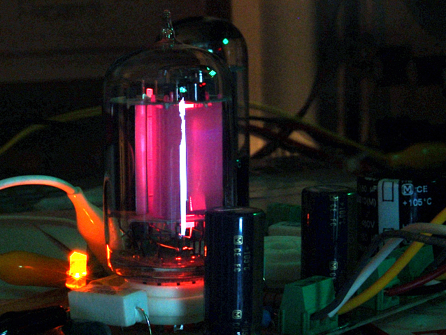

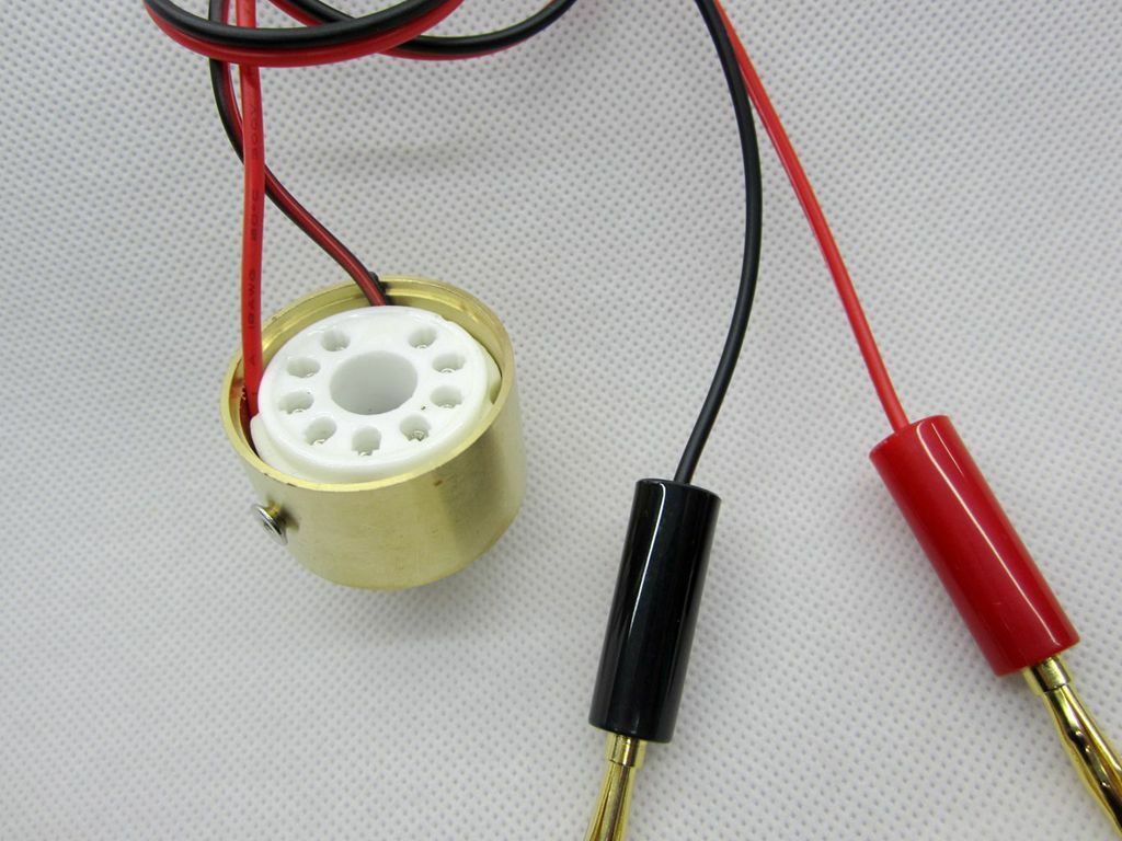

You can make bias current test adapters this way easily too. (6th pic) There already is one on Ebay for ( I assume still Novar)/7868.
1piece*Gold plated 7591(Adapter top) TO RCA 7868 tube converter adapter | eBay
1PC 9pin tube tester saver for 7868 6GT5 | eBay
1pc Gold plated Tube amp bias tester for 7868 Tube amp | eBay
