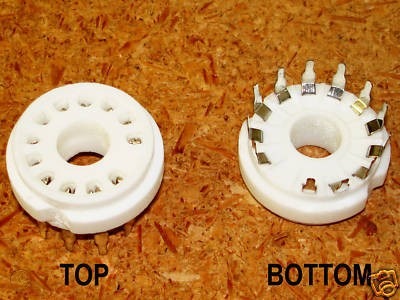

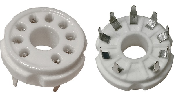

I'm not aware of any European tubes that used novar bases.
Over here (and USSR I think) we used magnoval. Same layout, slightly larger pins. I think I read somewhere the Russian 7868 reissue had the larger pins as well.
Current production Chinese sockets are somewhere in between: novar tubes fall out, magnovals go in only with a hammer. (no kidding!)
If the Chinese don't produce proper sockets, I'd say there is no market for them.
For EL50x experiments I have some salvaged magnoval sockets and for the 7868 tube that I want to try one time I'll just put some (Nixie) pin sleeves on a PCB.

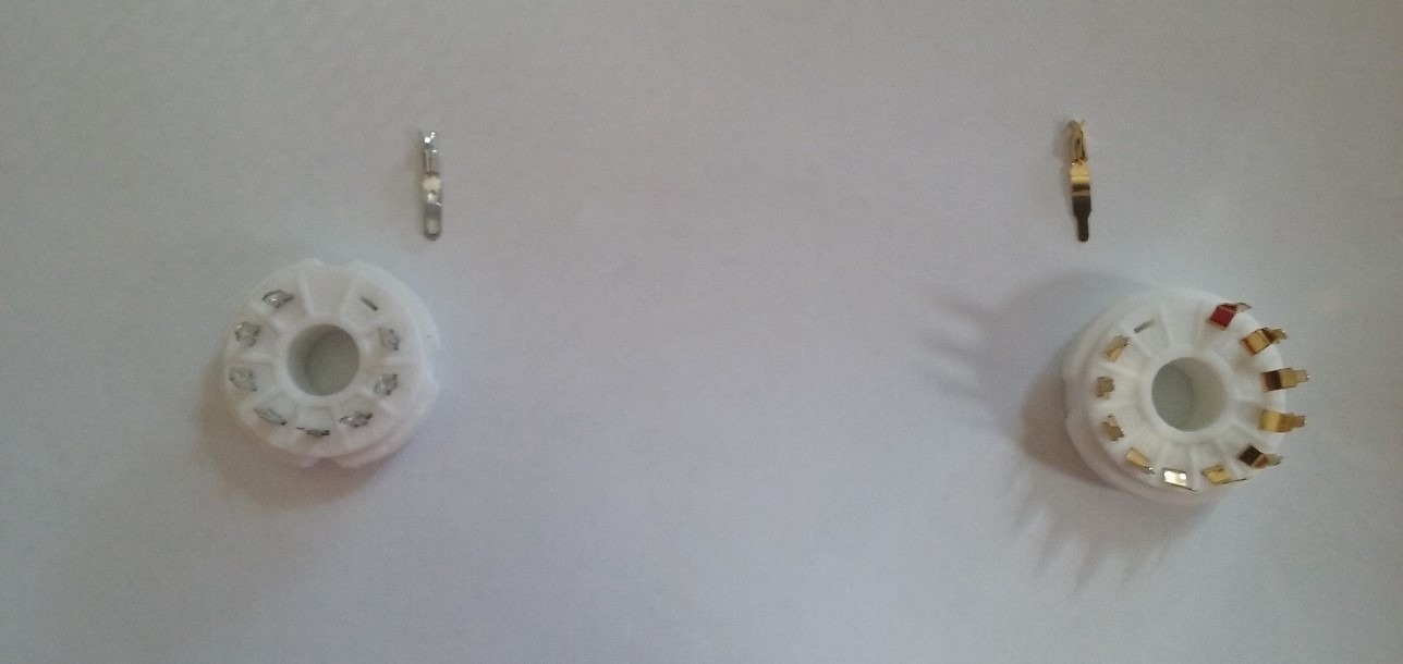

Got a batch of 12GT5 tubes for good price that will go towards pair of Frazier 106C mono's. Knew I'd have to come up w/ correct sockets (B9E's) before usage. Researched reasonable $ source- didn't find much.. ebay vendors taking advantage..Current production Chinese sockets are somewhere in between: novar tubes fall out, magnovals go in only with a hammer. (no kidding!)

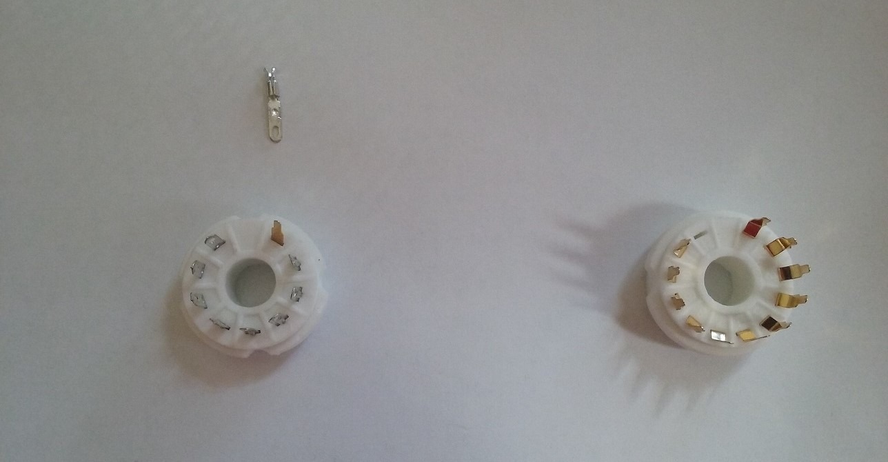

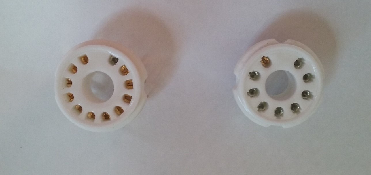

Undaunted- ordered some Magnovals (B9D's) for cheap:
https://www.tubesandmore.com/products/socket-9-pin-ceramic-magnoval-bottom-or-top-mount
But -GT's slip 'n slide in them, no tension whatsoever. Not "Tubes and More" 's fault- I recognized the design as ChiFi B9D's and had a back up plan...
Previously ordered two ChiFi compactron sockets of same ceramic base look as the B9D's, which were Chifi's also.
Then removed 1.0mm Compactron pins and successfully installed them in B9D bases, replacing their 1.2mm pins- proving that the ceramic molds are same at pin carve outs.
So easy enough, I thought... canvass some of my multi year contacts on AliExpress and propose the 'new' (old) Novar base, complete with directions and pic's of what I did to accomplish- not rocket science. I'm member in good standing on AliExpress, ordering much from them for my repair biz over the years...
But simple as this proven process seems to those contacted so far,,, it seems elusive... whiskey tango foxtrot??
Not giving up just yet, thx to posters here w/ info-
